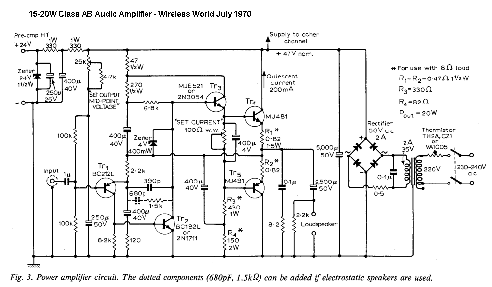

A point I forgot to make earlier is the need for an output zobel 8R and 100n as per the ClassAB circuit (Wireless World -June and July 1970).
Is this the drawing referred ?
Hi batteryman. Interesting, thank you. Is there a difference here between class-A and class-B? JLH revised the '69 version of the 10watt amp in the following year (1970) with a simplified PSU....i.e. no semiconductors. I think he only noted a slight increase in low frequency distortion. Later he advocated regulated PSU's for his bigger class-B MOSFet power amps and spoke of better bass and channel separation as I recall. Given that the current drawn by the class-A will be much less variable than the average Class-B amp have you experimented with different PSUs on different classes?

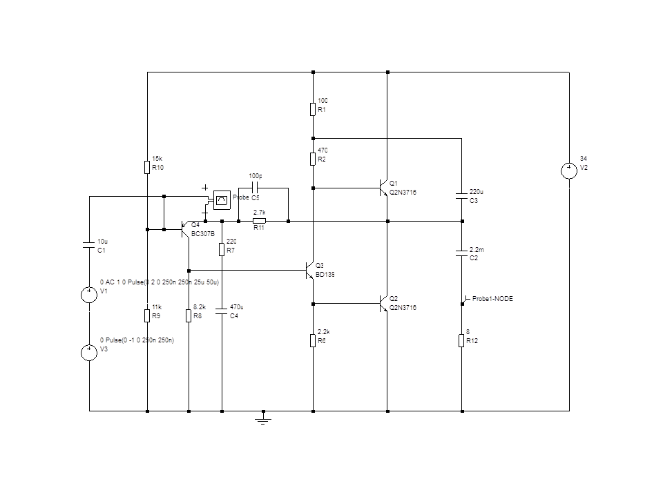

Hi all
Further simulations suggest that, as I had expected, a simple phase-compensation capacitor should provide a greater margin without the need for the base-to-ground RC network as mentioned in my earlier post.
Regarding the unity gain issue, a capacitor connected to the emitter of the input transistor leads to an effective emitter follower with unity gain at high frequencies. I should have added "until the rest of the circuit causes further fall-off". This means if you want to use the three-stage compensation suggested by Linsley Hood the additional roll-off capacitor on the base of the driver it will in principle reduce the gain earlier - but delays the phase unless a resistor limits the phase shift at higher frequencies.
I therefore suggest that a simple compensation capacitor could be used to limit the frequency response as shown in the attachment - if constructors need this.
Regarding the use of 30MHz output transistors they offer a lower distortion (better gain linearity) but as posted several entries ago I found that a 33pF capacitor was essential to stabilise the unit.

It is easy to get hooked on a single idea to enhance Hood's design by substituting the outputs for 30MHz power transistors. This has not come without some baggage.
I am suggesting a return to the basic design and try MJL21194 which is a nominal 4 MHz device - For data on this (and complement) see http://www.onsemi.com/pub_link/Collateral/MJL21193-D.PDF - SPICE models are available.
With unmatched devices it is claimed these complementary pairs have an open loop distortion figure of 0.8 % reduced to 0.08 % if pairs are matched. The 0.8 % holds up to 5kHz increasing to 0.95 % at 20 kHz.
I expect matching between NPN pairs ought to be better than between NPN and PNP complements and there are potential gains to be realised - since if an amplifier can be made more linear without feedback there is no need to push the envelope as hard in terms of frequency bandwidth.
Selecting Q3 for the highest gain is another consideration that impacts on distortion so there is scope to survey the field to see if there are better options. The BD139's I tested had less gain than 2N1711's. Some Motorola BC639's were better still - I still have 2N1711's with their metal cans. One could glue an aluminium tab to a BC639.
For completeness Hood subjected his amplifier designs to testing with an 8 R test resistor with parallel capacitors of various values with a 10 kHz square wave input signal.
I dislike the idea of the 100 pF capacitor in the feedback loop - at high frequency it will be a low impedance path for any intrusive signals to reach the inverting input.
If you run the simulation with the load mentioned I suspect you may find the need for an output zobel network and possibly an output coil to mitigate the risk.
One reason for wanting to use modern high performance output transistors is that their gain is generally higher and their gain linearity better than the older types, and the higher fT is almost a burden.
