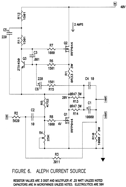

First I would like to mention, that one could achieve a wide spread of the ratios output/rail currents within class A topologies. A bright example of this - modulated Alef current source, proposed by Nelson Pass. Without modulation - we have situation of no signal current through the rail. By increasing the degree of modulation we move to more and more signal current through the rail. At this, efficiency is increasing, but sound quality is compromised (subjectively, since no spectra prove it). I guess, at JLH 1969 one also can adjust operation of the output stage, in order to vary the output/rail currents ratio.

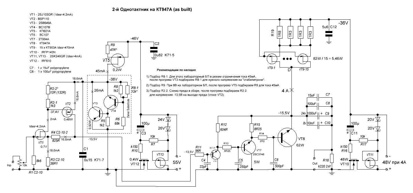

As for my personal preferences, after dozens of designs I stay with this topology nowadays (excuse for non-english notions, I could re-draw it if interesting). Output stage is made with VHF power bipolar transistors (300W transistor at the output). This schematics works with PMC EB1i speakers (3,5 Ohms impedance), therefore standing current is high. Power supply is in external cabinet, amp itself is big and heavy.
Also I would like to add, that caps participate in the signal chain in any case, absence of o/p caps leads a person to false conclusion, that sound comes from schematics itself. No-no, the same measures must be applied to the rail caps, absolutely similarly as to o/p caps.

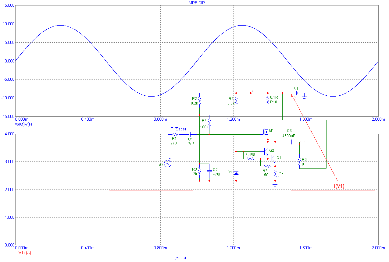

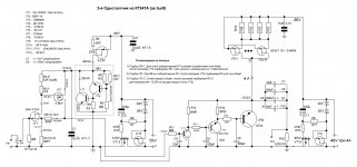

There is one exception, when the current supplied by PSU to class A SE amplifier is almost constant. Please see the attached image. Bottom Darlington is a CCS, MOSFET is an amplifying device and load is connected to +Vs (not to GND). Then, a sum of load signal current + MOSFET current is almost constant and equals to the CCS current.

As for my personal preferences, after dozens of designs I stay with this topology nowadays ....
This deserves a separate thread - would love to hear your reasons for choosing the various design elements and parts (PM me instead if you prefer).

Gareth, I think I'll open a new thread about this amp. Some time ago I intended to do this, but what has stopped me - special russian transistors were used, so difficult to discuss with diy members. But, now I know, that good substitutes from Motorola are available. VHF power bjts are good due to the low base region resistance and interelectrode capacitances. In spite that one has to use some external resistors and caps, in order to prevent self-oscillations, these external parts are not voltage dependent and are linear. Final sound is felt like more effortless, more "big", more articulated. Especially difference is heared compared to MOSFET output stages. The bandwidth, as in all my amps, is in MHz range. Total value of output caps exceeds 0,1F. Low value of the input (greed-leak) resistor - for allowing bigger input currents, this decreases possible effects of electro-magnetic interactions and effects of wire insulation, effects of imperfect connector contacs. I would use even lower value of the volume pot (3...5kOhms) if would available.

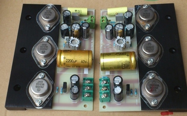

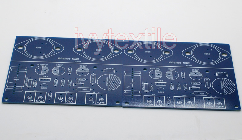

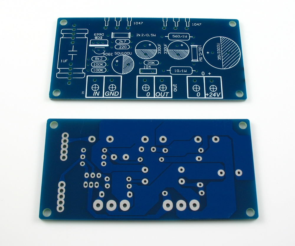

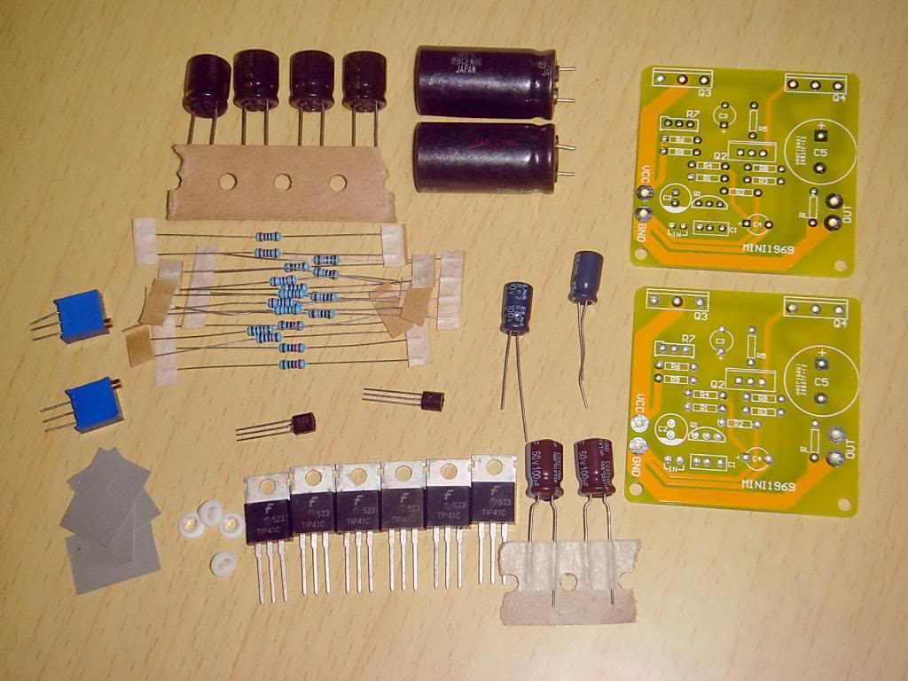

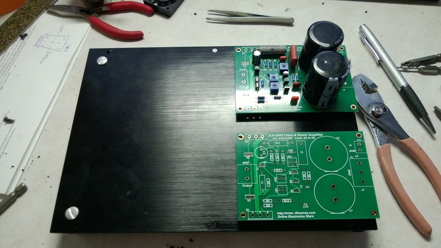

I just went 20 pages back to see if there were any recent recommendations on kits. Here are some of the PCBs
MKHunt using the silliconray ones
Rixsta using JLH 1969 Mini Amplifier by "La Mer"
Probably too low power ...
Ebay #1
Ebay #2
Ebay #3
Which one would you recommend and why?
Thanks,
Jeff
Ebay #1
Ebay #2
Ebay #3
Thanks,
Jeff
Honestly I would avoid the 69 design. It's simple but it just doesn't perform very well. I have a silicon ray version I am working currently using an SMPS.
What rail voltage, bias and devices did you use?
PMA seems quite taken with the original and has some nice testing to back it up. Hugh likes it too!
Thanks,
Jeff
The item with the TO-3 transistors nicely bolted to a metal plate looks nice to me. Why ? - if they come ready mounted that will save you some work. Also the TO-3 packages make for good thermal contact with heatsinks and they have that retro-look.
Thje original '69 is the famous version, you'd be second guessing yourself if you build something different without first building this one.
I don't think single rail is an issue but be prepared to upgrade the output capacitor for best quality.
- JLH 10 Watt class A amplifier
