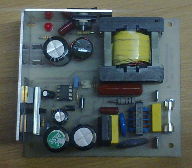

my partner at ZUS Audio Inc done just that using two Meanwell smps. The two clock frequencies where not the same by only a few kHz.
When he made some measurements with his picoscope he found that the two clocks cause a number of mixed frequencies all around 80kHz all the way down to 20 kHz. Although he claimed it was not audible you do not know what is present across the tweeter.
Thing is what you might not hear may still be presented to your tweeter.
I have in the meantime made him a very simple half bridge +25 - 0 - -25V @ 5 A smps that works fine provided that the zobel networks are properly chosen to critically damp the switching pulse overshoot thereby reducing the HF noise.
The supply is unregulated but a class A amp presents a constant current load and it worked well.
The SMPS is an adaptation of TI's apnote.

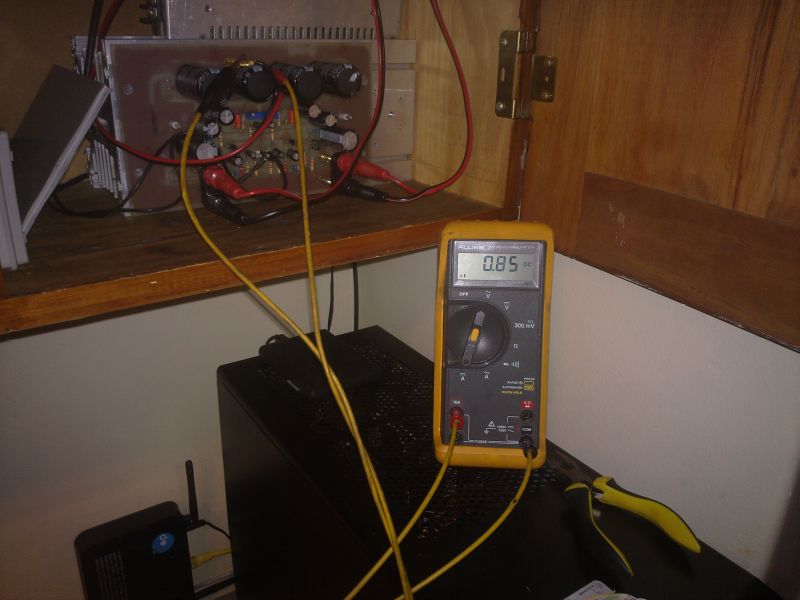

No.............. a class A amp presents a constant current load .........
Most ClassA amplifiers do NOT draw constant current from the supply rails.
Andrew you are right not all class A behaves like this. You can see the current changing if you put a shunt in series with the amp and look at the volt-drop with a scope. A meter averages the current and you see a constant current load. But the change in current is not as drastic as one would expect. From the signal passing through zero to maximum (10V) the current changes by 450 mA but not as much as one would expect. This is true for JLH. However, the single ended class A with CCS remains constant as the current is shared between the speaker and the active element while the current source holds stable.No.
I did not buy Meanwell, the two I bought are double insulated SMPS. Once the amp is completed I will report back. I hope there is no oscillation. This is what I bought ;

Nico, your analysis is wrong.
Very few ClassA topologies draw constant current.
The very few that do draw constant current are rarely implemented.
That leaves the vast majority of ClassA amplifiers do not draw constant current.
The F5x is a constant current ClassA amplifier up to nearly the ClassA current limit.
A single ended, CCS loaded, single polarity, ClassA amplifier that has the Load returned to the supply rail instead of to the ground rail is also constant current ClassA up to the ClassA current limit.

AndrewT,
Kindly explain this phenomenon: Music is playing (I cannot prove it though) - this is a JLH from 1969 (what is being discussed here). It is driven by a Meanwel SMPS, the ripple voltage is less than 10mV. The measurement is of supply current shown is both Amp DC and Amp AC. If the supply current was not constant it should register on AC but it does not. However, a constant DC current is present. My statement supporting your view above was incorrect, what I saw on the scope was hash.
go back to your scope and measure the voltage variations on the supply rails.
That voltage variation is due to the supply tail current times the supply impedance, causing a voltage drop.
That voltage drop (the variation from the maximum at zero output current) is there because the current is varying.
