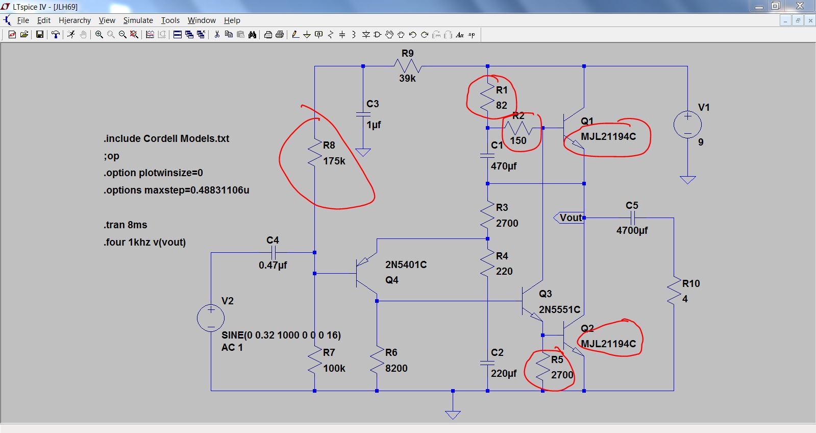

Thanks - I have had a play with larger R values without any adverse effect. Good to know.
In the original article, altering (raising) R1 and R2 will lower the quiescent current.
Got it - ta.

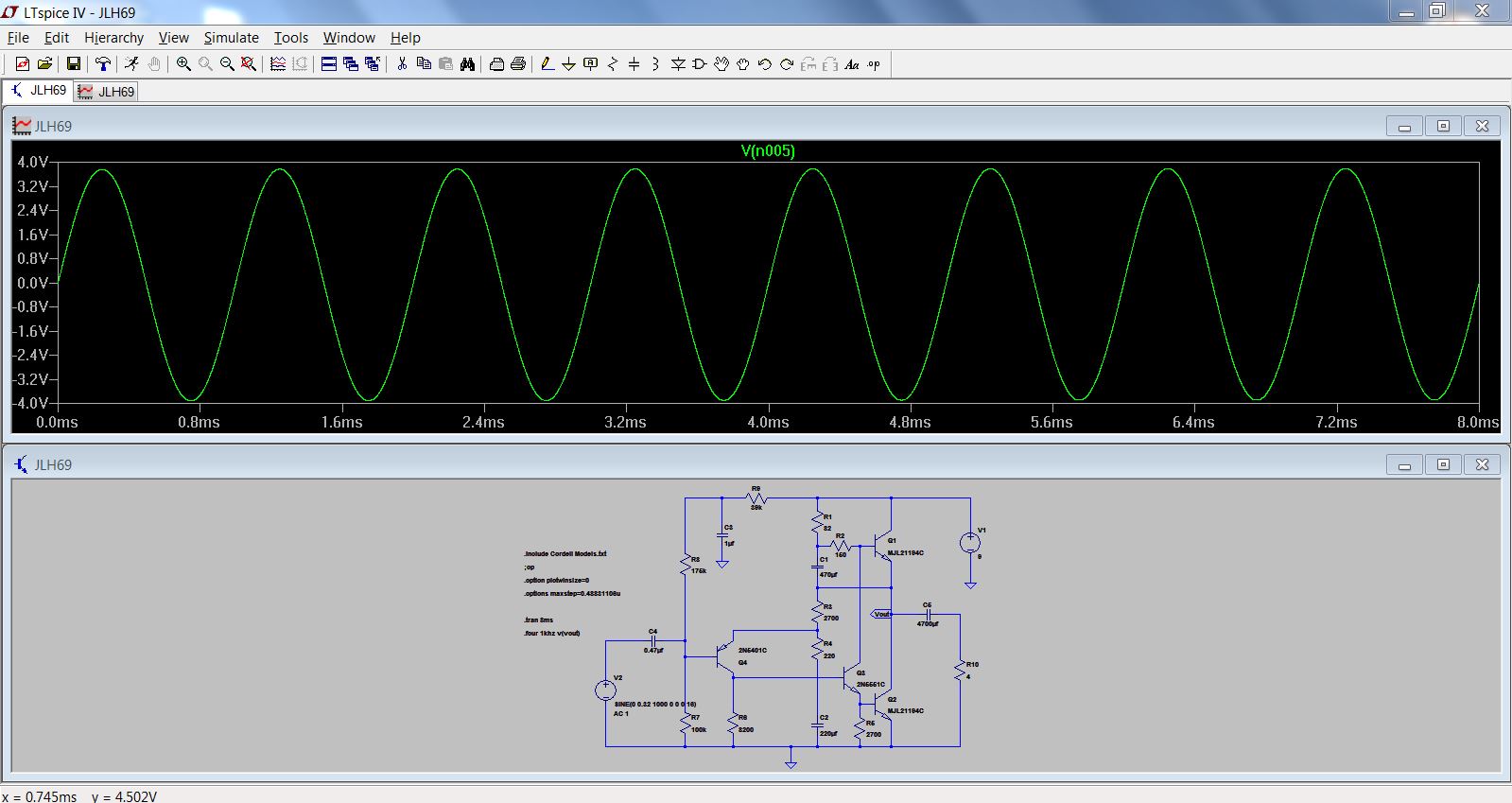

To arrive at some values for these resistors we need to know your actual supply voltage.
5V supply gives an output of +/-2V PP into a 4 Ohm speaker
9V supply gives an output of +/-3V PP into a 4 Ohm speaker
15V supply gives an output of +/-6V PP into a 4 Ohm speaker
…or do I need to calculate/supply the current draw at each of those supply's as well?
Thanks.
I think you might find the loudspeaker power equation useful: P = (Vpp)^2 / 8 RL.
So your 1st case of +\- 2V PP into 4 ohms becomes: P = 4^2 / (8 x 4) = 16 / 32 = 0.5W (assuming +\-2V PP means 4Vpp).
Similarly at 15v you get +\-6V PP giving P = 12^2 / (8 x 4) = 4.5W - that is 3 times the voltage (and 3 times the current) gives 9 times the power as expected.
If nothing else it confirms your readings as correct.

Well you need to determine what you are aiming for. On 9 volts (in simulation) I can get almost (unbelievably) 8 volts pk/pk into 4 ohms.
8Vpp into 4r0 is 2W where P = V²/R & V= Vpp/2/sqrt(2).
A reactive 4ohm speaker could easily draw 1.5Apk and sometimes as much as 3Apk.

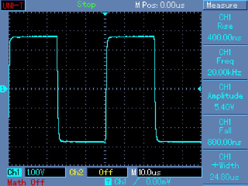

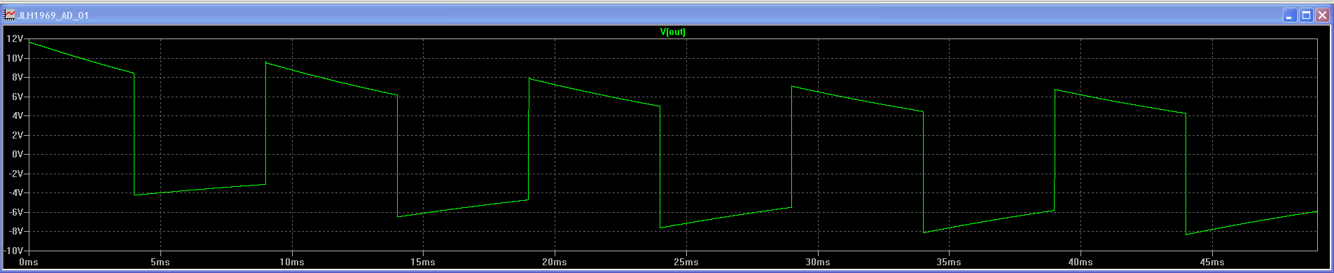

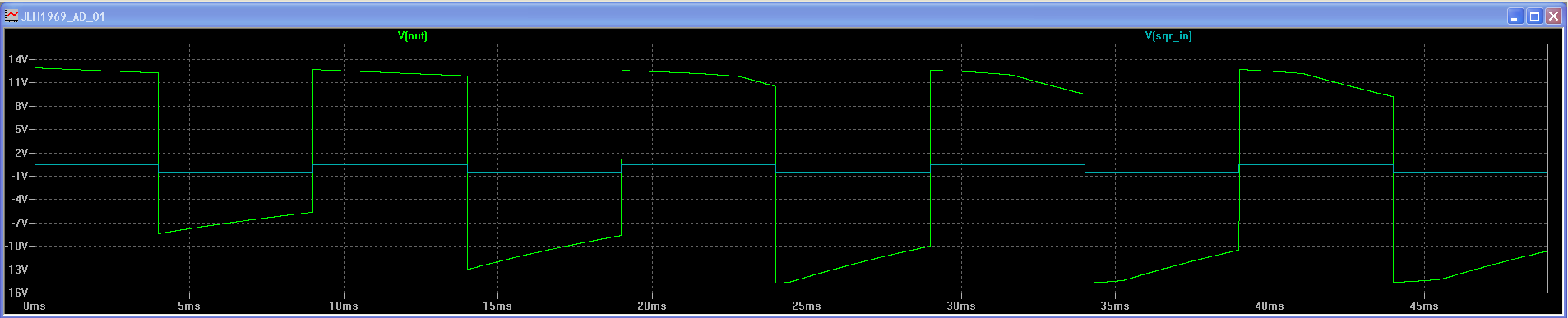

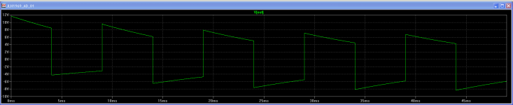

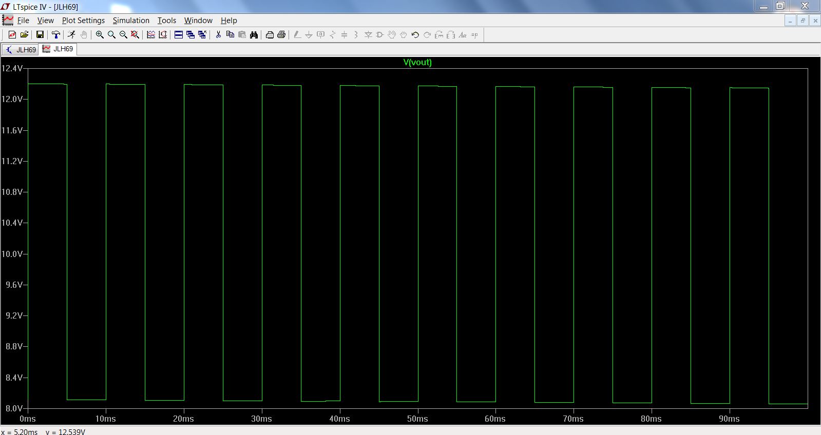

The attached screenshot shows an input of a 1V PP 100Hz square wave into the JLH69 config (with a bit more gain). It reproduces a 1V PP sine wave input very well.
My understanding is that this square wave 'ramping' is caused by the output AC coupling? I've tried some very big caps on the output (up to 10,000uF) and it doesn't seem to make a huge amount of difference.
So - a) is this a problem that needs to be solved or (can be) improved and b) if so - how do I approach that?

What supply voltage are you running it at. It looks like its hard clipping at the top and then the trace falls as the caps charge.
27V as per the JLH69. Yes, it was letting the sine wave through but it's clipping the square wave. Even if I drop R3 (on the original schem) back to 2.7K - it gets rid of the clipping but the 'ramping' is still there - same on the 5V version I'm working on as well.
This is LF roll-off.

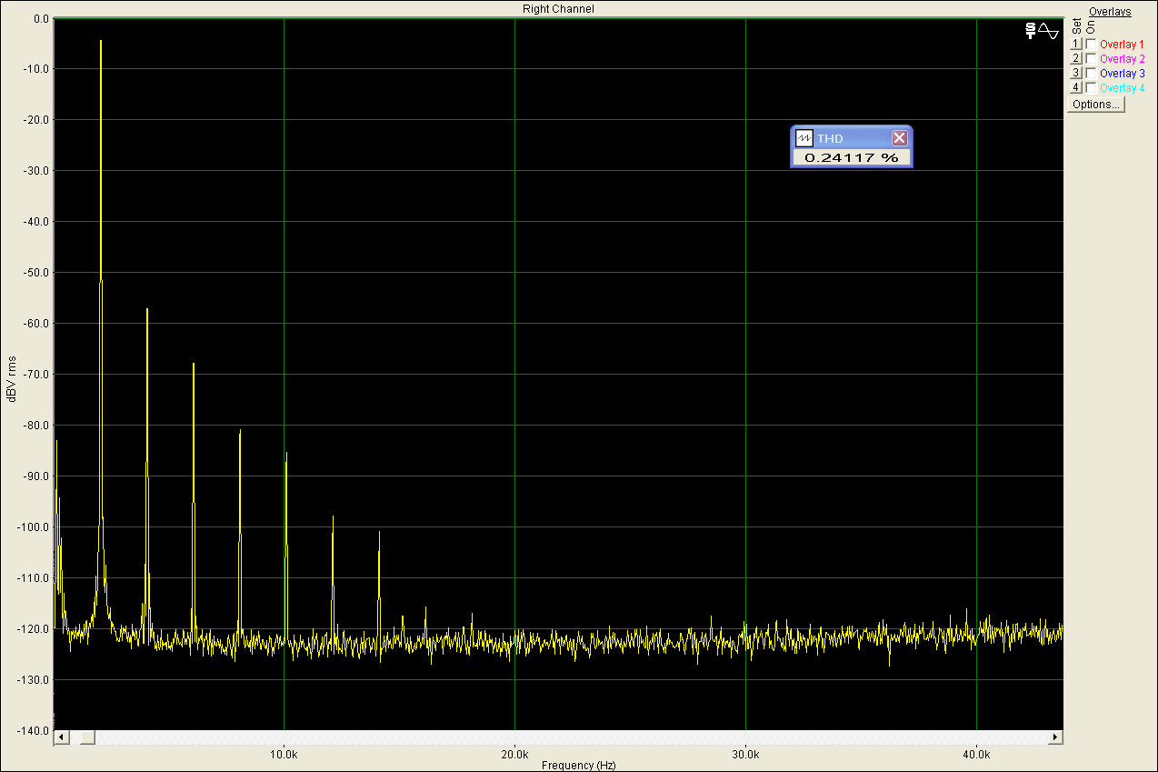

Very nice - classic single ended distortion profile. I must get my own wired up one of these days.
Yes- all caps. In post #2884 Mooly shows a circuit of the JLH. In that circuit, C1 (bootstrap); C2 (feedback decoupler) are likely candidates needing to be increased, the input capacitor is next in line as well as the output capacitor. If your output cap did not make much difference try the others.
The input capacitor should, in my somewhat biased opinion, always set the LF filter (high pass).
The other capacitors should then be selected to PASS that LF that the builder designed into the chosen LF bandwidth.

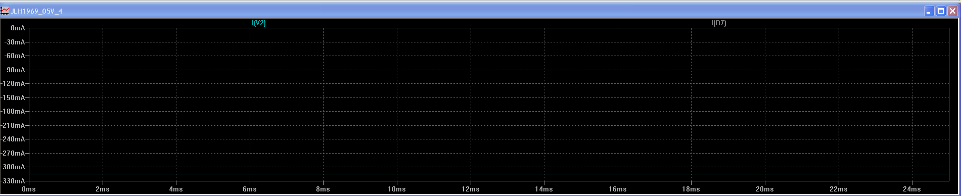

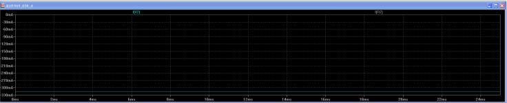

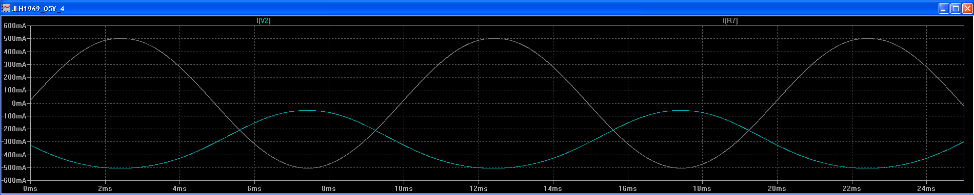

I have question about measuring the current draw on this amp (JLH '69).
I understand that on a Class A topology the current draw varies with signal output and I can verify that in simulation - but I'm trying to get either an 'average' or 'peak' rating in mA based on a given input (1V PP Sine).
My aim is to start with building a low power (5V supply), low wattage (1/2 Watt), version to run off a wall wart - but I need to know approx. how much current the wart will need to supply.
The attached sims show:
With input:
I[V2] - Current across 5V power supply = -510mA to +56mA
I[R7] - Current across 4R speaker = -510mA to +500mA
With no input:
I[V2] - Approx. -315mA
I[R7] - Approx. 0mA
I'd appreciate any advice on this.

You say you have little experience so please excuse me if try to clarify a few things.

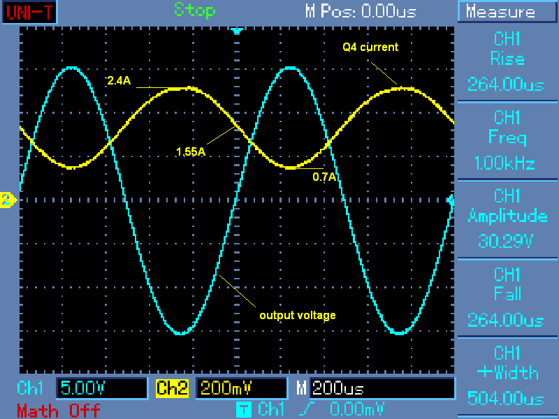

Actually in class A amps the current from the power supply varies substantially less with the signal than in class AB designs.
PMA's scope shot, I think, shows the current variation in the lower o/p transistor which is pretty much the inverse of the change in the o/p current but the change of the actual power supply current will be substantially less than this.
In theory it is possible that the supply current in class A amps does not change at all when a signal is applied but in practice it will usually change to some extent and in this design the action of the bootstrap capacitor does create some useful o/p current change with signal. ( in the upper o/p transistor ).

In addition there is at least one more good reason to have a high standing current in the o/p stage of this amp design.
At some points of a real loudspeaker's motion with real music signals there can be quite substantial dips in loudspeaker impedance. At these times the amplifier will need to supply extra current to "control" the speaker cone movement.
With this design the current available to the loudspeaker is limited to just over 2 x times the standing current. In amplifiers with follower o/p stages this restriction is not present.
With larger speakers this may sound as if the amp does not have much of a "grip" over the speaker.
If you experiment with lower standing currents initially - you may find that the amp will be happier with smaller or more efficient speakers.
