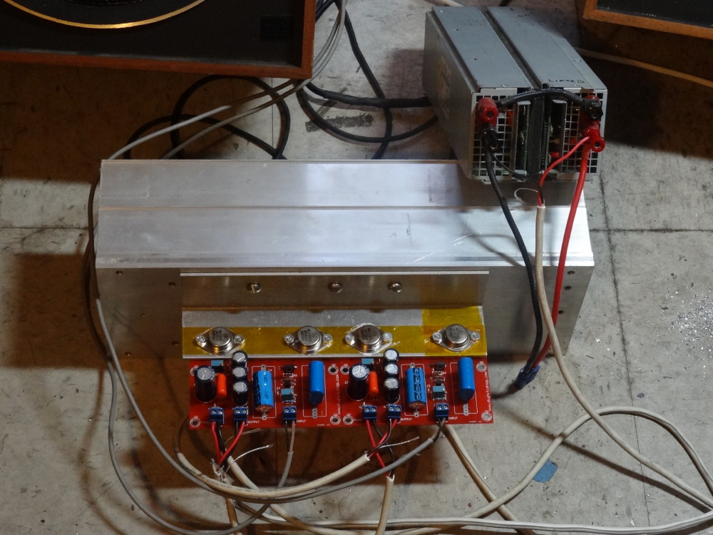

I already pulled it apart a year ago, it was a JLH 69 kit off ebay. I think my rails were arround 25-28V. The amp wasn't terrible but compared to my pass zen v1 it lost out. I might even have the boards arround somewhere if you want me to look for them.
Assesears AFAIK the dual rail version is the 96 revision.
I have to say that when I first finished my JLH 1969 I was a little disappointed. Mine is powered by a 25V 42A Server power supply. I threw it on the shelf for a while. Then after I built an A/B setup I started going through all my amps and when I got back to the JLH I was quite surprised to find that I really like it. I has a nice full bodied sound with sweet highs and tight bass. I was also surprised how loud 10W can get. Mine is nothing fancy. Built on the Jim's Audio boards. I did substitute MJ15003 for the 3055.
