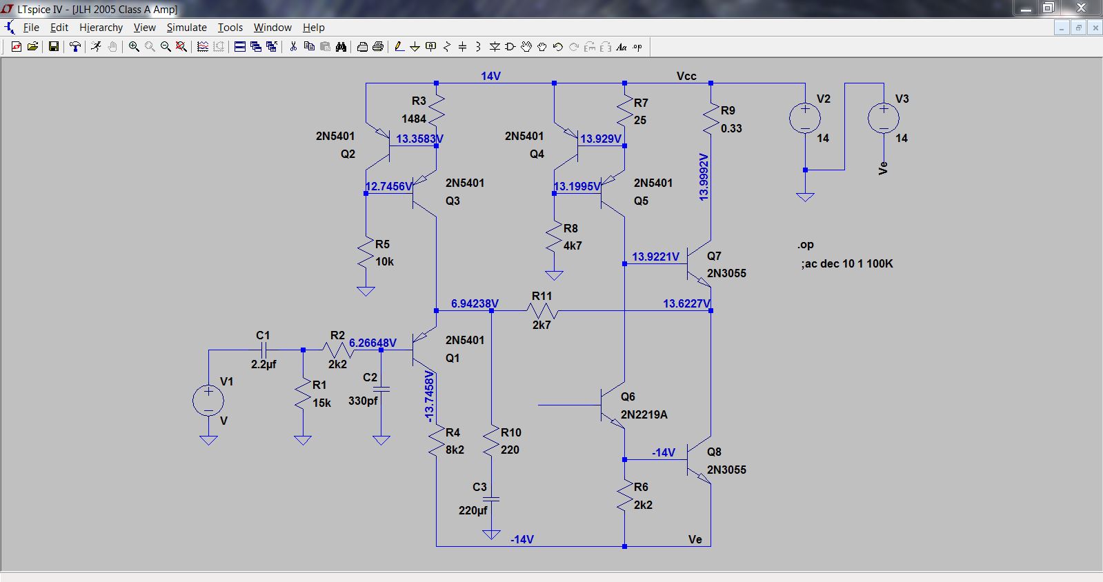

For testing don't have any load connected. Its to risky both for the load and the output transistors.

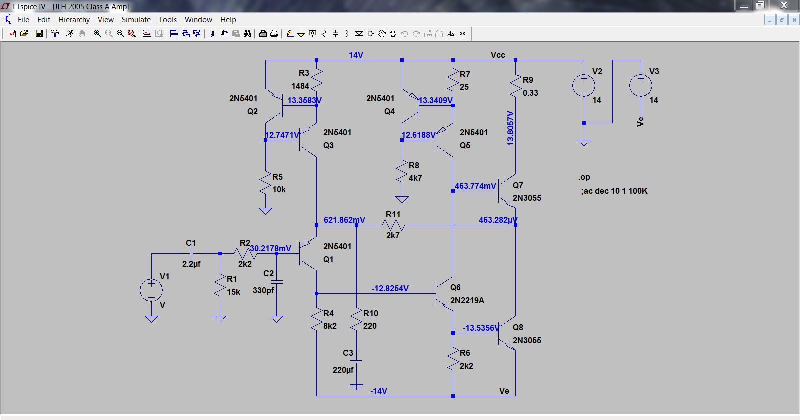

Yes, in normal operation there will be around 1.3 volts across R5. That's a non varying value and determined by the two B-E volts drops of Q3 and Q1 added together.
You can simulate it 🙂 Here is the file that will run straight off in LTSpice. No extra models needed.
These two images show the normal voltages and the voltages when Q3 base was open.
The component refs in the sim are different to your picture

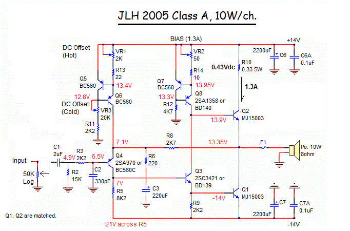

Help please.
Well, you guessed it I'm back with some more issues with the second channel 😀
I have attached the schematics with the DC voltage shown in red, these are referenced to gnd.
Q1, Q3 both have Vbe of 0V even though I just changed them.
Q7 is kinda odd with a Vbe of about 0.18 and it varies based on the value of VR2.
You want to laugh ? Have a look at the Vb of Q4, a whopping 6.4V...while input is tied to gnd. To top it off a nice 21V across R5 🙂
If you have any idea what's happening please share your knowledge.
Thanks a lot,
Eric

BOTH channels fixed !
Well Mooly was right on once again. The problem was Q3..transistor was fine but the PCB trace between Q3 base and Q4 collector was broken therefore open circuit 😀 By looking at it the trace and solders looked fine.
Both channel now have nearly zero DC offset and are biasing nicely and stable at 1.3A/ch.
Thanks a million guys !

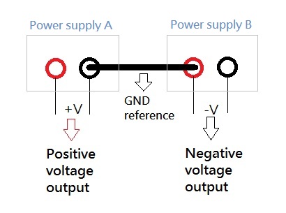

It's working OK but I have the following potential issue I'd like to fix.
I'm using 2 power supply (switching) each rated with a single 14V, 3.8A output. These PS each have floating output so with 2 of them I'm able to create the required +/-14Vdc, 3.8A for my stereo set-up.
One of the SMPS (laptop type, brick style) is heating up uncomfortably while the second one is only warm.
Is there a way to share the load equally between my 2 power supply
so 1 of them doesn't stop working prematurely ?
If that doesn't work, where can I buy a +/- 15Vdc, 120-150W power supply.
Thanks,
Eric
This is what I did for the power supply connection.
As an example, load sharing is done via the use of emitter resistors on output device in a power amp, how about power supply, can this be done ?
Thanks,
Eric
