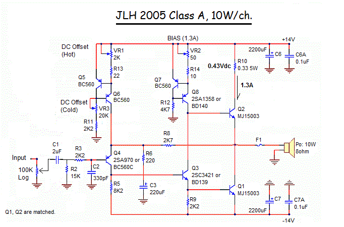

The - pin is not connected to earth ground. I actually do not have any earth ground on the amp, both power supply are double insulated (2 prong inlet)
What I noticed in that it's the PS feeding the positive rail that heats up the most.
From the beginning I noticed that the upper output transistors (Q2), the one connected to the positive rail heats up more than Q1 which is connected to the negative rail. Is this something common with the JLH amp ? So it seems that Q2 is drawing more current which explain why its heating more and the positive rail power supply is over heating...(plastic case about 50C)
Question is, why is Q2 drawing more power vs Q1 ? My MJ15003 are matched (hfe).
Thanks guys.

A couple of things to check.
1) The only way the output transistors can draw unequal current is if there is a DC offset at the output (and there is a load connected). So make sure the voltage at the speaker terminals is below around -/+100mv. Also measure the rail voltages accurately. If one were +16 volts for example and the other -13 volts then assuming say 1.5 amps flowing the upper transistor would dissipate 24 watts and the lower one just 19.5 watts. Maybe enough to "feel" different.
2) Are the PSU's of identical types ? Have you tried swapping them around to see if the heating follows the PSU.
or some kind of a.c. flow through the +ve rail, upper device and to ground via capacitors - wonder if something weird going on with the SMPS at high frequencies ?
This is why I suggest swapping the PSU's over to see if the problem is consistent or not. Laptop type PSU's vary in how hot they get, I have an old Acer that runs pretty hot, while a Dell one runs almost cold. That is why I wondered if they were both identical types.
Both power supply are identical, same model no. same manufacturer. Each of these are rated up to 3.8A and I'm running them at 2.6A
This morning I have swapped both supply and the power supply that was running warm is still running warm (now feeding the - rail) so the issue is not the positive rail or Q2 drawing more current. 1 of the 2 power supply has an issue.
