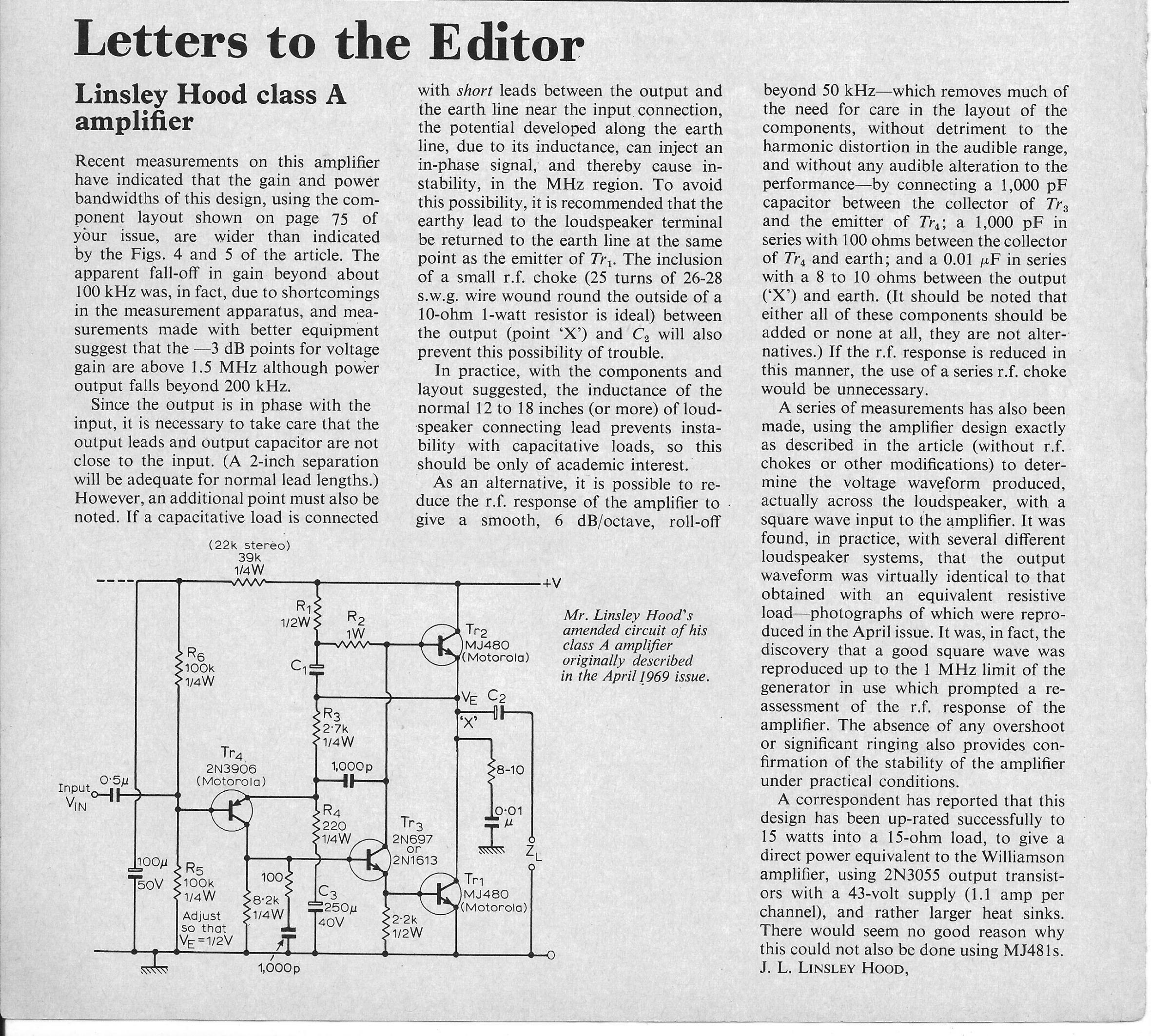

I wonder if I can borrow from the technically savvy amongst you.
I working on a JLH amp build using the SiliconRay PCBs. Based on information from several years ago in this thread, I plan to use MJL21194 transistors for the output devices - some of the common recommendation for the output devices (MJ15003, 2SC2830, etc) are getting hard to find nowadays but I know I can lay my hands on the MJL21194s.
I just have a sneaking suspicion that these devices might oscillate?
Can anyone confirm that the MJL21194 transistors are suitable.
Ray
Ray
IMHO they should be suitable, the MJL21194 aren't that much faster than the other transistors normally recommended here. Of course it could be that the amp oscillates, but had you substituted some other MJLs with a 30-odd MHz Ft I think that would have been much more likely.

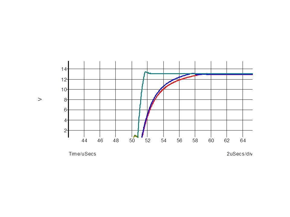

I agree. A simulation suggests that it will not oscillate. As I pointed out several replies/years ago the issue with these transistors is that the rise time is limited by the ft. The MJ21194 is better than the 2N3055 (4 MHz vs 2.5MHz) but for really good performance you need higher speed devices (e.g. 2sc5200 etc). I would recommend these but they will oscillate unless you add a 47pF compensation capacitor across the feedback resistor.

Thanks chaps.
that would be a 47pF cap in parallel with R8 on the attached schematic?
Ray
...but for really good performance you need higher speed devices (e.g. 2sc5200 etc). I would recommend these but they will oscillate unless you add a 47pF compensation capacitor across the feedback resistor.
John
Ray
Yes to both the last questions!
The current 2N3055 is OK for an output transistor but works better with a driver. When used in a bootstrap circuit as in JLH design, it can only pull up at its own speed. The epi 3055 is certainly better than the original RCA for this circuit!
Yes the 47pF capacitor should be wired across R8.
John

oop[s - I was thinking of the original circuit. BUt the difference in the rise times are small. THe attached diagram shows simulations of the amp with three output stages (a) using MJL3281A (2SC5200); (b) 2n3055 with current source and (c) 2N3055 with bootstrap. These are without the input capacitor, and cause overloading in the input and/or driver stages. With the input capacitor they seem fine but the rise time is equivalent to the slower signal. SHould sound OK unless the bandwidth is a limitation.

In his book on valve and transistor amplifiers Linsley-Hood commented about the transition frequency of the output devices (MJ480) of the 1969 circuit being 4MHz whereas those used at input and phase splitter were in the 400 MHz range and he observed "the circuit has an inbuilt dominant lag in its loop characteristics. This ensures the loop gain has fallen below unity (one) before the loop phase angle reaches 180 degrees. No additional HF compensation networks are therefore necessary to ensure complete loop stability even with reactive loads".
I cannot see any advantage in substituting 30 MHz devices or lead compensation in the negative feedback loop.
