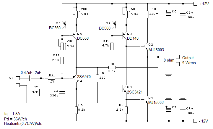

Hi Guys,
New to this thread. I recently bought the Siliconray (JLH 2005) +- 22Vdc bipolar version but then realized thanks to this forum that the version is way too powerful for my need and heat dissipation.., I then decided to adapt these free PCB for a less powerful version..i.e 9Wrms using +-12Vdc supply with an Iq of 1.5A, see schematics.
Can a good Samaritan have a look at my schematics and confirm if it all makes sense.
I intend to use a switching mode supply.
Thanks a lot.

Hopefully a switching power supply with +- rails. I have seen cases where using two commercial switching supplies cause interference when their frequencies are not absolutely the same - just a warning.
Otherwise use a single 24V supply and create a virtual ground using two transistors, a diode and two resistors.
That is the one. I have seen others that uses LM317/337 regulators maybe if you search for virtual earth on DIY audio. But the one above has worked for me for many years in all types of amplifier configs.Like this one, of course with the proper voltage ratings for the transistors and capacitors (same idea used in the later Quad power amps).
