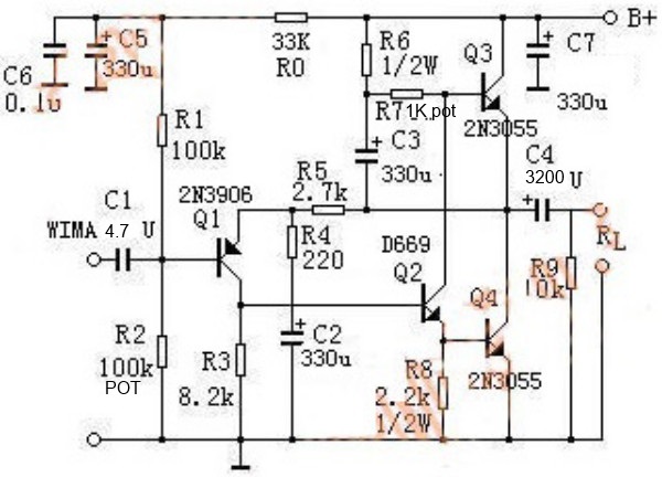

The boards I have suggest slightly different values from the original. Can one of you who knows this circuit take a look and let me know if you see any problems with the values in the attached schematic?
Thanks, Terry

OK, I have them burning. The only issue right now is that when they first fire up, with the input shorted, running on +24.5V rail I see about 6Vdc on the output. It starts dropping and finally after about two minutes, it will drop to about 80mv on one side and 5-10mv on the other. I haven't tried hooking up dummy load to it yet to see if that will have an affect on that.
Is this typical for the JLH?
Also, the schematic above shows am R9 resistor that is 10K. My board doesn't have that part. Would adding it be an improvement? The other JLH schematics I have looked at don't have it either.
Thanks, Terry
Output protection capacitors need charging
Terry, R9 and/or the speakers have to charge up the output capacitor at turn on. If you have no R9 and no load the capacitor will only charge up via leakage.
In the real world I get more thump from my power supply than the speakers at turn on.
This is normal for all Single polarity power supply amplifiers.
Use a speaker isolation relay to protect the speaker.
The relay needs a resistor on the NC contact to allow the output capacitor to charge up.
Simply disconnecting the speaker before power ON, is not good enough.
BTW the pulse is half the supply voltage. The current pulse gets bigger if you increase the capacitor to pass lower frequencies.

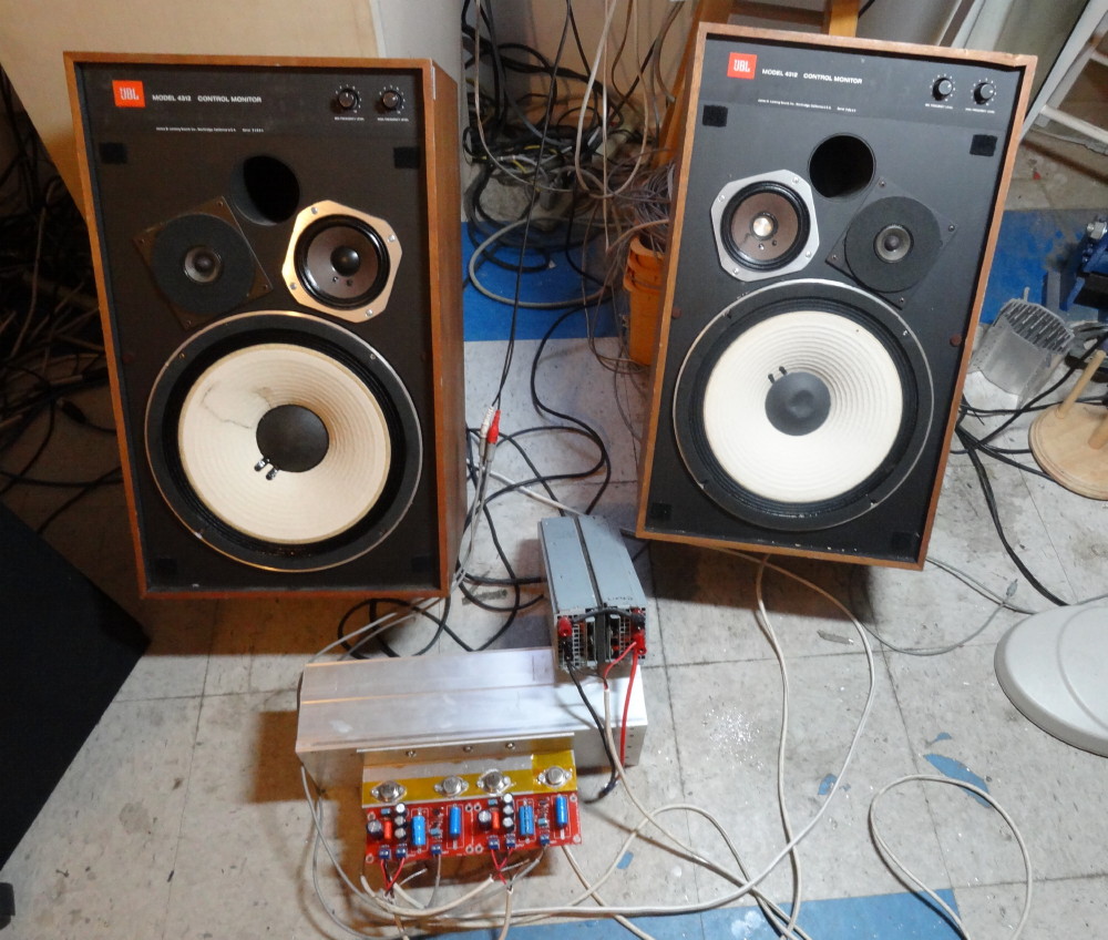

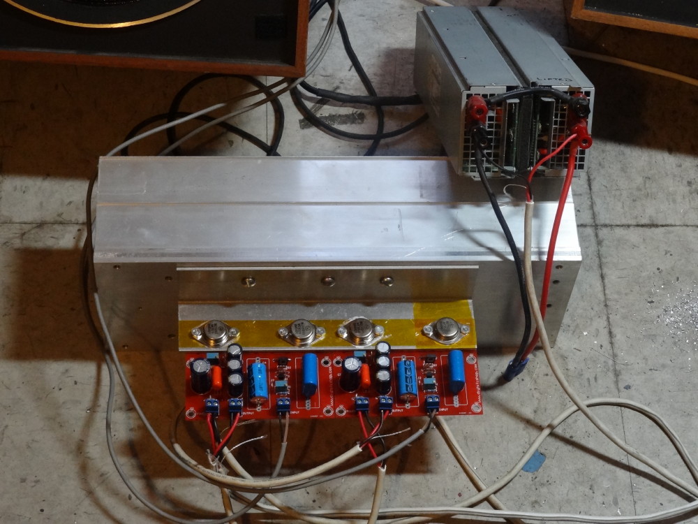

Thanks Guys,
You were right. As soon as I hooked up the speakers, it settles very quickly. Both sides go to 1mv within a couple seconds. Slight turn-on thump but nothing exciting. Best of all, It Is Playing Music
How's this for a little DIY action.
