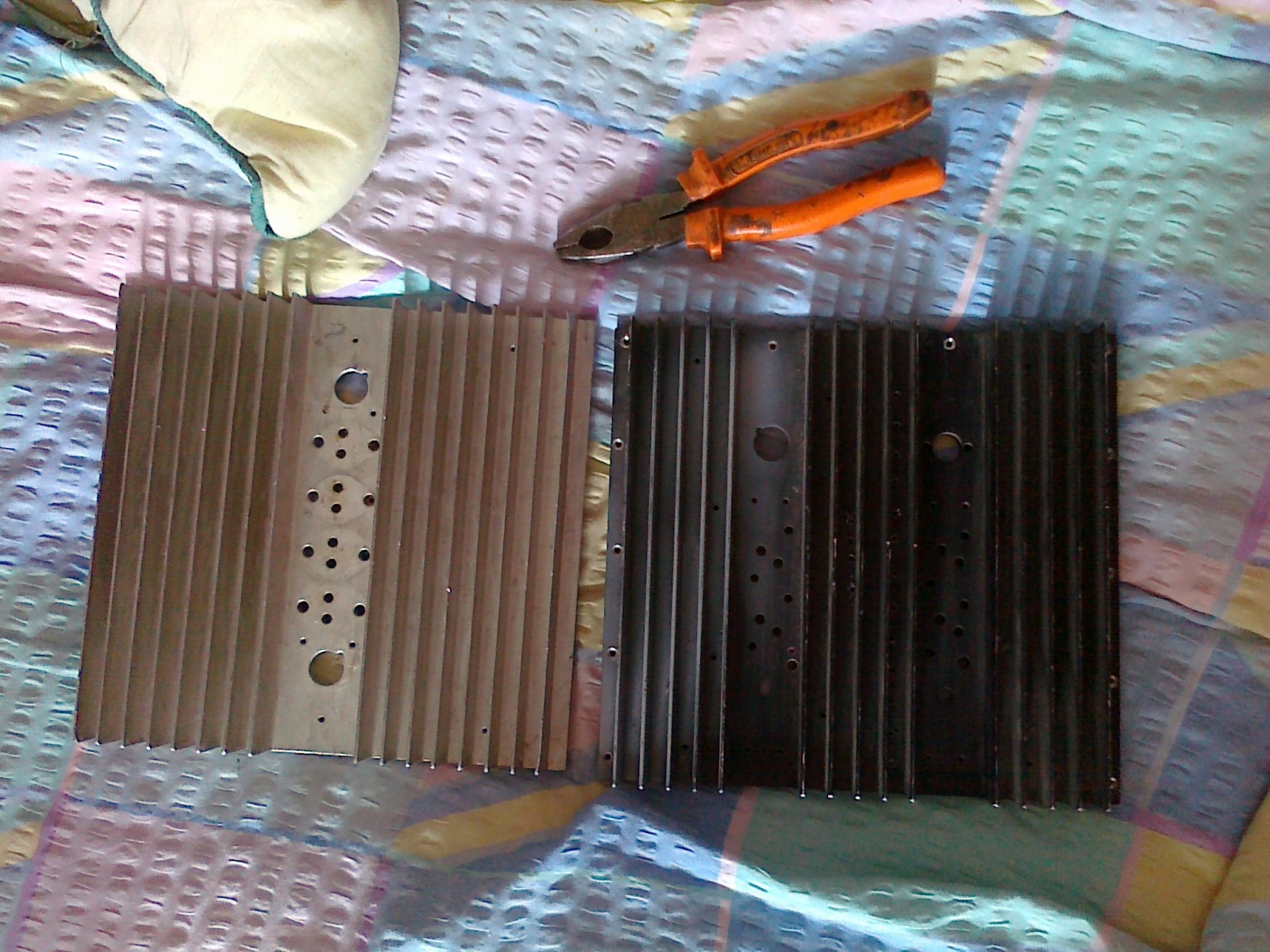

Good evening dear colleagues,
I opened a thread with these questions but didnt get so much help so i hope that someone that builded this wonderfull amp could help here.
I have bought these two radiators from the picture attached and hoping to find some answers from you guys:
*Note that the dimensions for both of them are: L=25.5 cm; l=23.5cm; h (for the base)=1 cm. The dimensions for the fins are: L= 23.5cm and h=2.5 cm. The black radiator has one fin less than the other.
1. Are these results ok for the total dissipation area?
Abase=2(L*h+l*h+L*l) =>Abase is 648.25 square cm + 885 square cm for the total of 15 fins (from the formula Atot=L*l*Number of fins) => A=23.5*2.5*15?
The total dissipation area is, from the calculation above (for the black radiator) 1533 square cm?
2. Are these radiators suited for a stereo JLH for QUAD ESL at 42W@8Ohm , @+-28V cc @3.2A quiescent current with 4 pieces 2n3055 per module?
3. Wich solution is best for the silver radiator: to spray it with a black thin coat of thermo resistant paint or to black anodise it (sollution wich i do not have at disposal in my county)?
Thanks in advance

Should just be enough. It'll get hot. The best way to work this out is to measure it - get a 10W or 20W metal cased resistor, bolt that to your heatsink (radiator); do some measurements and run the math.2. Are these radiators suited for a stereo JLH for QUAD ESL at 42W@8Ohm , @+-28V cc @3.2A quiescent current with 4 pieces 2n3055 per module?
On colour - the best thing to do is to leave the silver radiator (heatsink) as it is. Try and work out a physical arrangement which allows for the colour difference

(VISHAY SFERNICE - RTO020F12R00JTE3 - RESISTOR, 20W )If you are planning on dissipating 180W on those heatsinks, so get a big power resistor and give it 180 watts of power. I am pretty sure, those small heatsinks will be hot as hell. It is not exact enough measuring a heatsinks thermal dissipation factor using such a small applied power.
Thank you all for the sugestions. Now i am thinking about a measuring method: atach the radiator to a smoothing iron with an ampermeter conected in series, and then see how much wattage is applied to the sink.. What do you think about this method?
What do you think its best, to use these rads for the same amp but with 3.7A@+-22 V cc@ 28W (4 tranies per amp for better bass or use the variant with 2 tranies per amp? Wich variant do you recomend? The one with paralelled outputs has better control over the speaker, but i dont know how will sound the variant with a single pair of outputs.
Thanks in advance.
It'll be a rough approximation - the smoothing (clothes?) iron will also lose heat in other directions.
Another method would be to heat the radiators up to a known temperature (say 100C in the oven); move to an outside space (24C) and time how long it takes to drop to perhaps 60C. And do the math- you can weigh the radiator and you know it's aluminium so thermal mass can be found.

I am a little "old school" - the moment you add extra output pairs you're into device-matching purgatory. If you can live with less watts, the simpler architecture is always* going to be better. And easier.What do you think its best,

Thank you very much for the answers. I was trying to aproximate the temps with the smoothing clothes iron..
I guess i will stick to one pair of outputs as you said, because novadays we cannot find motorolla 2n3055 to closely match them. In Romania i have found some fake ones and another batch made by IPRS Romania at the local store...
