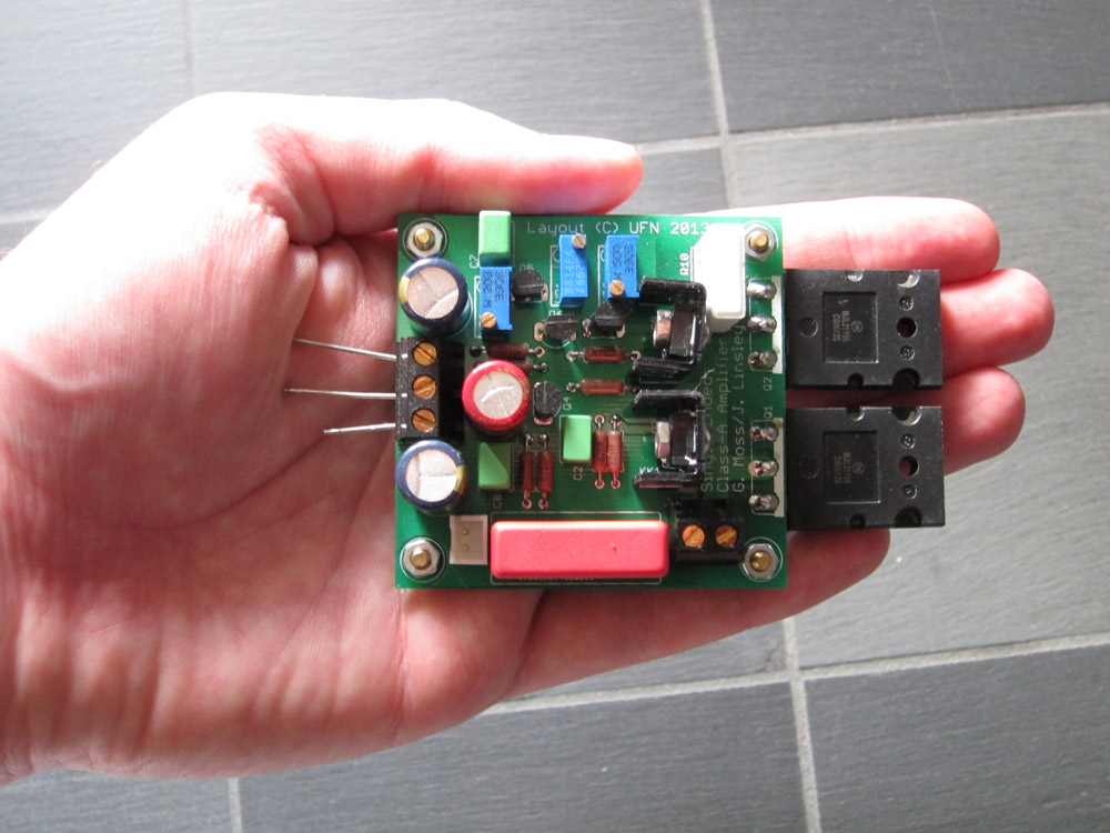

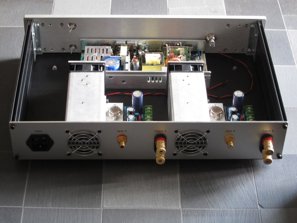

Hello to all colleagues here,

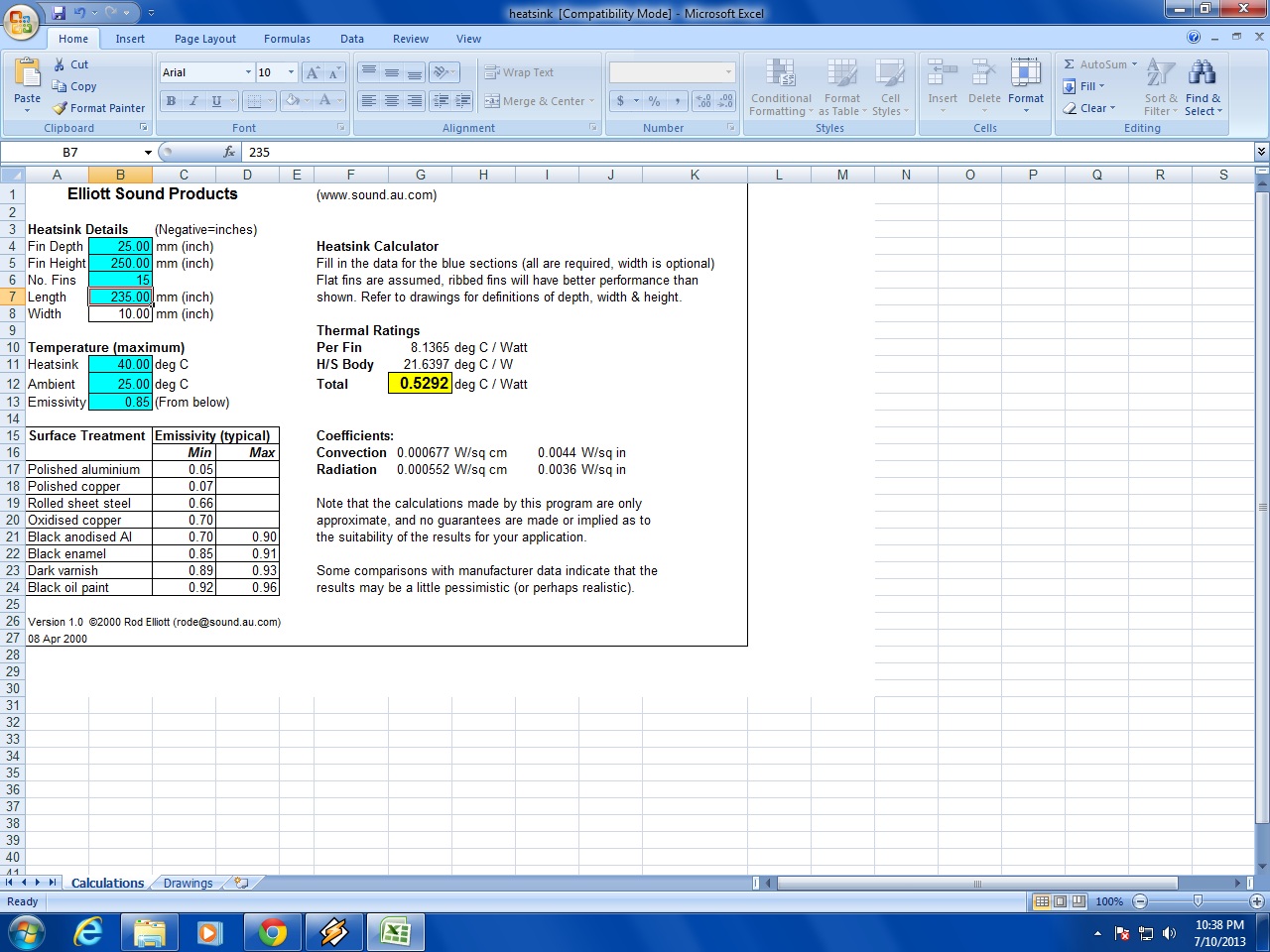

I have found a excel sheet from Rod Eliott that might simulate very close to the real thing (my radiators). Below are the results for one pair of output transistors and the excell sheet. Did anyone tried it before and compare it with a real world radiator that he posessed?
Thanks in advance.
PS: excuse my rought english.

You can perform this test for any wattage you please. From the data you can connect the points to create a graphical representation just like a manufacturer would - no guess work, just factual practical data no space science or brain surgery required. You can even do it using the intended transistors and mounting method you will use. What can be easier or more accurate - some spreadsheet?To test the heat sink all you need to know is the temperature rise at one watt. So if you bolt a 10 watt 1 ohm resistor to it and flow a constant 1 amp through it you measure the heat sink temperature before you start heating it and say half hour after, then subtract beginning temperature from end temperature and get degree centigrade rise/watt of power. Multiply this by 180 watt and add the ambient temperature to see if you can cook on it.
