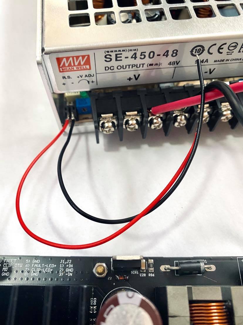

Mean Well SE-450-48
I have here a mean well SE-450-48 for my client, Vout can be adjusted from 39V to 55V (OVP triggering).
Indeed, the fan is loud and cannot be mitigated, so we've decided to just remove the upper cover and fan.
Quality is good and dimensions are substantially larger than typically sized LRS-350-36. This was just 60+USD last time, now the price is more than 70+ USD...

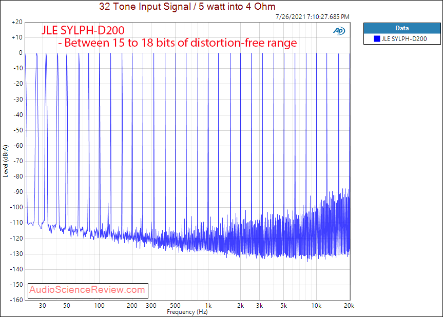

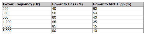

Nice! I have updated the PDF. Please ignore all other Sylph-D200 mods previously posted here, and use only the latest PDF.
Also Sylph-D200's strength is in the bass-midrange department. This amp is unbeatable when used in a biamp configuration, based on multitone test by Amir, distortion is very clean up to 3kHz. We can select crossover frequency at 3kHz, then use another amp for the highs, a 20W amp will suffice since average power at high frequencies for most music content is significantly lower (see attachment)
I also have updated the pricing in our website due to increasing parts cost, since 2020, some parts now cost 150% to 200% higher.
