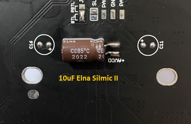

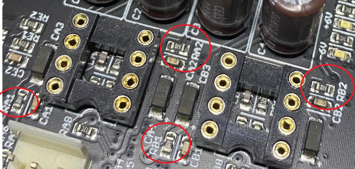

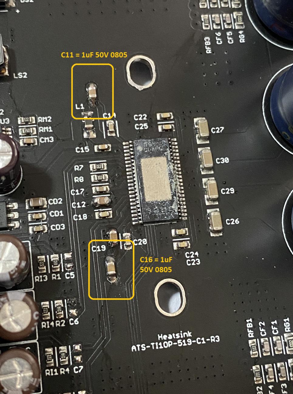

Sylph-D200 checklist
Here's a checklist to ensure that Sylph-D200 sound is optimal. (in order of importance)
1. Make sure RA1, RB1, RA2, RB2 is 0 ohm, or shorted with a solder blob.
2. Change (C11, C16) GVDD caps from electro capacitors under the PCB, to a 1uF ceramic
3. Change AVDD cap from 100uF Nichicon, to 10uF Elna Silmic II
4. Insert 47pF to 100pF C0G caps on pins 1-2 and 6-7 of opamps.
5. CS2 electro cap under the PCB can be replaced with 22uF Panasonic FR (placed on top of PCB)
PFFB has better highs than non-PFFB mode, however, some speakers are forgiving on their high frequency output. You can disable PFFB if your speaker's tweeter performance is good regardless of amp used.

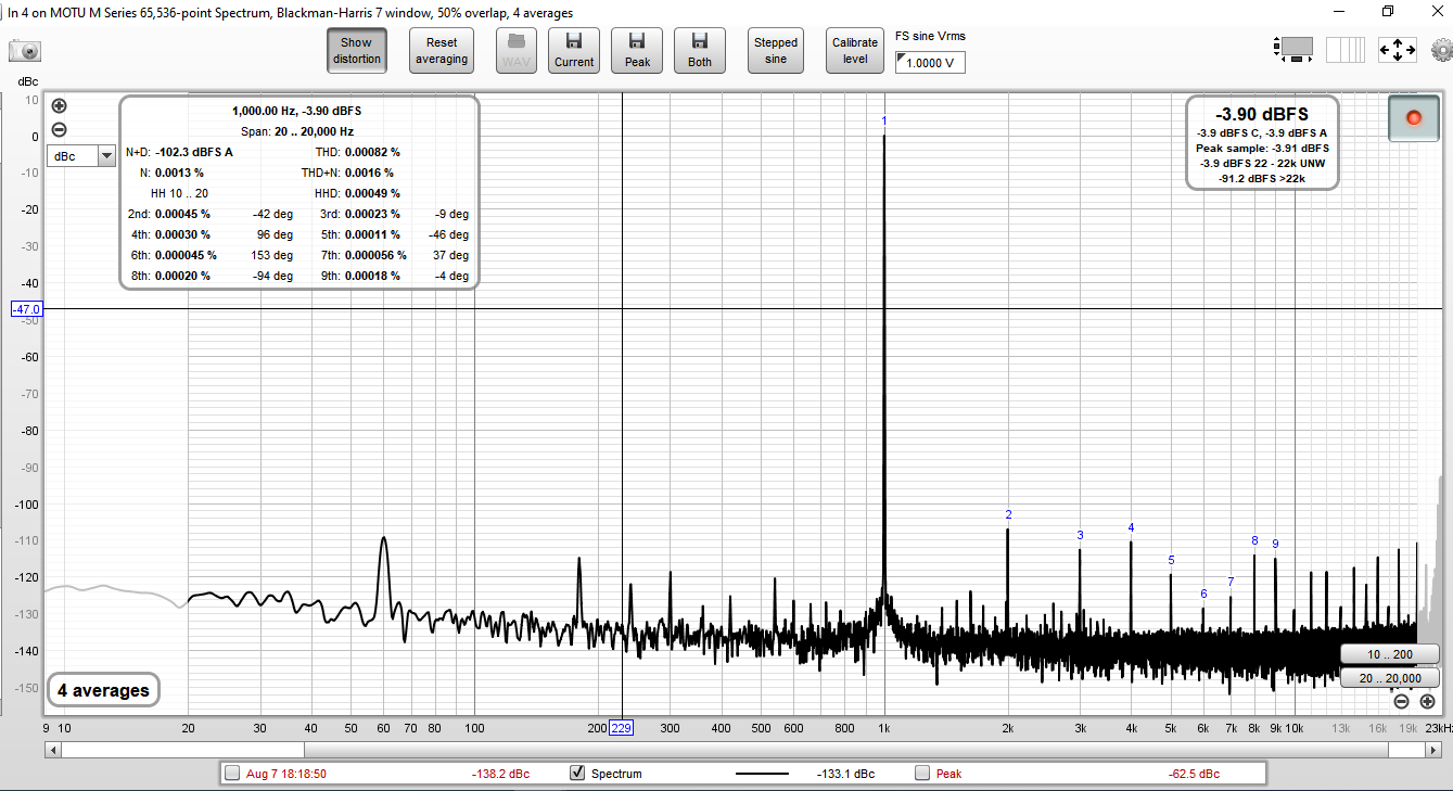

Been experimenting with PFFB values.
Latest values require 8pcs SMT 0603 changes in PFFB section, available for owners who want to tinker. The sound will remove some air and lowers down the high frequencies but the midrange will be as good as non-PFFB.
Attached THD spectrum 4ohms 5W and 10W (on 6.8uH coilcraft inductor). The noise floor is higher on this one compared to ASR because it uses 1.5X gain buffers and uses 48V supply. I will try to measure again with other modules using 1.3x gain.
Mains harmonics and high freq noise is due to 48V generic meanwell clone used in the setup.

The attached measurements look cool. What wonders me is the reduction in odd harmonics distorsion versus second and fourth order harmonics. Especially since bridge amplifiers tend to reduce even harmonics. That negatively affects the subjective sound quality.
Yes, I will post spectrum profile up to > 100W 4 ohms later after the values have been finalized..
Erratum: The module that I've tested with snapshots above has 1.8x opamp gain.

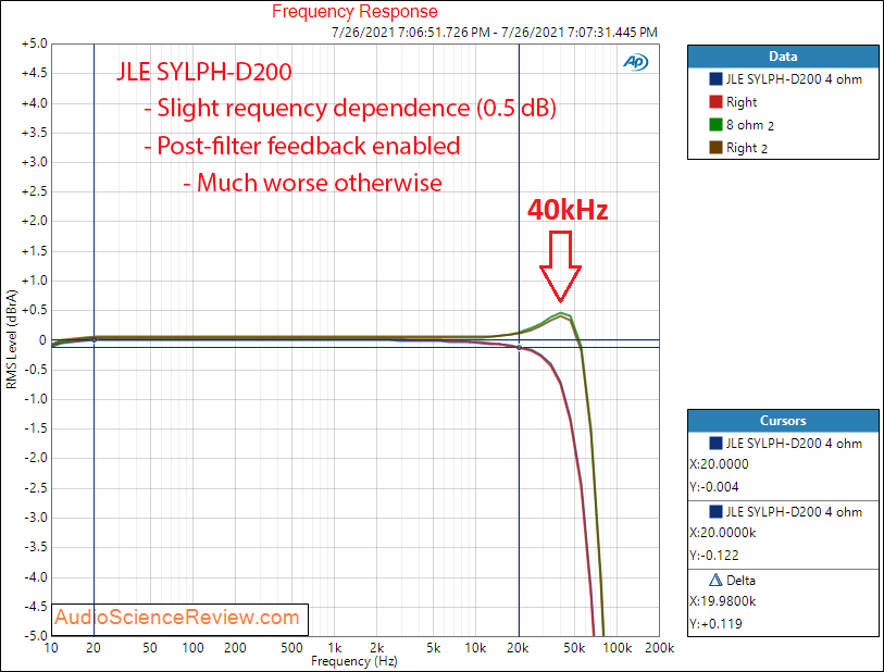

Hello
Good news.
Can we see the frequency response / 8 ohms and a square wave / 10kHz
Thank you

Latest config is almost the same as ASR config, except that the clipping power will be higher, and 2nd harmonic is dominant:
48V supply will get 93dB THD+N at 130W/4R (best THD+N is at 10W)
36V supply will get 93dB THD+N at 75W/4R (best THD+N is at 10W)
So I expect that the frequency response will be almost the same: +0.1dB at 20kHz for 8R load, and -0.1dB at 20kHz for 4R load.
+0.5dB at 40kHz for 8R load and -0.7dB at 40kHz for 4R load.
