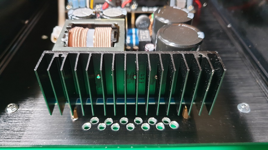

Also I see no advantage of using a plate heatsink configuration with present TPA3255 chip, continuous full power is not possible because the problem is in the rate of transfer of heat from a very tiny area of the IC to the heatsink itself. It's only designed for home use so EVM heatsink is sufficient.

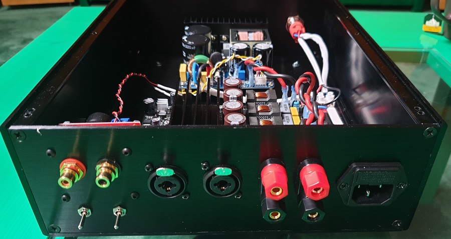

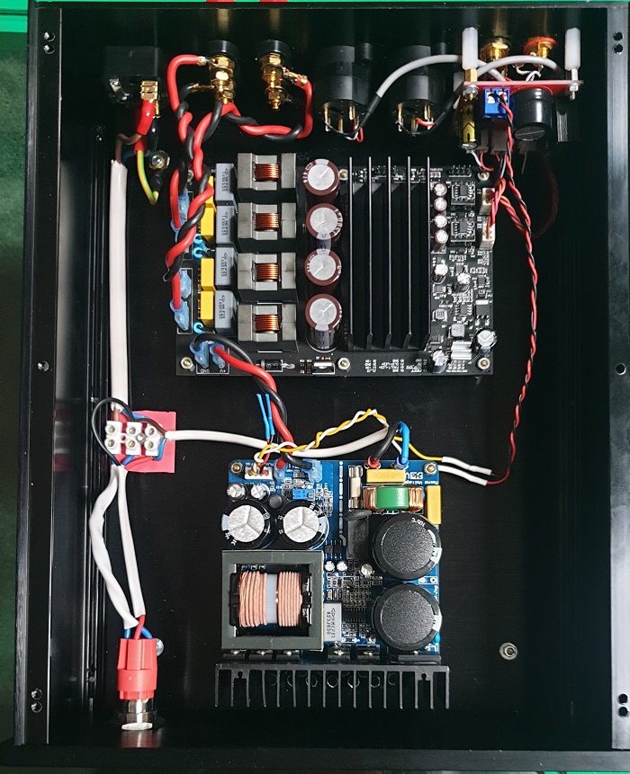

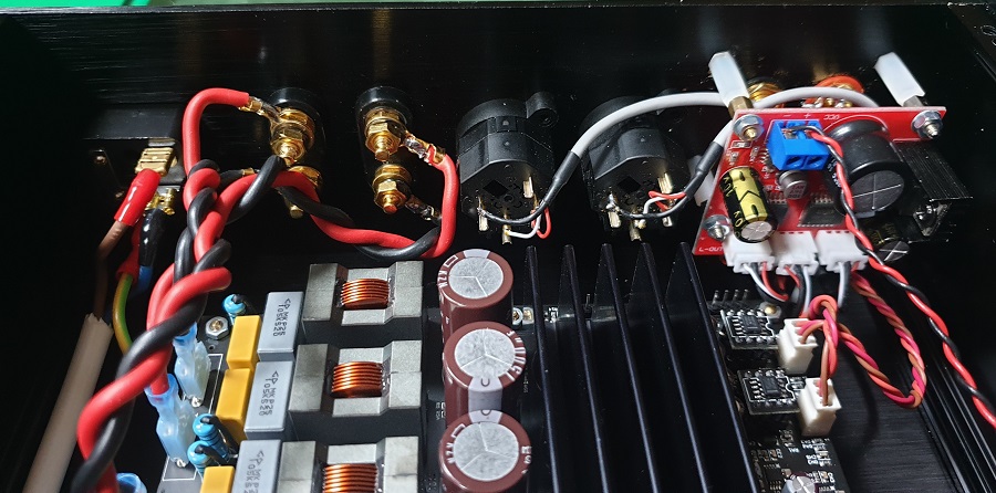

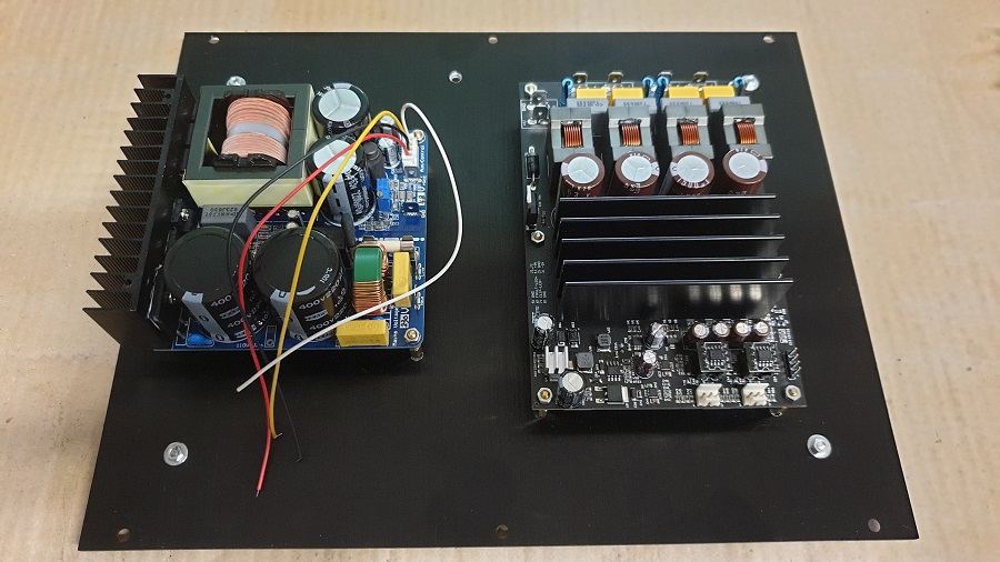

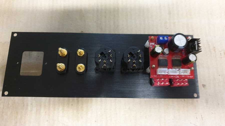

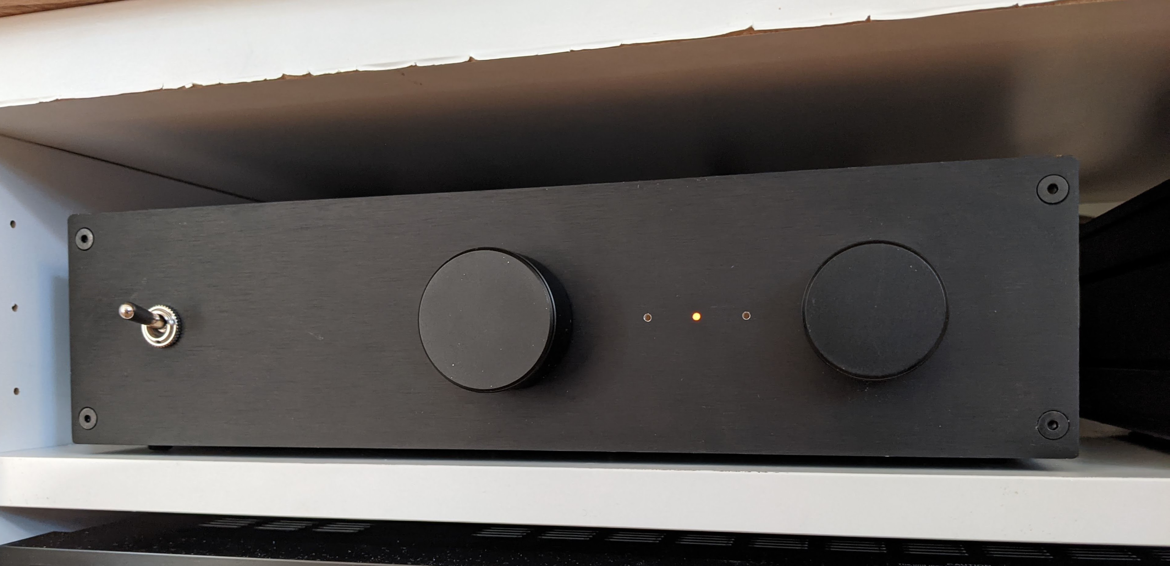

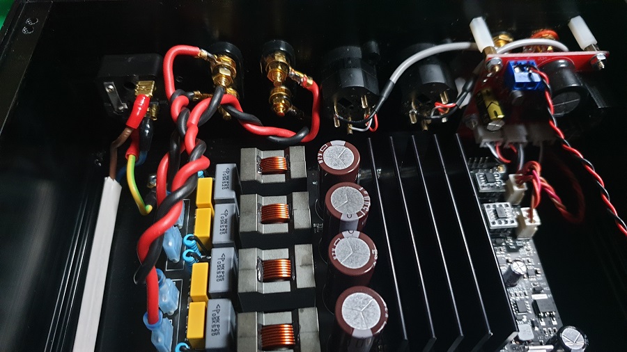

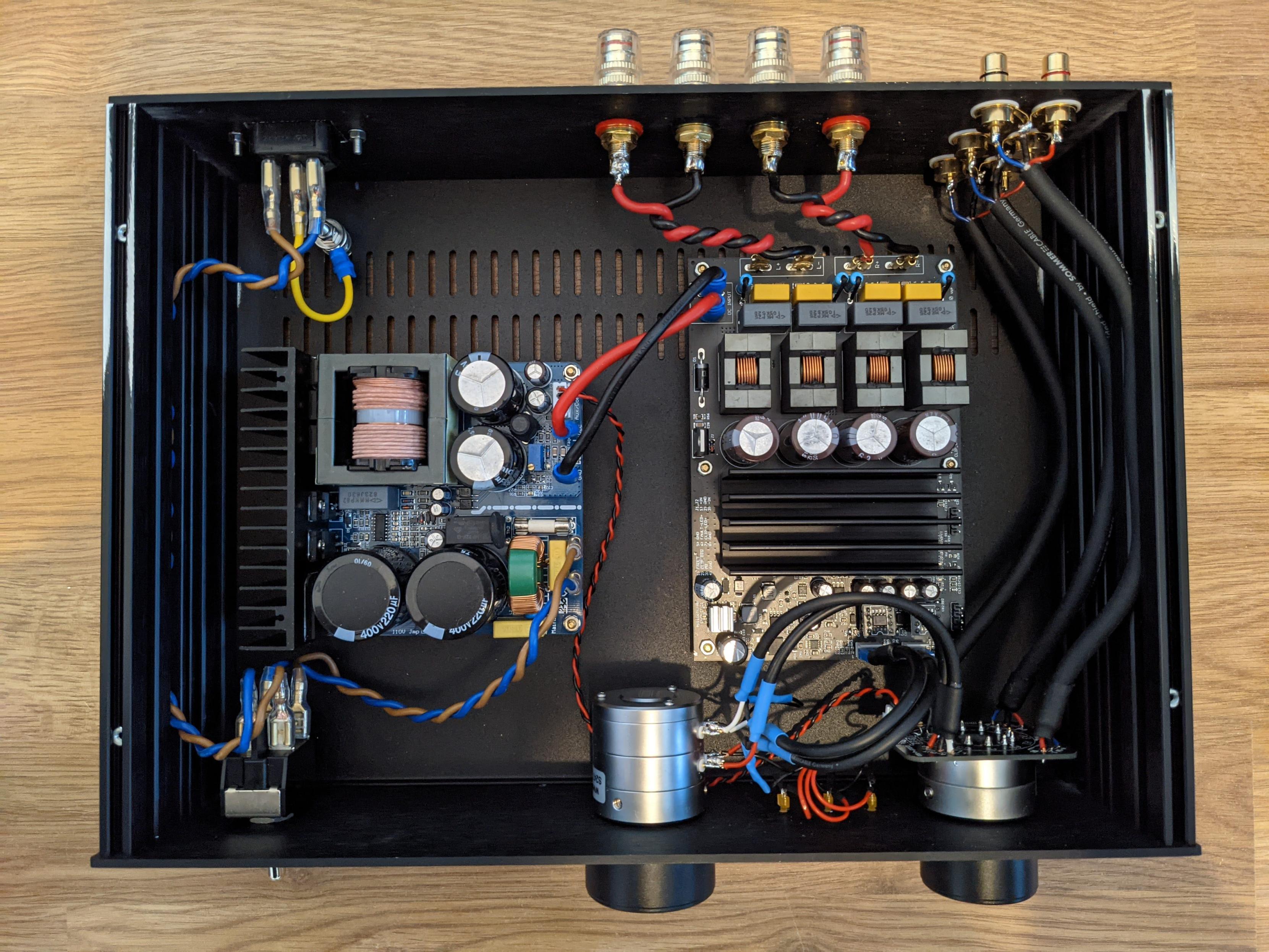

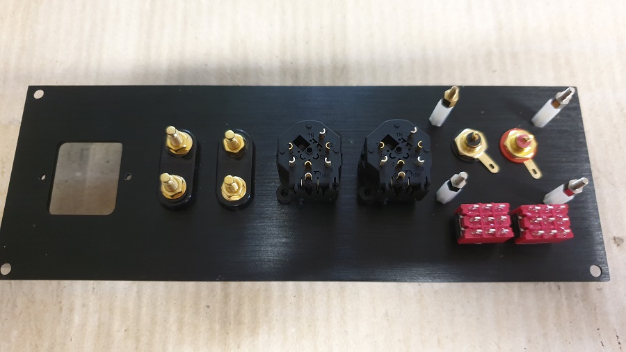

Hi, I have started an amplifier based on SYLPH-D200 TPA3255 modules. I used a configuration based on PFFB. First impressions. The sound is correct. No noise at all. Nevertheless, listening to it makes me a bit fatiguing.Something is missing or a little irritates me. I do not know. Maybe it is the lack of warming up the amplifier or maybe it is the use of PFFB?
For comparison, I use four other amplifiers every day: based on modules First One ver. 1.4, based on modules Hypex UCD400HG, based on modules Zappulse 2.3 and Powerdac Mini 151.
Each of them has a slightly different sound signature. As for me, the best sound is provided by the amplifier based on First One modules. Hypex is close to it, but more boring and at the same time a bit irritating (something is missing).
Built amplifier on SYLPH-D200 TPA3255 modules has the most similar sound to UCD400HG. This is a very good amplifier, superior to many others available on the market for much more money, but....

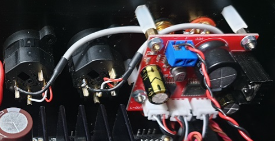

Also, instead of using this module, you can use a DPDT switch to select from Balanced to SE toggling. Looks like this module degrades the sound.
Thank you for trying to help. The module shown in the picture is only used to symmetrize the signal from the RCA sockets. I did not use it, because for testing the amplifier balanced signal was fed to the xlr sockets.
As I already wrote at the weekend I will try to disable the PFFB. I hope it will do something.

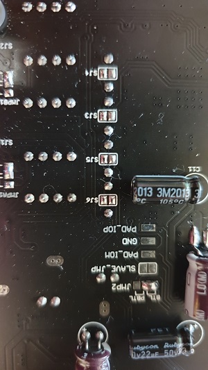

I didn't wait until Saturday and just now disassembled the amplifier. And I checked the jumpers switching on the PFFB. Well, contrary to my request when placing the order, it was not turned on. So my previous observations referred to the amplifier without PFFB (take a look at the photo).
I immediately connected the jumpers with solder. I plugged the amplifier into the sound source. And finally it is reasonably good for me. The sound gained life, air, clear sound of instruments. Unpleasant impressions disappeared.
These are first impressions. Quite OK. So it turns out that, for me, the sound quality is much better with the PFFB.
Now I'm getting down to serious listening to a wide variety of audio content.
I will write about the final evaluation of the amplifier in a few days.

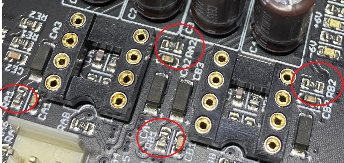

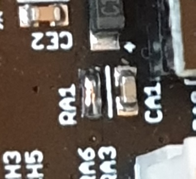

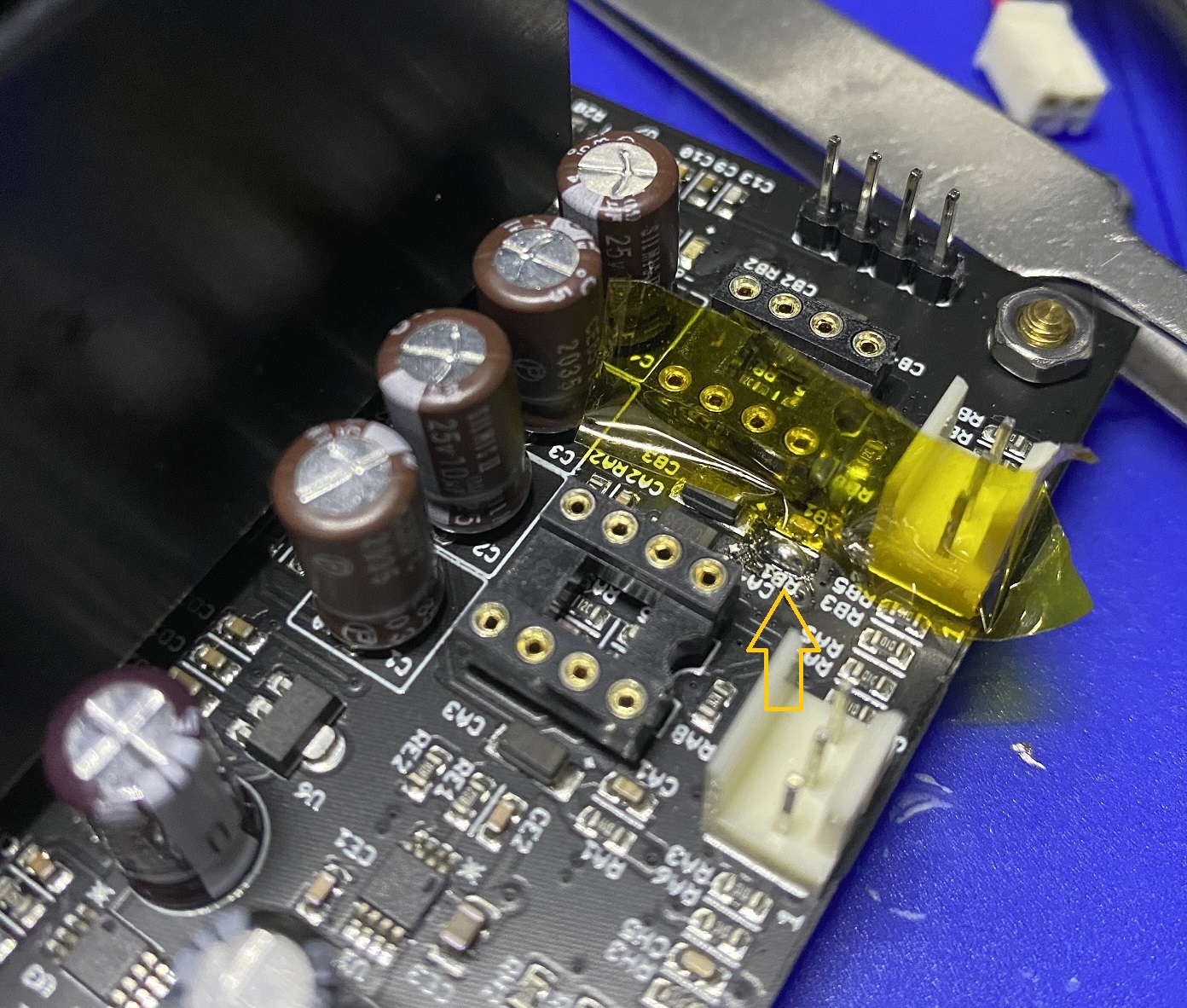

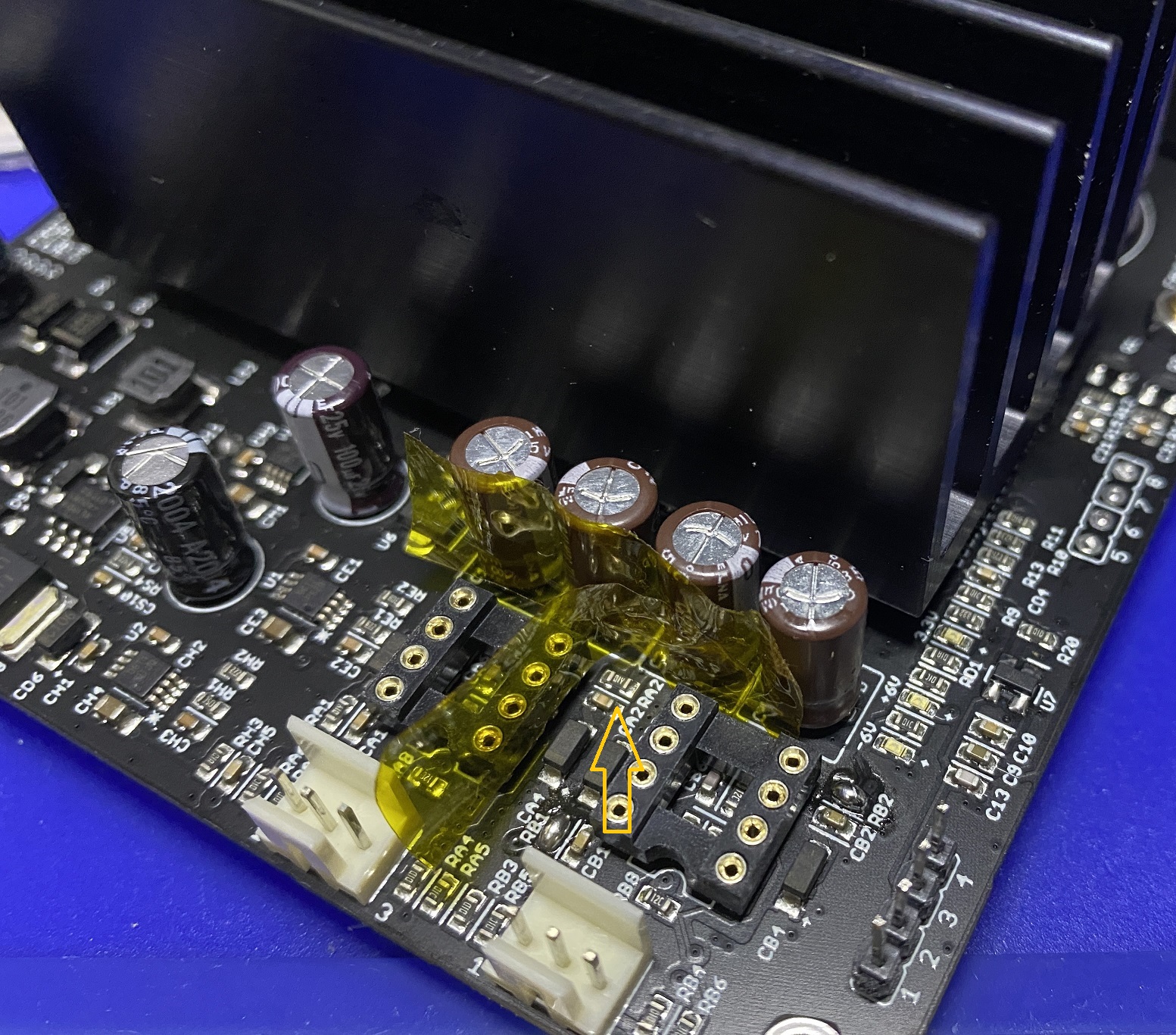

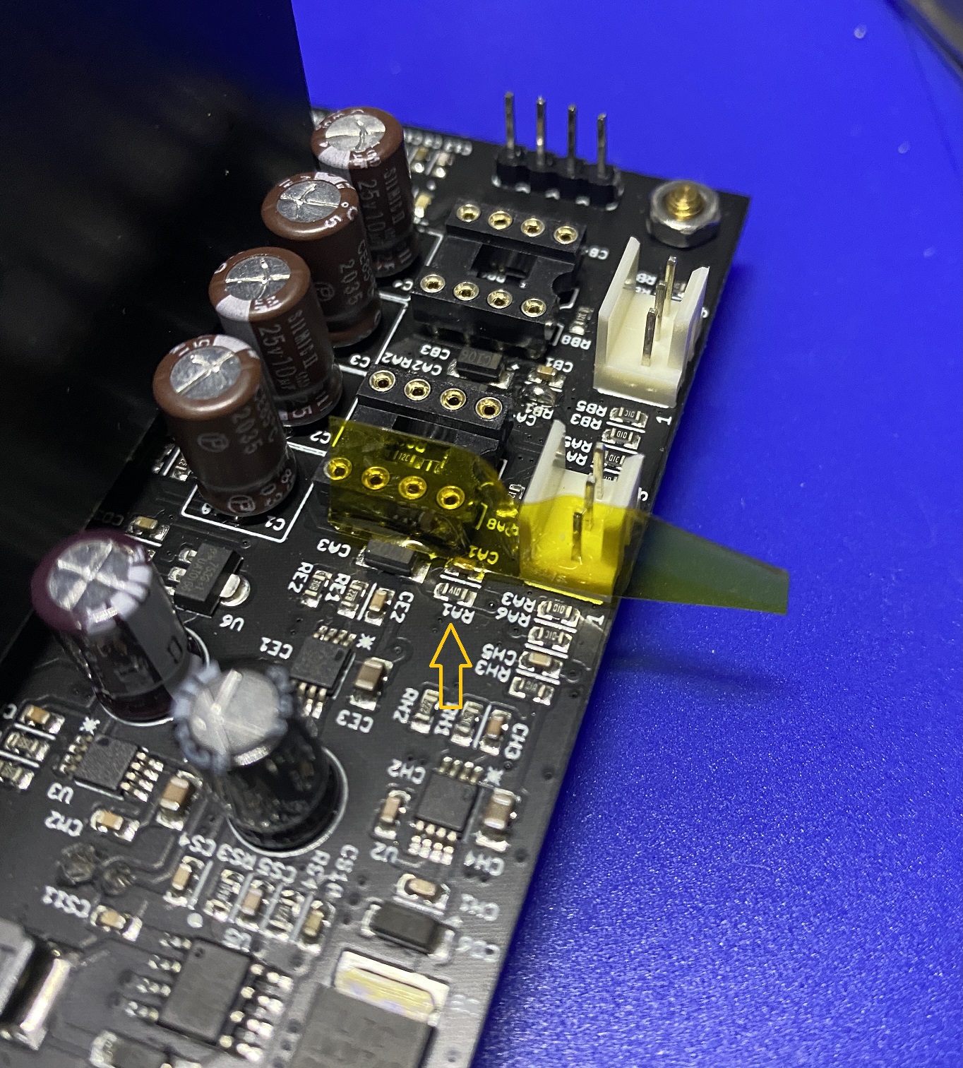

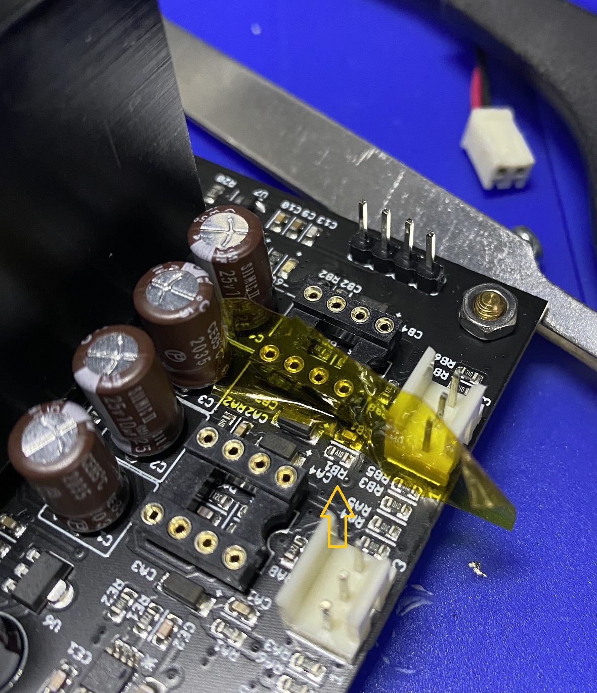

Attention Sylph-D200 users: kindly check if the opamp supply (RA1, RA2, RB1, RB2) has 0 ohm series resistor. If the installed resistor is 1 ohm (01Y code), you may experience degraded (slightly distorted) sound.
If the installed resistor is 1 ohm, you need to remove them and short them with a solder blob. At least 10pcs modules have 1 ohm resistors installed. Subsequent module already have 0 ohm 0603 resistors soldered (or shorted with blob).
I was investigating the difference between my reference (best sounding module) and the current batch and it is one of the culprit.

RA1, RA2, RB1, RB2 are shorted with blob on my module. So no problem on this side.
