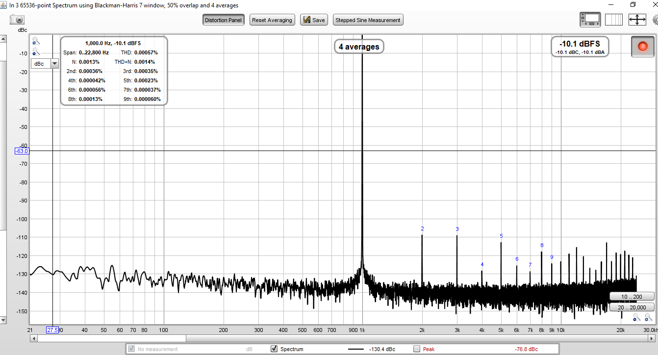

I have tried without pffb. Really dont like it. Will restore it !
Are you using balanced connection? I can't detect constrained sound on balanced + PFFB combo, though I will compare this weekend just to make sure.
Could we get some results at 5 kHz as well? Intermodulation testing would be much appreciated too.PFFB changed to 18K/2K, lowered gain to 8.9
Motu M4 Balanced out -> Sylph-D200 -> JLE Interface -> Motu M4 SE input (Line In 4)
5W 4 ohms
THD = 0.00040%
THD+N = 0.0015%
SINAD = 96.5dB

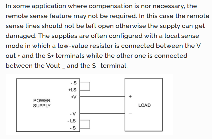

I’m using Meanwell SE-450-48 due to it’s higher switching frequency, following Lester’s advice. For some reason the fan never turns off, which drives me crazy. Maybe I will change to Connex as well. Lester do you prefer 36v over 48v due to lower power dissipation in the amp?

THD-wise, pretty much flawless... well-done!Here's the latest 5W 4ohms using SMPS300RS and inside the chassis (hot heatsink)
SINAD is 97dB but THD is worse
You can try disconnecting the fan. If it doesn't like not having a fan, you can replace with a dummy load. Just make sure you check the temps during loud/low-crest-factor music to make sure it's not getting too hot. If it does get too hot, replace the fan with a 80/92/120 mm silent PC-style fan, e.g. Noctua.I’m using Meanwell SE-450-48 due to it’s higher switching frequency, following Lester’s advice. For some reason the fan never turns off, which drives me crazy. Maybe I will change to Connex as well. Lester do you prefer 36v over 48v due to lower power dissipation in the amp?

Meanwell SE-450-48 also has remote sensing function. Try to connect it as specified on this link before you remove the fan and top cover. Remote Sensing - MEAN WELL Direct

Thanks for the advice.
BTW, meanwell application engineer says the fan should go off. I called the local distrobutor service and they claim they checked another new PS of the exact same model and the fan always on. Go figure... Unfortunately there is no schematic diagram available and I'm not going to spend my time on reverse engineering / troubleshooting the issue. It's not that important.
I disconnected the fan and will watch the hot areas during operation. In case needed, I will add an external fan considering the chassis structure (once I have a chassis ).
Regarding the remote sense, I checked and there are internal 10 Ohm resistors between the outputs and the sense conenctions, so I assume direct connection will not change much.

I thought that by not connecting the remote sense, it messes with load current detection of the power supply, that's why the fan doesn't want to turn off. But maybe I'm wrong.
