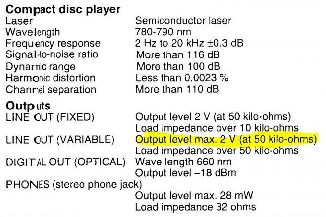

I bought a Sylph-D200 that is on its way to me.
I want to use a stepping potentiometer like this on from EIZZ.
What resistance should I use? 10KOhm, 25KOhm or 50KOhm?
My source is a CD Player with variable 2V / 50KOhm RCA output and a Mediaplayer/DAC. I don't know the impedance of the Mediaplayer/DAC.
I'm not sure if I will enable PFFB. But is it possible to solder a switch at the solder bridge, so I can easily switch PFFB on and off? Or is this a bad idea?
Sources should have a low impedance output, typically below 50 ohm or up to 600 ohm for DACs. Get a 10k potentiometer for Sylph-D200 inputs.
I'm a bit confused about the impedance. The service manual of my Sony CDP-X202ES states "Output Level 2 V (at 50 kOhm); Load impedance 50 kohms by fixed output and over 10kohm by variable output"
Does it mean something different? Can I connect the cd player diretly to the Sylph-D200 with a 10k pot?
Line Out (Fixed) - means that the CD player will output 2V fixed on a 50K ohm load impedance. You can connect 10K ohms or higher load into it. (probably you will get less than 2V output on < 10K impedance load because it will become voltage divider.
Line Out (Variable) - means that you can control the volume on the line out. You need a buffer/preamp after this line out. Probably your cd player doesn't have a buffer on the output after the "variable" potentiometer.
Since you will be placing a separate (10K) potentiometer before Sylph-D200 input. You can to connect it to the "fixed" output of your CD player.
There it says that the "fixed" output can drive 10K load.
Anyway, your CD player can still drive the Sylph-D200 to full output since the input sensitivity of our module is 1Vrms (non-PFFB)
Lester
