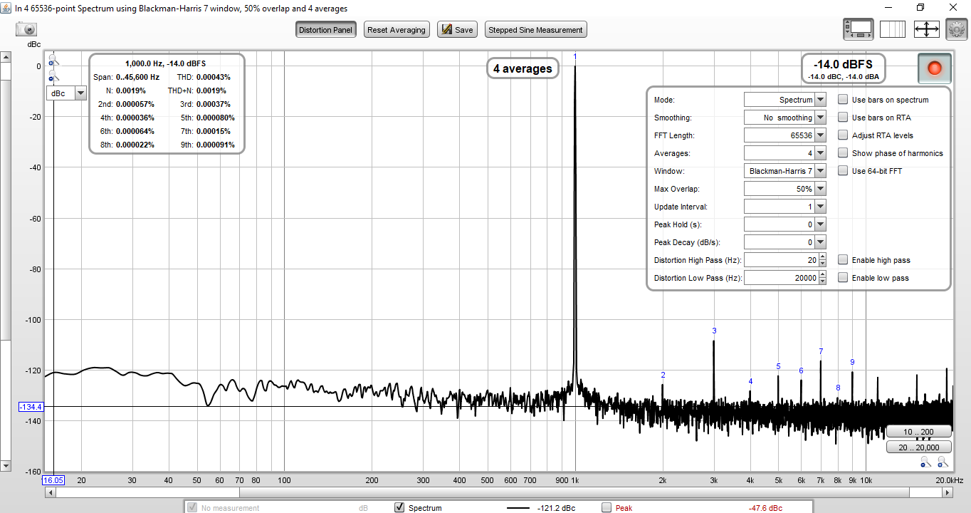

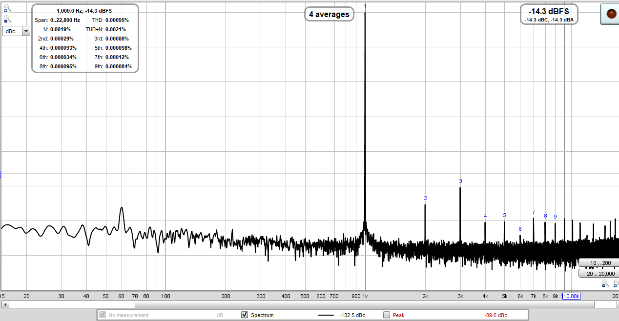

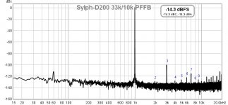

Received the TRS connectors just now. I can get 0.0008% THD+N loopback measurement with 2.5Vrms input/output on my Motu M4.
Here's a quick measurement of Sylph-D200 with 33K/10K PFFB value (gain is around 11.5), 450kHz switching freq, and 36V DC using LRS-350-36
Using Motu M4 monitor out #2 , and line in #4
I'm using my soundcard interface with INA134 + OPA1656 to protect the Motu M4.
4.5Vrms = 0dBc
5W 4ohms
THD = 0.00095
THD+N = 0.0021
Looks like I need to use an external oscillator rather than using Motu M4's line out to get more performance.

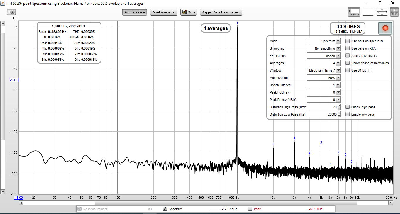

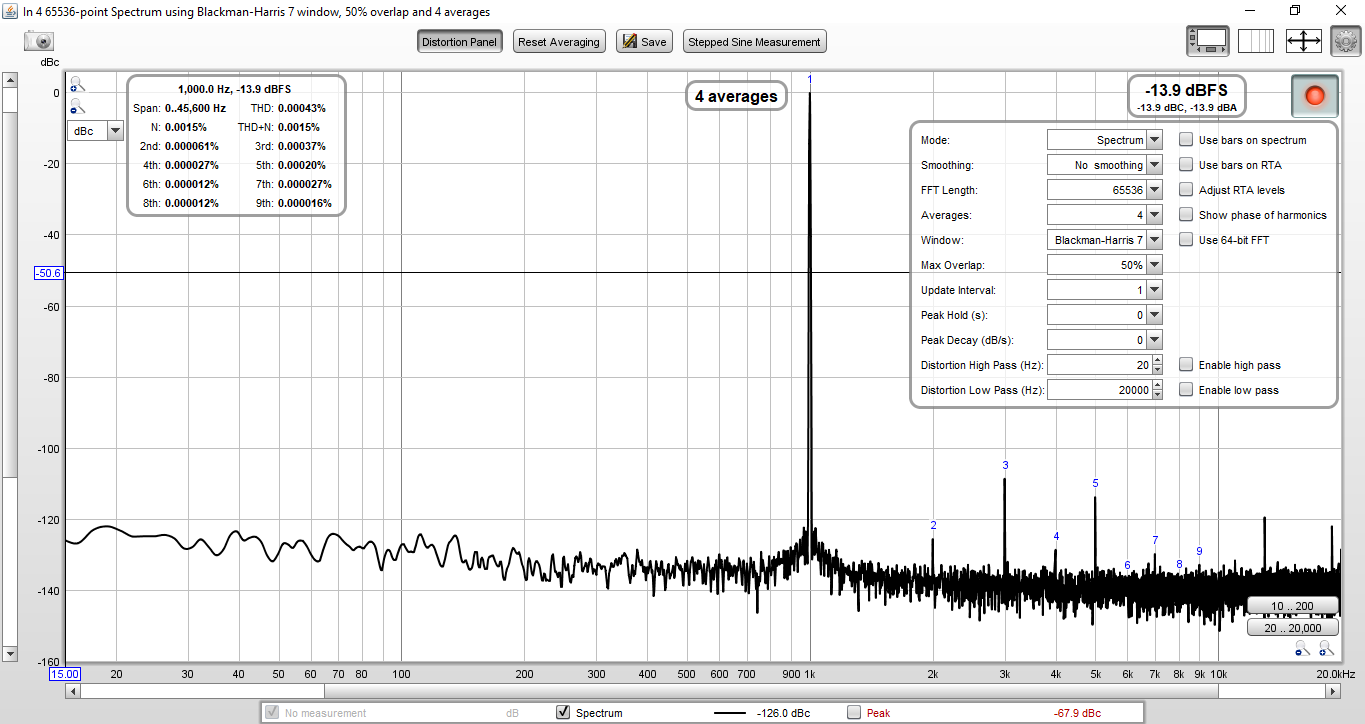

PFFB changed to 18K/2K, lowered gain to 8.9
Motu M4 Balanced out -> Sylph-D200 -> JLE Interface -> Motu M4 SE input (Line In 4)
5W 4 ohms
THD = 0.00040%
THD+N = 0.0015%
SINAD = 96.5dB

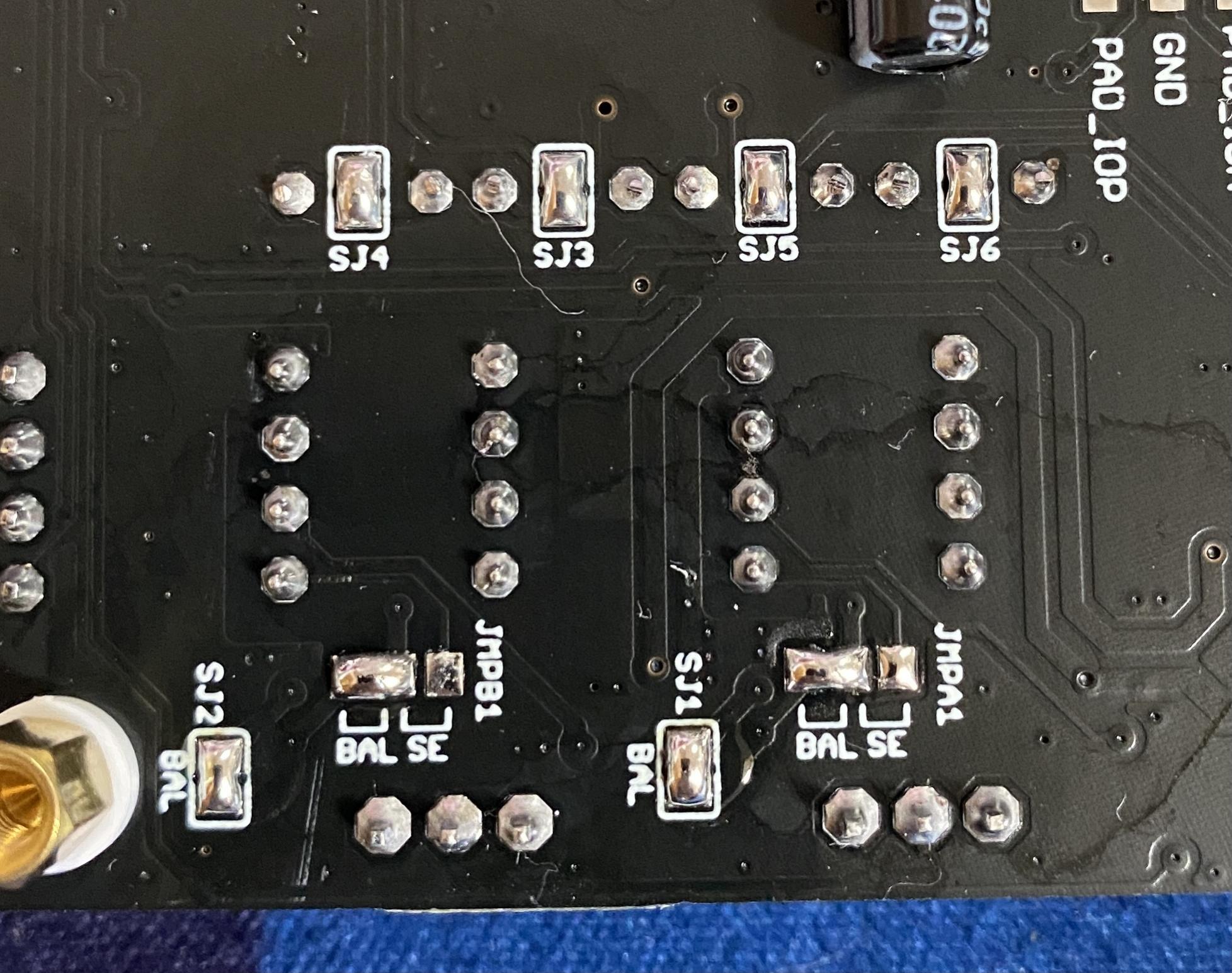

Has anyone tried using the XRK Audio BTSB Buffer with the JLE board (or any other TPA325x board). Depending on the version, this provides a true Balanced Buffer using LM47924 or OPA1637 Op-Amps and also offers some optional gain if required.
So after a long journey I finnaly got my SYLPH-D200 module. First impression- it looks extremely well made, with perfect attention to any detail. It also sounds great- powerful and quite natural in sound (very firt impression).
I do have two questions-
1. I would like to compare PFFB vs non-PFFB. How to enable the PFFB in the latest module?
2. Is it OK for the module to work w/o load? in case I want to switch the speakers to another amplifier during operation- will speakers disconnection during operation can har, the module in any way?
Aviv.
Hi Aviv,
You can enable PFFB by putting a solder jumper on SJ3, SJ4, SJ5, SJ6 (pic below for PFFB & Balanced configuration)
For non-PFFB, there is no problem if there is no load connected.
For PFFB I would be cautious on running it without load. (Specially if there is a source connected, and has a music output)
You can drill a hole under the aluminum chassis / casing so that you can enable/disable PFFB without disassembling the whole module.

Hi Lester,
Thanks for the info. Regarding SJ3-6, are they part of the signal/feedback path so I have to be carefeful regarding EMC considerations (i.e. solder as shost as possible) or they are just control signals so I can solder a mechanical jumpers/swich?
Aviv.

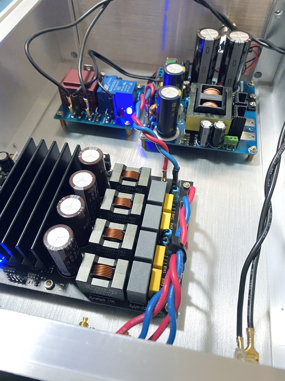

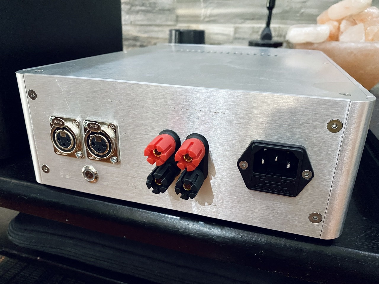

Running my Sylph-d200 in fully balanced mode + PFFB low voltage version.
I like it! 🙂
