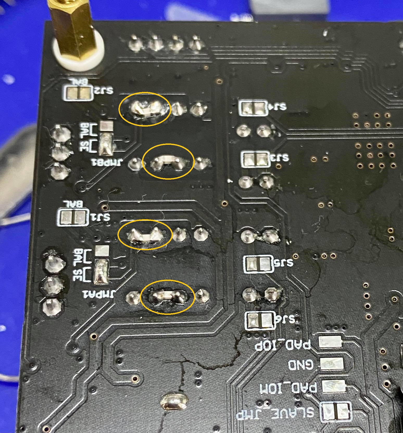

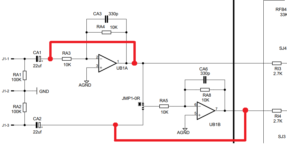

Here is bypassing of opamps if you want it with blocking caps.
You can safely connect your DAC with this config.
The amp will not start though if there is no source connected.

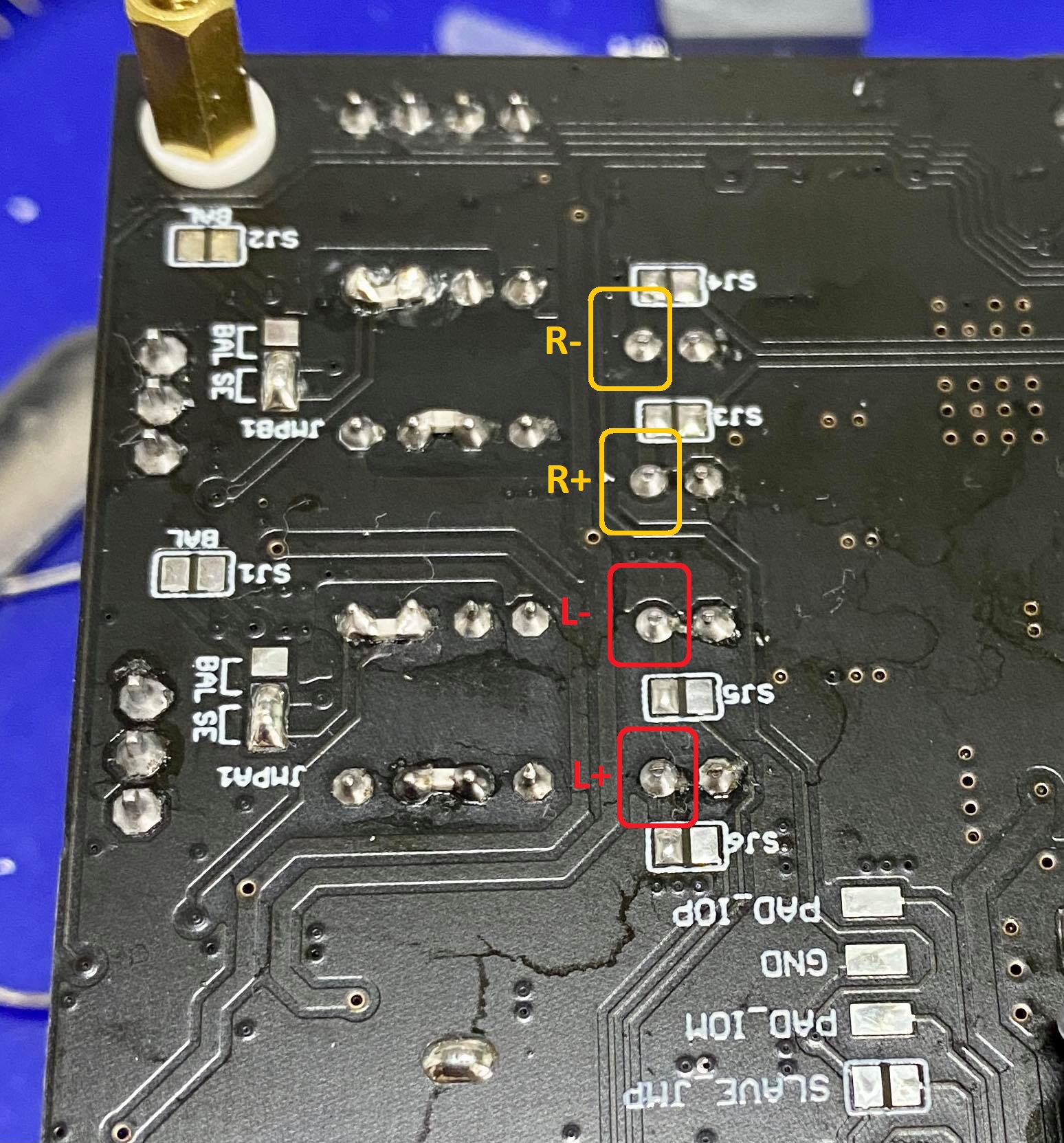

I'm going to use Jensen JT-11P-1 input transformers with these modules. Can I use pin 1 and pin 7 of the opamp socket? What else is between pin1/7 and the TPA3255? (Can't quite see on your picture).
https://www.diyaudio.com/forums/att...6209-jle-tpa3255-build-modifications-byp2-png
Thanks again,
Mike
Hi Mike,
I've sent the schematic on your mail. Also check spam folder if it's not in your inbox.
Remove any opamps on the socket and tap the coupling caps' pins on the attached image.
Lester

PFFB: Remove any opamps on the socket, tap opamp pins 1(IN+) and 7(IN-)
Non-PFFB: Remove any opamps on the socket and tap the coupling caps' pins on the attached image in post #205.
If you remove the opamps, PFFB requires 5.4Vrms balanced full scale to clip the output. Wick out SJ3 to SJ6 to remove PFFB in order to get more gain, since on Jensen JT-11P-1, signals higher than +4dBu (1.23Vrms) has less performance. Only 2Vrms (balanced full scale) is required to clip the output in non-PFFB.
