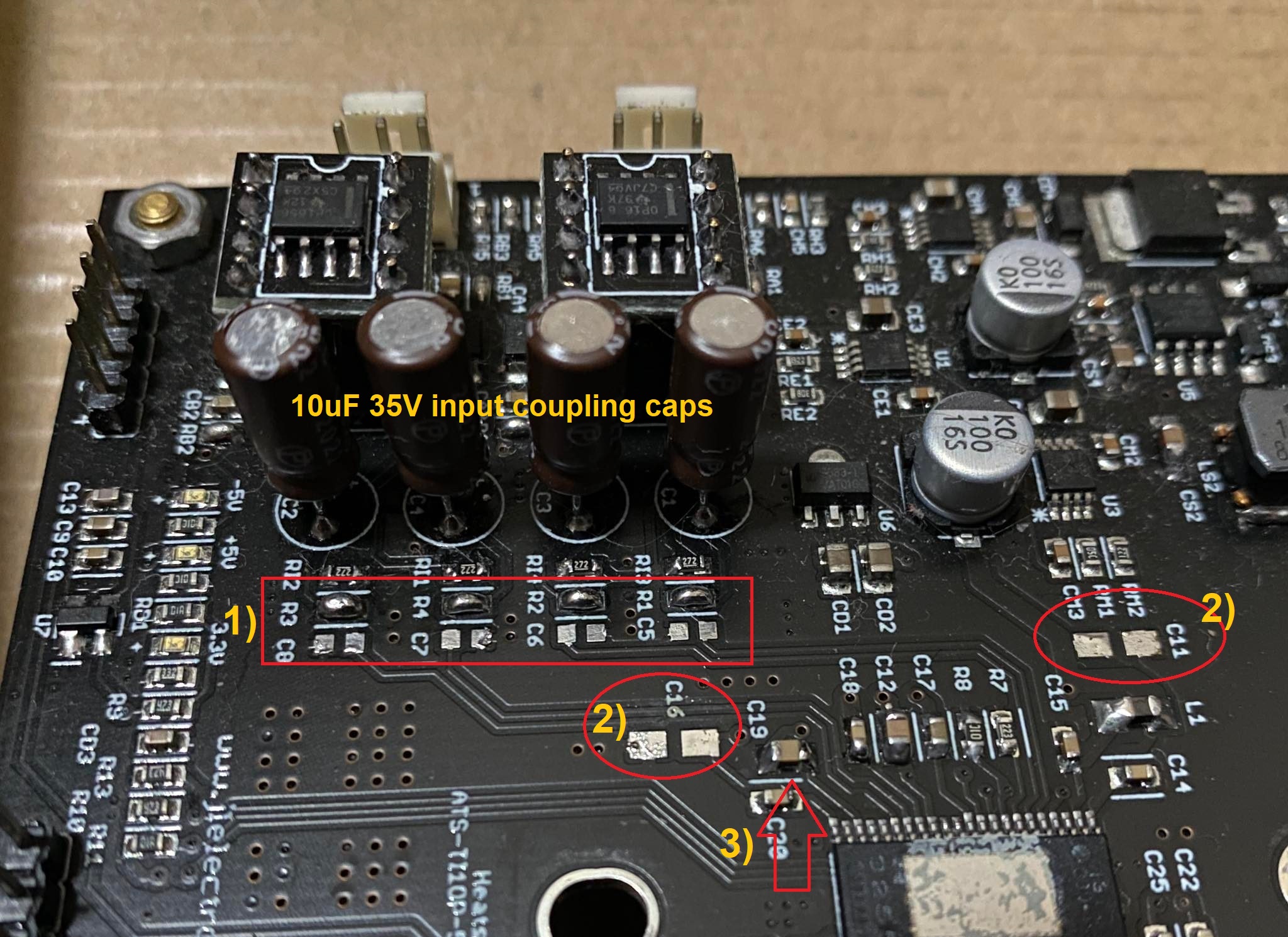

Based on my comparisons with different Sylph-D200 builds, I think bypassing the 100ohms + 100pF RC filter after the input coupling caps results to a "fuller" sound. It is really noticeable specially in the bass and mids.
Also it is a very easy mod, just remove all the parts and put a solder blob in place of 100 ohms.

Attached pic of the removal of 100R + 100pF RC filter. (1)
No caps on C11 and C16 (2)
100nF cap on VBG C19 (3)
If these mods are made, the sound will be very full and balanced even if OPA1656 is used and PFFB is enabled.

Yes, shipments next week onwards will have those RC filters removed.
Attached PDF with latest and simplified mods (only the most important are included).
Modules shipped on September onwards already have some of the mods.
TICore260BTL equivalent mods
Remove 100R + 100pF RC Filter (solder blob on R1, R2, R3, R4, then remove caps beside them)
Change C17 to 100nF (0603 or 0805 16V or higher)
Solder blob on RA6, RA7
Solder blob on R8 and R10 (for V1A and V1B)

Yes it is definitely a worthy mod. If you are running it with PFFB enabled, you may want to change the PFFB values as well if you can solder 0603 SMTs.
