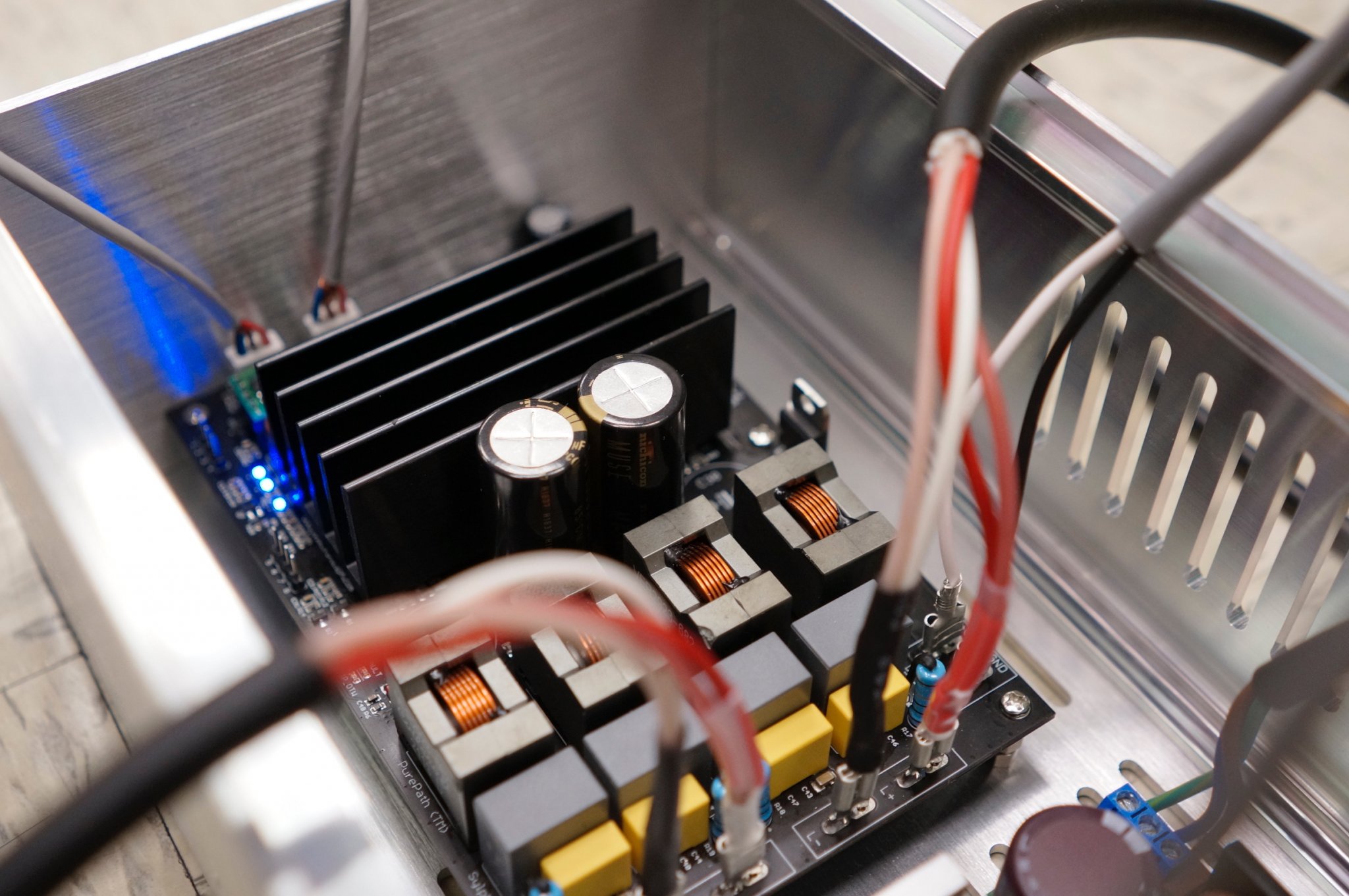

What do you mean about using 0.01mH Jantzen Air Core Wire Coil AWG13, 1.8mm diameter wire as output indutors. There could be an increase of performances?
It might get hot, if you can find the aircore that was used by cdsgames it might be more suitable.
I have a 10uH codaca 1d17a clone here (same looks as the one used in 3eaudio) and I like this a lot.
Coilcraft is more airy but this codaca is "rounder" sounding, all types of music are suitable with this sound signature. I will try this inductor in my latest Sylph-d200 boards to verify.

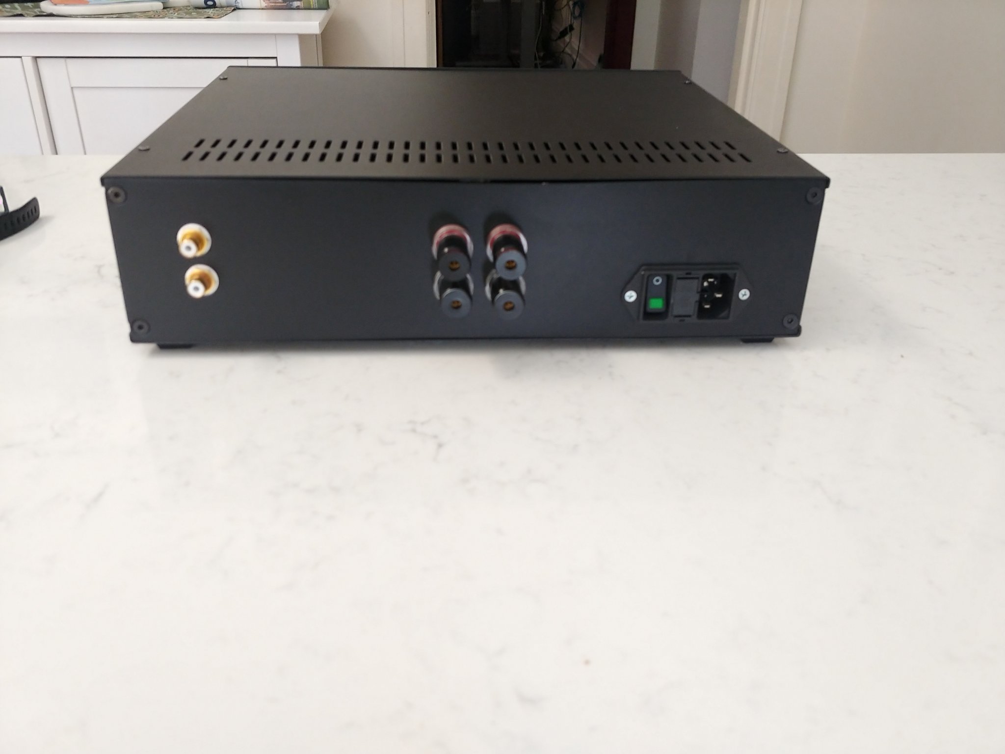

After a lot of stuffing around on my part ive finally got my Sylph D200 built in a modushop case... running 48v from the meanwell. All of the @JLesterP mods performed and it's sounding really great. Massive thanks to Lester for the support. The sound is much more detailed and controlled than the Shui Yuan board although there's maybe slightly less gain. No drama there though...more than enough to drive my moderately sensitive speakers. My layout is perhaps not as professional as others but I'm new to DIY and happy to hear any critique or suggestions. Interestingly the DC offset at the speaker outputs is 3mv for the left and 10.5mv right channel. Perfectly fine I'd have thought, just an observation. No idea what to expect with class D.
All in all I'm super impressed. 👍

What's the reasoning for only using two big output caps....and in those particular positions?
Thanks, Pete
Those are bulk capacitors in AVDD supply actually, not output caps.
Comparing to fully implement with 4 bulk caps, I feel the bass tighter and deeper with 2 caps, and background become silent a bit more. Mine Sylph d200 is TPA3251, I am not sure that TPA3255 may be better with 4 caps.

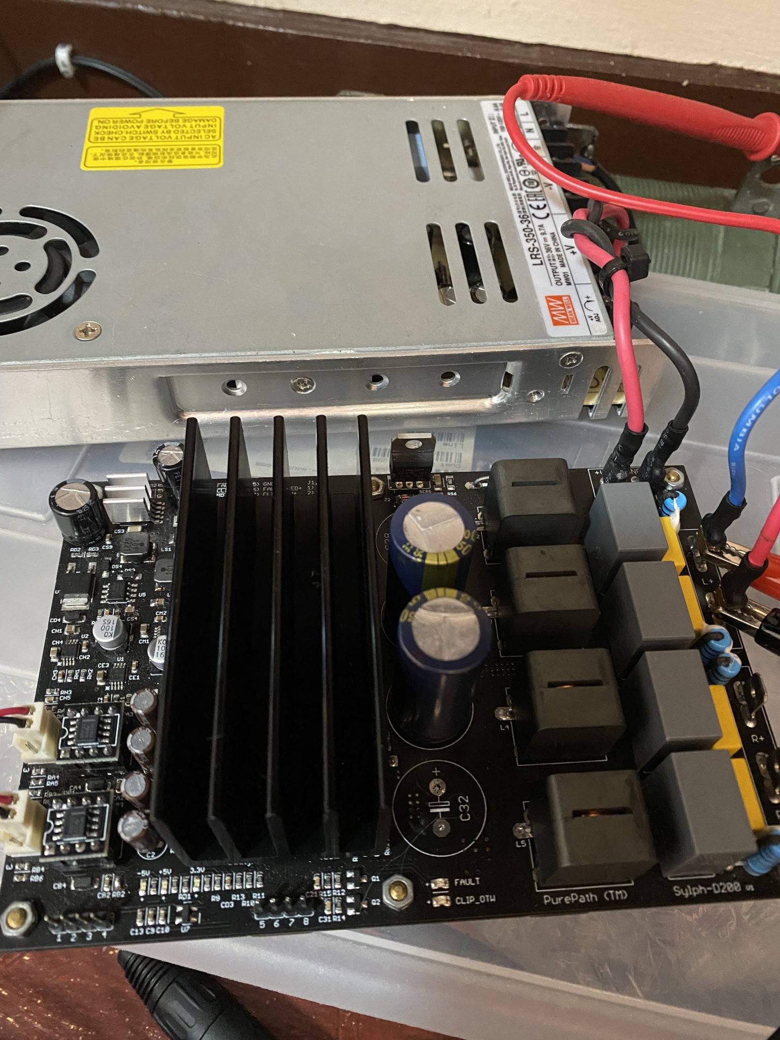

Hi Lester, is there any reason (other then heat dissipation) not to trim the meanwell power supply voltage to the maximum rated 51v on the sylph d200? I assume it may negatively impact the SINAD ? Really enjoying the module but now can’t resist tinkering ! :LOL: Op amp rolling soon as well I think.
Hi, it will affect the SINAD specially on the N part but it will very minimal, so there should be no problem in increasing it to 51V.
Just check if your power supply can do 51V, specially its output cap rating.
Lester

Thanks Lester
I'm using the Lrs-350-48. I haven't checked the output caps but 51v seems within the voltage adjustment range and below the over voltage limit (55.2 volts) ? I've read of quite a few people using the Lrs-350-48 on the tpa3255 eval boards. Still, I'm fairly cautious and don't want to push my luck!
