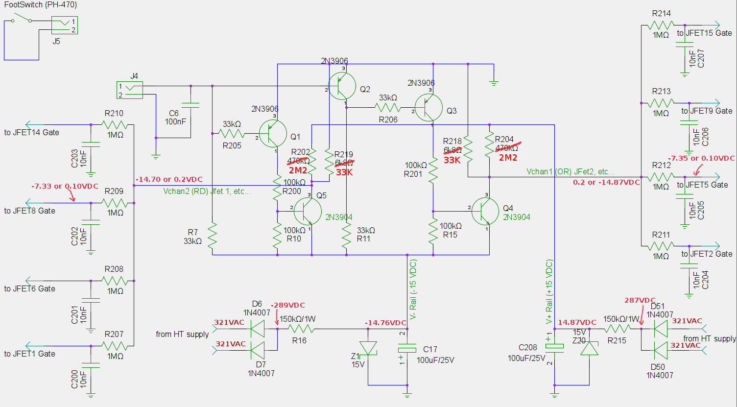

I had a look at 2N5638s datasheet. In the 'Switching Characteristics' section it mentions Vgs=-12 V. Does it mean that I can/have to provide it with more negative Voltage for it to turn off?

Make sure that the zener stabilised supplies are OK under all switch conditions. I would have thought it better to rectify and smooth the HT first and then apply to the zener via a resistor or at least split the 150K witth a cap. You have to have -15 volts across the zener.
I missed to mention that. The V- rail supply was not stable with the 470k-6k8 pairs, but got stable with the 2M2-33k values!
UPDATE:
No, it means it will block peak signals up to the value of the Vgs voltage. Look at my link way back in post #11 🙂
If the sound is distorted then the first thing to do is to simply bias the gates on via a 6K8 and 470K divider (as in your circuit) and make sure the sound is clean. Feed the divider from a clean 15 volt supply. Or just use a 9 volt battery and recalculate either of the two resistors.

I was able to make some measurements while playing tonight. The amp sounds clean only in low gain, meaning I had to have the Volume pot on my guitar to 1-4 to get clean sound. Higher than that, there is distortion.
I then tied my DMM to each channel's JFET gates with crocodile clips and the voltage was swinging from 0.2 to -4 at the ON FET's gate and from -8 to -2 at the OFF FET's gate when i was playing, especially when strumming chords and the low strings(high output).

Try and go back on basics and confirm the conditions are correct.
1. The drain and source points in the circuit that all the FET's connect to should have zero volts DC present. If those conditions are met then there should be no need for any "offset" which would be very difficult.
2. Measure the gate voltage at Q4 and Q5 collectors because measuring on the gates via the 1Meg resistors will not be a true reading due to the small current the meter draws.
I still think there is a problem with the supplies 🙂
Also without a scope and seeing what the peak signal levels are, then it becomes more difficult to see where what is going on and where things are going wrong.

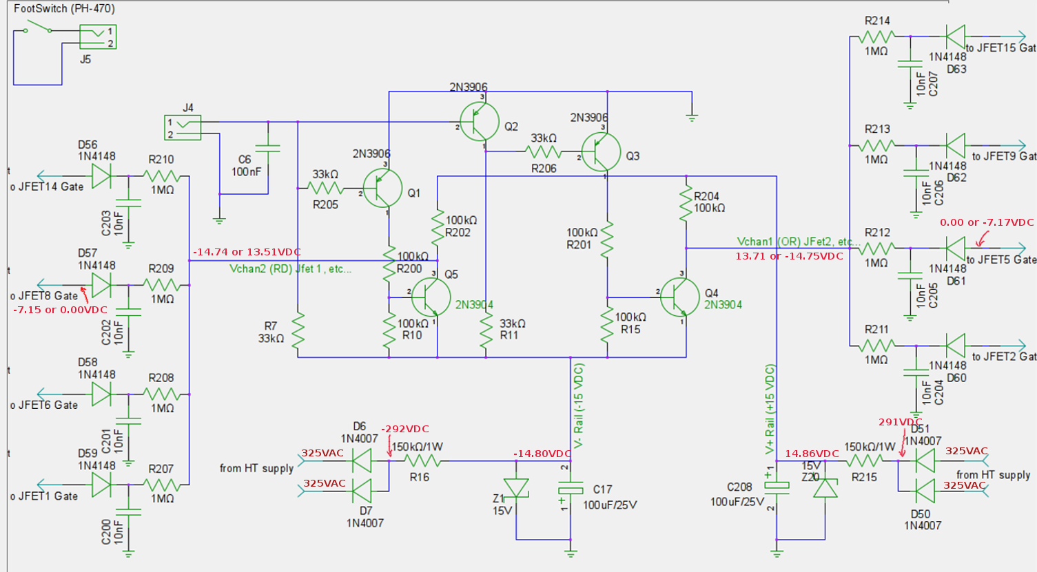

I nailed it!
I was curious this weekend to try out Kevin O'Connor's method which has the following differences:
1. Reversed biased 1N4148s on all FET gates.
2. +/-10 VDC for the Supplies, contrary to the -10/+0.2Vdc I was trying until now.
These 2 changes made the trick. And the experience gained is huge. i haven't really got the whole concept really well but it's a start!

Ok guys, here it is.
Now a question emerges... what if I wanted to raise the gate voltage a bit more than +/-7.15? The thought behind this is to have more headroom...
Would it be wise to change the 1MΩ resistors with something smaller, say 680kΩ? Or is there another way to do this?

Easyone first (hopefully 🙂). The FET gate draws zero current at DC (if the biasing is correct and within limits) so the 1meg value shouldn't matter. 100k, 1meg or 100meg, the gate voltage should be the same although not measurable accurately without a FET input voltmeter (or old type valved VOM).
Hmmm... so the diodes seem to get the desired result. If it works it works 🙂 although I see a "floating" gate now...
Yes, yet as I measured them while playing, the gate voltage changes according to the signal present in the channel! Those 1N4148 are really fast on this! 🙂

I can see how you say the gate changes according to the signal. The gate has virtually infinite impedance at DC so the voltage on the other pins can "transfer" via leakage and at AC via the junction capacitance of the FET.
Its one of those things where you need the working circuit in front of you to probe and test and see exactly what is going on.
