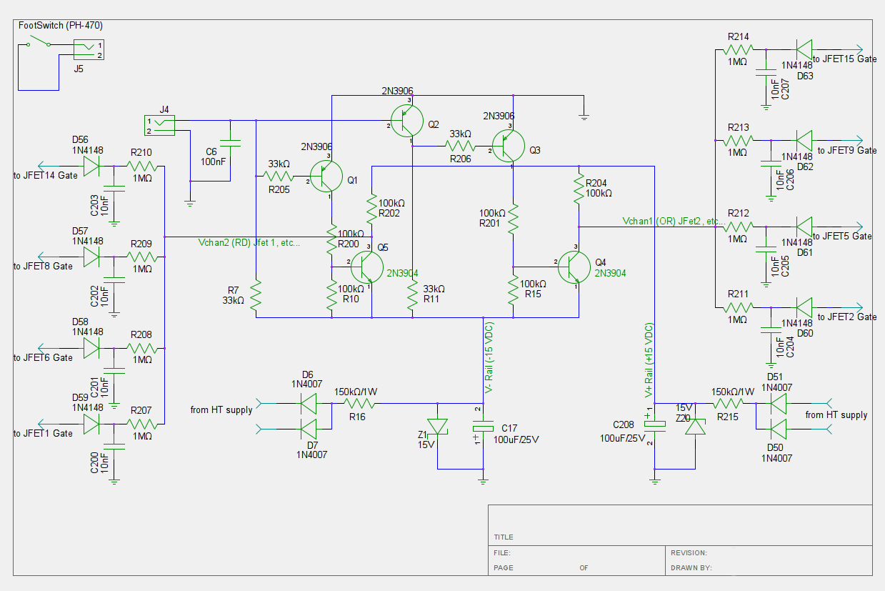

The most important detail to remember about jfets is that they are "normally-on". The function of the switch control circuit is to _actively_ turn the jfets off. The control circuit allows _passive_ turn-on.
For the series switching above, the jfet must be in a low-resistance mode, or 'on', for the signal to pass through. This means the gate has to be at the same potential as the source, and will be so more or less if the gate is allowed to float. The gate diode assures this. However, when the signal goes above ground, the diode will conduct and hold the gate at zero volts, turning the jfet 'off'. To keep this from happening, the cathode of the diode must be sitting at a voltage higher than the signal will ever reach. This is the passive turn on.
To open the signal path, the gate is pulled negative by a BJT - active turn off - and the jfet channel reverts to a high resistance and blocks the signal.
If you read the above carefully, you see how the signal fits within the control circuit voltage window. The control voltages must be higher than the peak signal of any point controlled BUT control voltage must be below the Vgs rating of the jfet.
Why did one poster use +/-7V? Did he use CMOS chips for control or for switching? If so, then he is stuck with that voltage level if he uses CMOS to directly control the jfets. BJTs are cheap and simple level shifters, so whether the control circuit runs from positive, negative or very low voltages, there is no problem to provide the correct gate control range
Have fun

I see. Right now, and as U can see in the latest schematic with the voltages I attached, I have +/-7.15 VDC. So, since I use the 2N5638 and since it turns off at Vgs=-4VDC (correct me if I'm wrong, please) the signal must not exceed ~6 Vpp.
Am I getting it right? 😕
So, how could I increase the control voltage of the control circuit at the gates??

The control voltage range is only limited by the gate-to-source voltage rating NOT the cutoff voltage NOT the pinch-off voltage. You need the gate voltage to well exceed the rated voltage for cutoff if you want the highest channel resistance possible.
Please leave your linear preconceptions of how to use a jfet at the door - this is a switching circuit and the limits and requirements are actually far less stringent. The jfet should be all the way on or all the way off. The RC gate control provides a very quick linear ramp between the two states.
If the jfet has a 25V rating - usually it will be the same for Vds and Vgs - then that is the only spec other than Ron that you need to know or to concern yourself with. This sets the maximum control circuit supply to +/-12V. If you had a 50V jfet, then +/-25V.

The Jfets I use (2N5638) have a rating of 30V. So, if I understand correctly it's the JFET itself that goes to -7.15Vdc during the OFF state and will not go lower, right?
So, if I wish for a larger control window, should I replace them with devices with larger voltage rating? (Which means that I also have to replace the 15V zeners as well, correct?)

If you wish for a larger control window, please read post 134 again, which explains how to do this. The jfet does not limit this beyond what its actual voltage _capability_ is - that would be 30V for the device you specified. The control circuit limits the control range and signal window size.
You need +/-15V control circuit rails.

The thing is I HAVE +/-15V control circuit rails. It's after the 1MΩ gate resistor that it becomes +/-7.15. By what you're saying, changing the 15V Zeners with say 18 or 20V Zeners will suffice for raising the final gate voltage a bit...

Where are your zeners? If they are attached to the jfet or the jfet-end of the control-line series-R, then remove them completely as they are the cause of voltage loss here. They are not required anyway as the control circuit provides protection to the gate.
You may be thinking of mosfets, which require close voltage limiting of their gates. A mosfet cannot be used in a plug-n-play wiring for the jfet in this circuit, but has many other uses in other switching circuits.

It's Z1 and Z20 on the schematic I am attaching, near the bottom. The one we had plotted in a previous conversation. 🙂

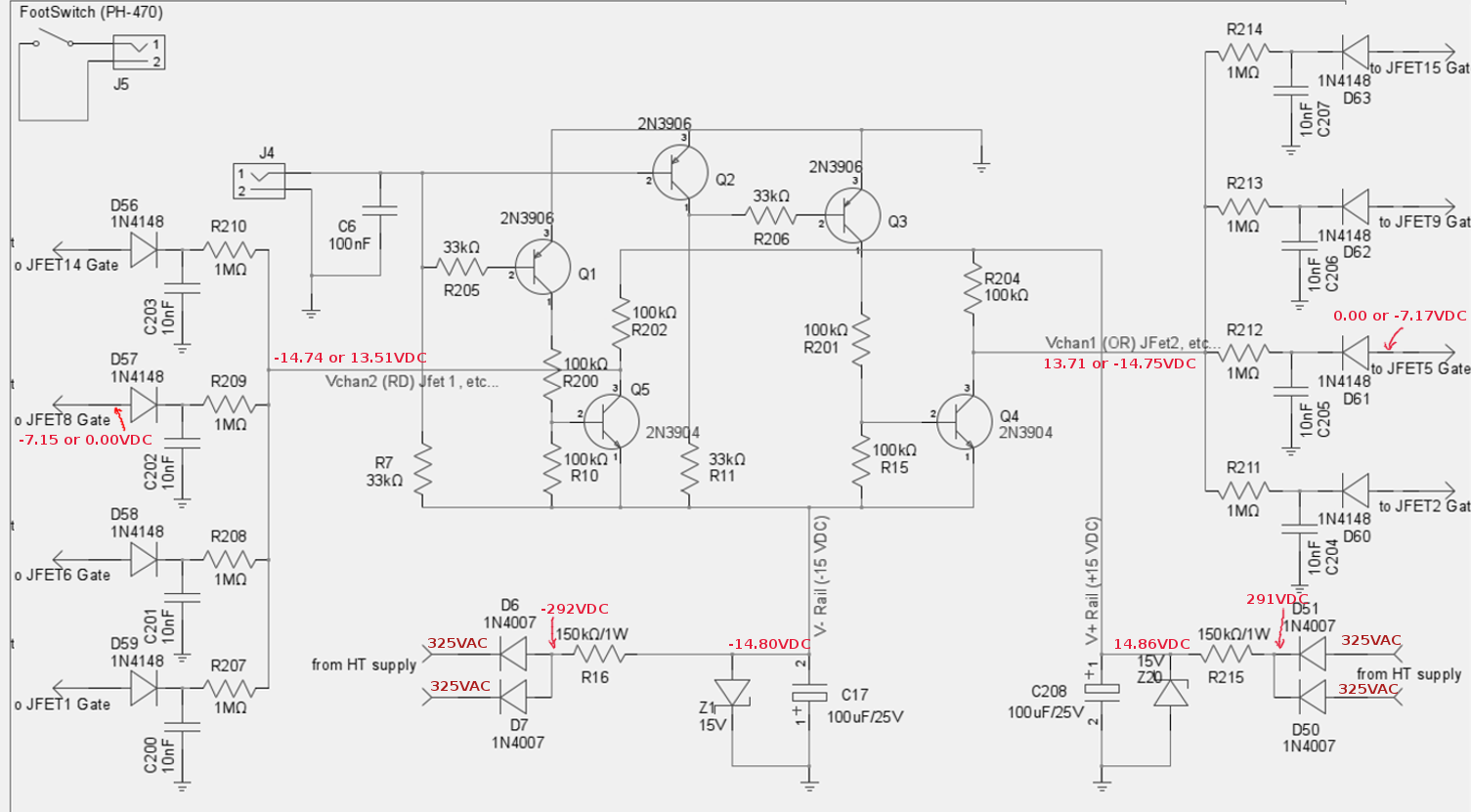

Measure the voltage at the BJT collectors to make sure they are going from rail to rail when switched. If they are not, then the series base resistance is too high and needs to be reduced.
If the BJTs are switching rail-to-rail as they should and the gate end of the 1Ms reads much lower, there is a leakage path somewhere that needs to be addressed. The 10M input of the meter will cause a misreading itself, but by no more than 10%.

Yes, the collectors are going from rail to rail. Checked!
I'll check. The only thing that stands between the 1MΩ resistors and the diodes are the 10nF caps to GND. Just to be clear, I am posting once more the Switching circuit in B&W using red only at the voltage reading points.
Generally, the switching circuit Struth proposed performs correctly, even at high gain situations! 🙂
