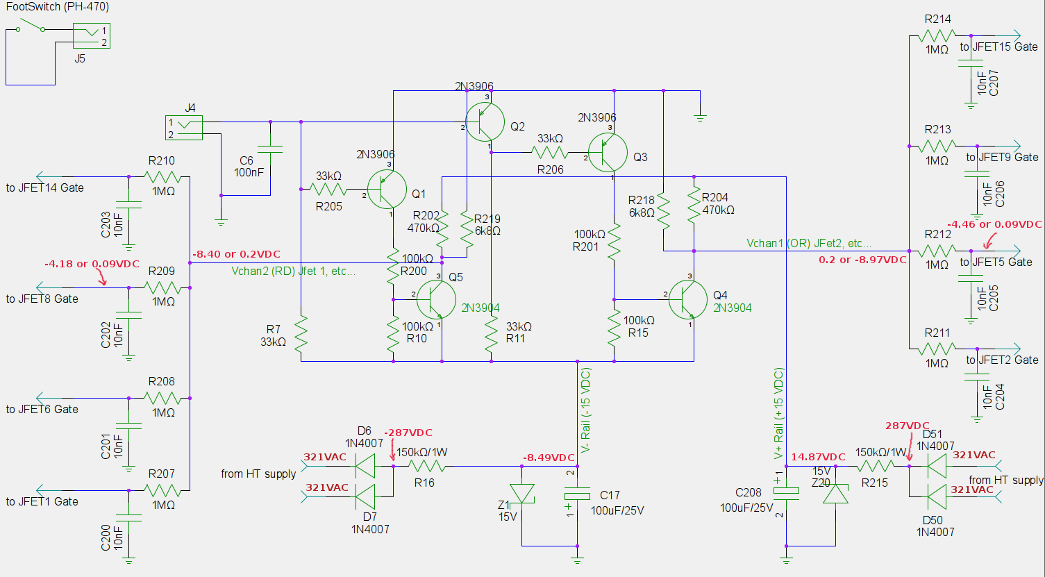

I put 2.2ΜΩ from Gate to Source to all FETs, as I assumed from earlier posts. What I am wondering is if it is important if the JFET's Source (and hence the resistor) "looks" towards the input or the output of the signal... I hope you understand what I mean...

Hello again!
I built the circuit, and measured the voltages. I am attaching the file below.
Some observations:
1. As I understand the FETs cannot turn off completely with -4.2 VDC, right? Also, during the ON state the voltage at the Gate is +0.1VDC, as U can see from the schematic. Can't I just omit the 1MΩ resistor or increase the voltage before it?
2. Something that has me wondering is why I get from the V- rail supply only -8.49VDC, while the V+ rail has 14.87. (Does R7 have something to do with the voltage there?)
Thank you! 🙂
Make sure that the zener stabilised supplies are OK under all switch conditions. I would have thought it better to rectify and smooth the HT first and then apply to the zener via a resistor or at least split the 150K witth a cap. You have to have -15 volts across the zener.
I only had time to run a simulation yesterday, but i found that it's the rest of the circuit that affects V-. Disconnecting the supplies from the rest of the transistors brought V- back to 14.89. Changing the 6k8 resistors to bigger values also raised V-, although I have to keep the ratio for keeping 0.2V. I'll try it tonight.
The supplies should hold up under all possible loading that can be presented.
The cap across the zener can't work as a reservoir cap because the zener clamps the peak voltage to 15v. As the AC cycle continues the voltage can only fall across the cap. If the cap were before the 150K then it would maintain a constant voltage (and hence constant current) across and through the zener. If you were to scope the 15 volt zeners I think you would see the supply isn't clean.
If you are simulating it then replace the zeners and their feed with a constant voltage supply (two 15 volt supplies) and get the circuit to work correctly from that 🙂

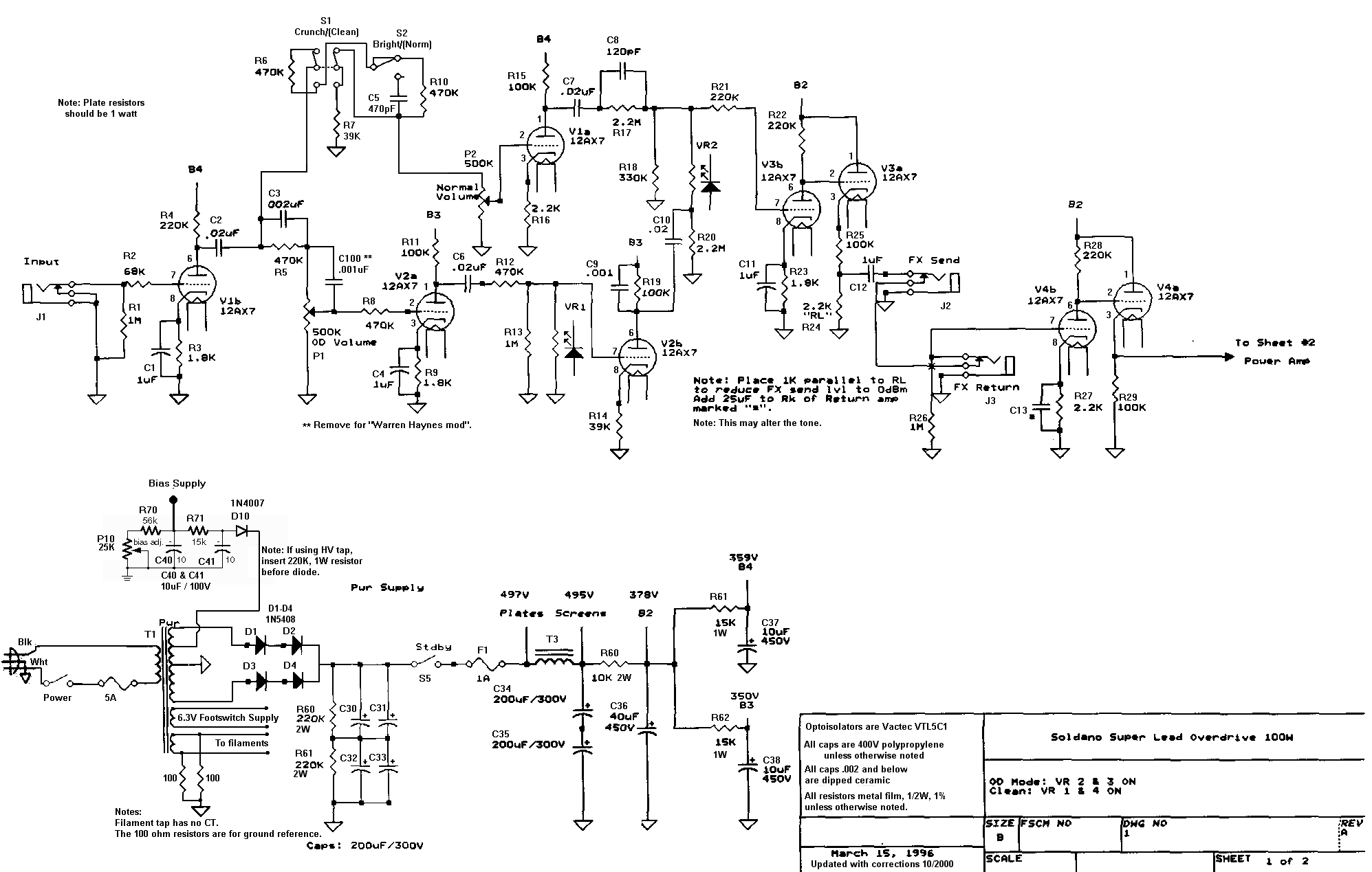

I just found this thread. I see that there has been considerable discussion regarding a fairly complicated fet based channel switching scheme for a guitar amp.
I use simple LDR's. It is a Cadmium Selenide photoresistor and an LED inside a sealed package. LED on... resistance is about 100 ohms. LED off resistance is about 10 meg ohm. They work good for channel switching. The resistance curve is not linear but they are good enough that you can make a channel transition with a pot based foot pedal.

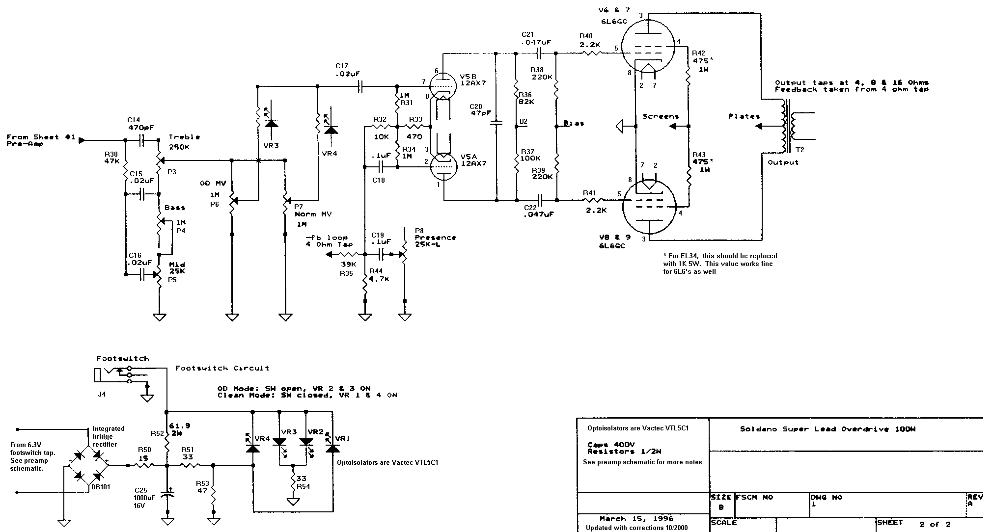

Soldano used LDR's for channel switching in some amps (SLO100). They have one extra stage in the overdrive channel so that the channels are out of phase at the summing junction. This way any leakage cancels.
Soldano used Vactec VTL5C1 which are expensive. I use these:
