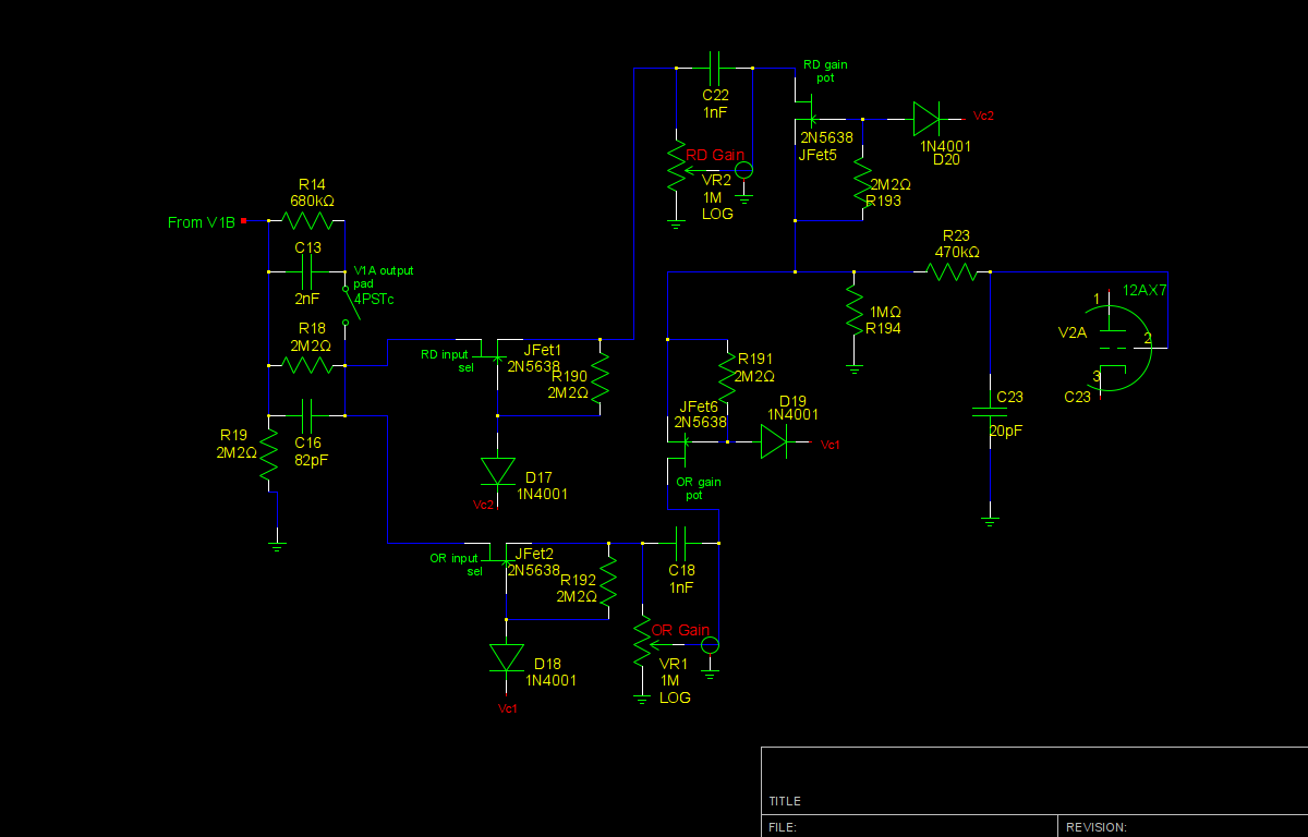

Counterculture, thank you! It's added to my reading list, I am sure to cover a lot of things I am missing. As for the FETs I am using here, they are 2N5638, they belong to the "switches and choppers" class, same as J111, J112, J113 etc. Their ON resistance is at around 10-20 Ohm.
On the circuit I have the Drain facing the signal input and Source facing the signal output. But yes, these FETs are symmetrical.
Mooly said:
You must drive the FET's via a resistor. The diode leaves the gate floating which is no good. Make sure that -14 volts is within the G-S rating of your chosen FET.
Now I get it!
My misunderstanding here was that from 0V and upwards(+) the JFET's resistance would not change, hence my proposal of using a diode.
So, if I get it right, when the JFET is ON (Vc=0V) the resistor will be conducting the necessary offset to the gate.
When the JFET is OFF (Vc=-13) there will be some of the gate's negative voltage present... Won't I be needing some caps after each JFET for not having DC injected to the signal?

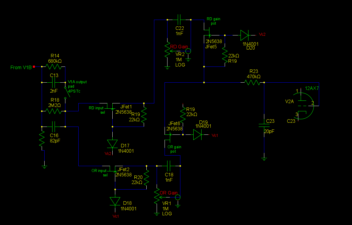

Here is the circuit with the 22k resistors added:

22k is too low resistance. Try something like 2.2 mega ohm or as high as possible, to lower loudness of Thump when switching. This resistor is needed to discharge gate charge, but unfortunately it provides parasitic path for control signal to output. T-configuration as I suggested before would be better in terms of Thumps.
Lets think about this... and I would recommend you try the design before building for real.
FET 1 and FET 2. Is the feed from V1B AC coupled such that this pont is at zero volts ? If so then both these FET's are tied to ground via the 2M2 and the unmarked resistor. The other side of each FET is AC coupled to the next stage and ground referenced again. So far so good. The gates can be pulled low (to a negative voltage) via the diodes.
FET 5 and 6. Not ground referenced on the output side as drawn ? Where does R19 go ? I'm guessing like the other FET's. That still leaves no ground reference. Add a high value resistor from the output of these FET's to ground.
Mooly, he has potentiometers that provide path to ground, but needs some grid leak resistor. But such rough switching on very sensitive input of guitar amp is something I would never consider.
Yes, but no grid leak. That is what I mean when I say add a high value resistor from output of these FETs to ground.
That is what you mean... yes 🙂
I understand... Would a small cap in series with the signal path could isolate the control signal from the output?
Oops, sorry for that. The unmarked resistor is 2M2 too!
Oops again. Yes, R19 is like the other resistors.
Ok, how about this? 🙂

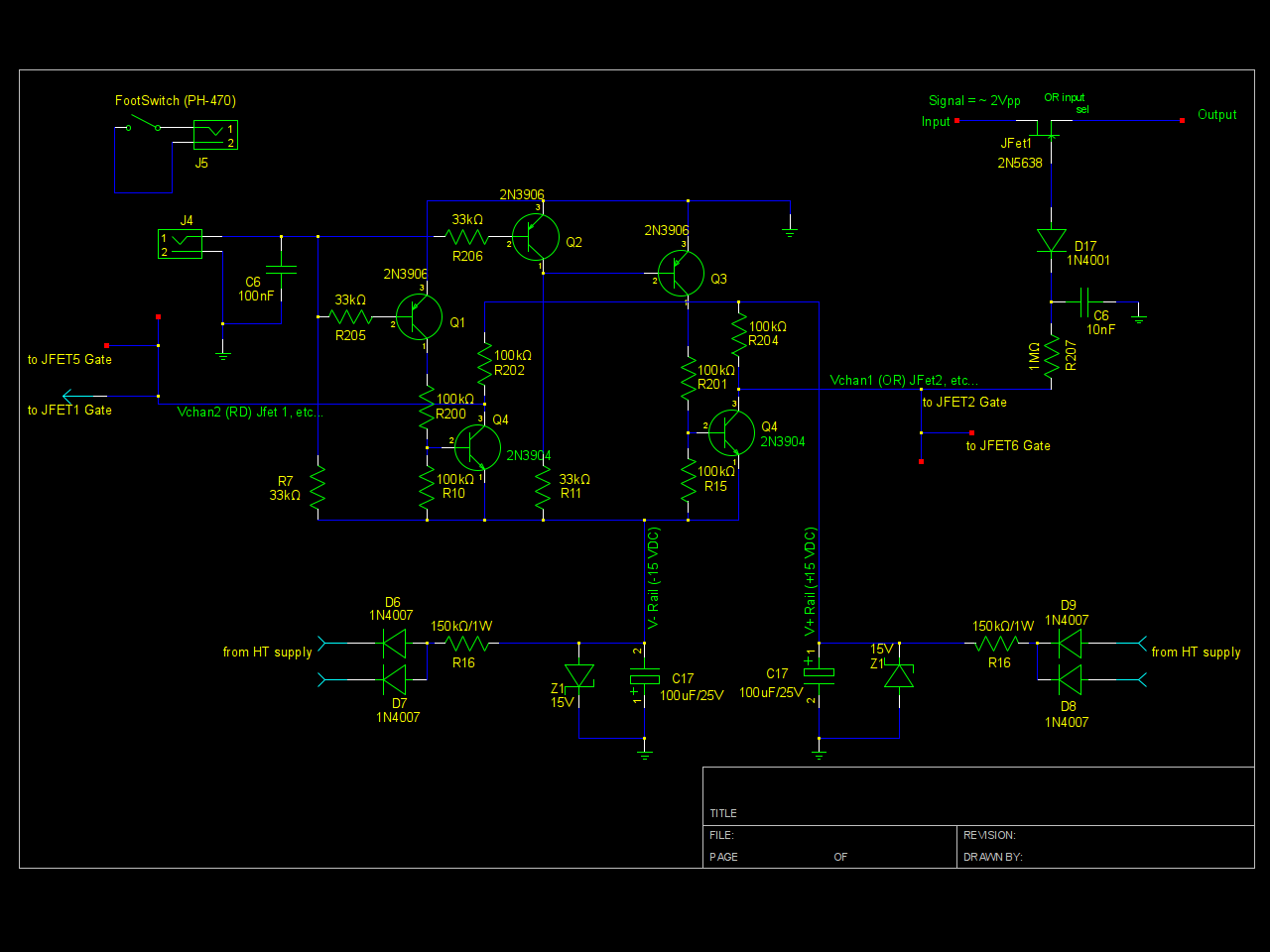

By the way, I got in touch with Kevin O' Connor from London Power in Canada. He told me I should have a split-rail control voltage of both polarities, say +/-15 Volts. This would allow the audio signal to live within the control range window...
If by control volts he means the gate drive voltage then I don't agree. Look back at this,
http://www.diyaudio.com/forums/soli...-amplifier-designed-music-11.html#post1569428
It is a similar arrangement to yours. The input is AC coupled and both sides of the FET are ground referenced. As soon as the gate voltage goes above around 0.2 volts (relative to ground) then the FET G-S or G-D junction (depends which way round you have the FET and for these types it really doesn't matter as they are symetrical) will begin to conduct and DC will appear on the output. Just what you don't want. So the positive "on" voltage has to be kept lower than this value. The negative "off" gate voltage has to be more than the peak voltage you are trying to block.

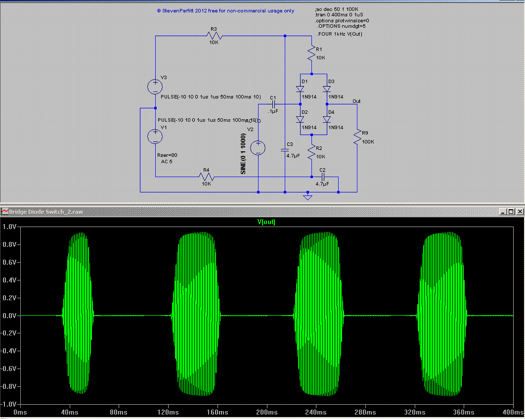

Not trying to hijack the thread, but wouldn't a simple diode switch work as well?
The standard switch would introduce transients on turn on and turn off, so use RC delay to slow the switches down.

True, but I think that's where the reverse-biased diode at the gate comes into play.
Anyway, I'll ask him for more details and get back to you, this is very interesting!
I would have to see it drawn out fully 🙂
Your diodes labeled to Vc1 etc (I have assumed) go to the control voltage for the FET. They don't clamp the voltage at all.

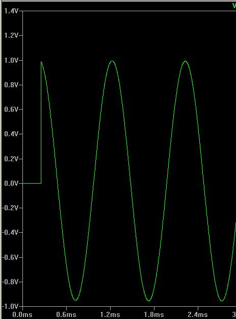

I guess a better description would be abrupt turn on which will translate to a step function of the output to the level of the input signal at turn on. I expect this to behave like a transient to the system.
For instance if a clarinet note was at a peak value of 1V at turn on, the drive to the amp would appear as a 1V step function followed by the ensuing sin wave from that value on.
I don't think it would be very pleasant to hear.

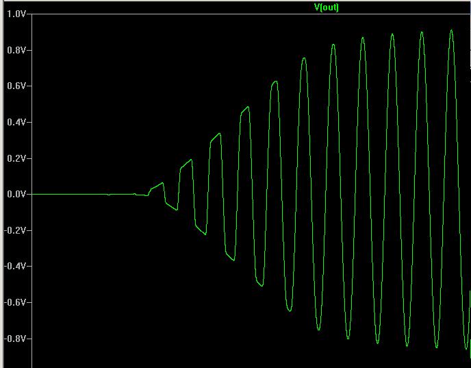

The on waveform looks surprisingly clean I must say. Much better than I would have thought tbh.
Transients and switching a signal at anything other than zero volts causes abrupt changes in levels heard as clicks and thumps. Thats a problem facing any switch, electronic or mechanical.
