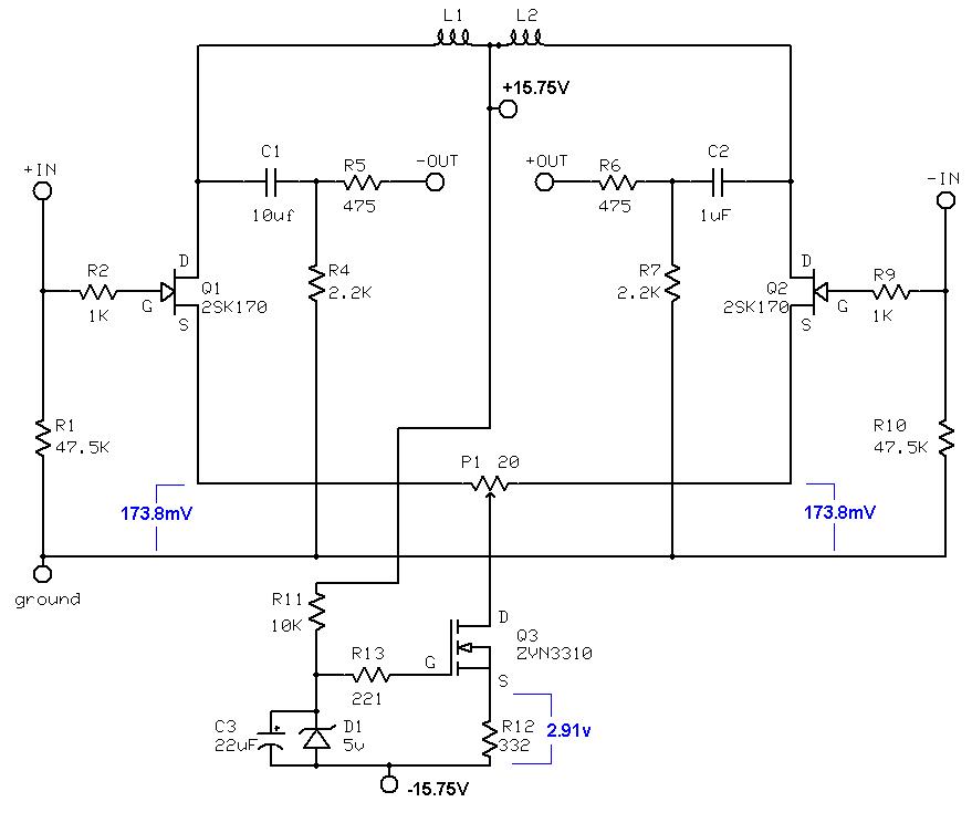

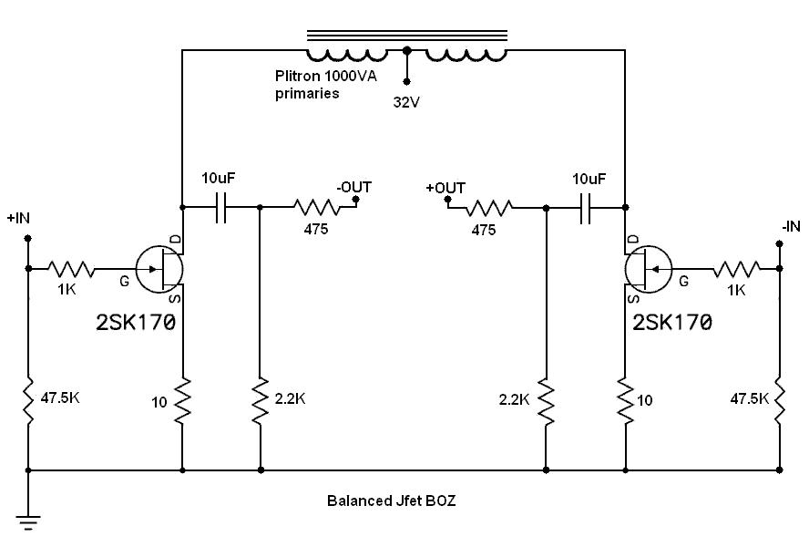

I completely removed the audible noise in the horn; you'll notice that the unused output is given a cap and then taken to ground with a 2.2K resistor--so, the balanced modification I made in the prior post works better like this:
That's very nice. If I may:
Try increasing the value of the Source resistor on Q3, raising the
voltage driving Q3 for more current through Q1,2 (up to 10 mA
each), and RC filtering the drive to R13 to remove zener noise.

I'm reading your suggestions two different ways:
Are you saying that raising the Source resistor on Q3 raises the voltage driving Q3? Or, are you suggesting that I perform three things:
1. Increase the value of the Source resistor.
2. Increase the voltage of the negative supply.
3. RC filter the drive to R13 (terminology is a bit above my head).
Regardless, I'm going to explore your suggestions any way I can.😀
Honest, Choky, I haven't been copying your ideas!😱
I think I'm supposed to raise the gate voltage to the CCS, this in turn requires that I raise the source resistor to maintain proper current.
At least, this is what I did earlier this morning.
But, after some mental tampering, I lowered the value of the zener in order to lower the left-over voltage, which allowed me to run a lower value resistor, which I thought (incorrectly perhaps) was the thing to do.😀

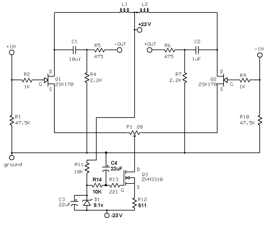

carpenter said:
I increased the value of the Zener and raised the CCS source resistor:
John,
You can halve the Source R value of Q3 to get double the CCS current that you have. Each half of your circuit will then get close to the NP recommended current. You can monitor the voltage across the jfets D-S as you adjust P1 to balance current draw after warm-up. By putting a high series R with the zener before the Gate R junction plus the parallel cap you have should effectively filter the zener noise.
Blues said:
John,
Hi Blues,
I thought I was to raise the source resistor's value--but I will lower it as you suggest to hear what there is to hear. Currently, there's 4.4mA current for each Jfet. I thought Nelson suggested 10mA per jfet as a "range" i.e., not to be exceeded.
Are you suggesting that I parallel a resistor with the zener and cap? I'm apologize for being a bit thick-headed.😉
BTW, with the mods in my last drawing, the amps sound very pretty--silky--smooth as a baby's behind.
carpenter said:
Hi Blues,
BTW, with the mods in my last drawing, the amps sound very pretty--silky-smooth as a baby's behind.
woodie
on your last schm :
I= (Uzener-Ugs) / R
so :
I=(9V1- 4V) / 511 = 10mA
you can always presume that Ugs is ~4V and correct resistor value later
so - if you use greater neg voltage , you can also use zenner with greater voltage (say 27V , whatever) and calcualte adequate resistor .... (watch at dissipation of that resistor) ...... that way you increase dynamic resistance of sayed CCS
put 10k resistor between gate resistor and zenner ; put cap from gate resistor to gnd
carpenter said:
Thanks Choky. So, I'm going to try something like this:
good for start
try that cap from gate in both ways - as in schmtc and also routing it to minus PS ........ and choose what's better for you
you can also tweak gain of stage adding resistors from both sources to trimpot , in purpose of source degeneration
decrease reference resistor in CCS , in purpose of increasing current through jfets ; if you have BL or V iteration - you can go up to 10mA per side , as Papa wrote ;
if you have J310s (cheap as drek) , you can go all way to 12-14 mA per side ...... listen and decide ( if you don't have any , or it is to much fuss to purchase them - use :Pumpkin: ones ; in case that you burn them , I'll send you new ones for .......... coffee on next BAF
if you don't need much gain (say - 2 to 4 times) , you can make little SUSY of it ( you know how ? :clown: )
and - yes - you can try ( and like ) cascoding those little critters ; just copy what you see in :Pumpkin:
