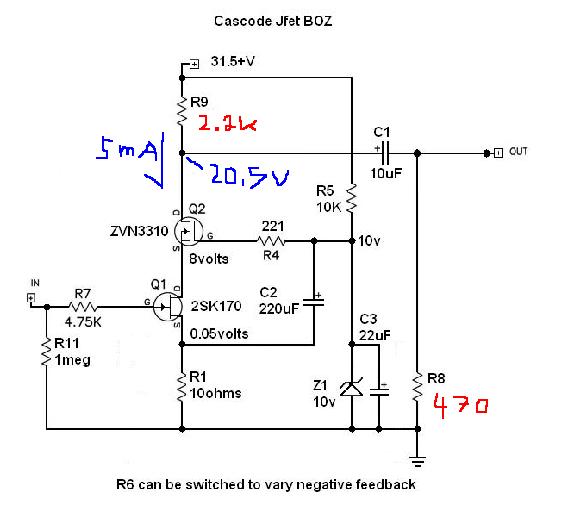

I tried it! I connected my Plitron secondaries to R9. I ran 32+ voltage through one secondary lead--through the center tap--out the other secondary lead, and into R9. R9 = 1k and the voltage at mosfet drain is 26.5v. Voltage between fets = 8v.
It's louder, not just ghost-in-the-attic louder, but full and loud! I don't hear distortion either...but with my ears😉
Where to go from here?😀😉

Same choke load, and I've dropped R9 to 500ohms! The drain's at 29volts! It sounds even better.......I'm going to drop R9 even lower.
Hi Carpenter,
I believe you like the sound at the lower gain.
Ok, then . . . Remove the coil and change R9 to 2.2K and R8 to 500 (or 470).
You will get the drain voltage of 20.5 and voltage gain of about 5.
How to estimate the voltage gain?
Bias = 5mA
R(load) = R9//R8 = 2.2K//500 = 407 (output impedance)
R(source) = 10
R(ds)j of JFET ~ 25 at 5mA bias (datasheet)
R(ds)z of ZVN3310 ~ 200 at 5mA bias (datasheet)
Then voltage gain = {R(load)/R(source)}*{R(ds)j/R(ds)z} = (407/10)*(25/200) = 5
What is the result?
If you have max 2V peak at the input, you will get 10V peak at the output.
As the output impedance of your pre is 407 ohms while the input
impedance of F4 is 47K, the output voltage of F4 will be also about 10V.
Then, the music power at 8 ohm load will be 10^2/2/8 = 6.25W.
Isn't it enough for your lovely music power?

Thank-you for all this information, Babowana!🙂 I'll have to pull this aside and give it further study and consideration.
I don't fully understand the symbology on that last sentence. Care to elaborate?

The choke loaded cascode is a lot of fun! It's more of a stand alone unit with the F4--when I coupled my electronic x-over I heard quite a bit of hiss. When fed a signal from the receiver (bypassing the x-over) it sounded perfect. Maybe there's too much gain?
carpenter said:
Ahh... 10^2 means 10 squared. Gotcha! So 100 divided by 2 = 50 divided by 8 = 6.25. Cool.
to decrease gain - decrease source resistor of jfet

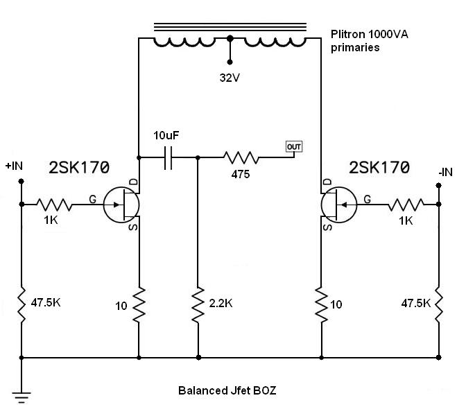

I'm going to order a pair of chokes from Nebraska Surplus Sales. They're rated at 0.7H, have around 30 ohms resistance, and easily handle 5mA. At $15.00 a piece, it's a cheap experiment. Best of all, they're small--on the order of 1.5" x 2".
I'll keep ya posted on my progress.

I had a bit of hiss from my horn--probably because I fed an unbalanced circuit from that of a balanced. I designed this little fix; it works flawlessly.
I'm so amazed at the gifts Nelson has given us!😀
Edit: I matched the jfet in situation--I just measured the voltage across the source resistor and swapped out transistors until I had a match. So simple. The sound is smoother, very clean, slight increase in gain.🙂 The unused leg can be utilized at a later date when I couple a pair of F4s for the midbass! Bit-chin' 😀
