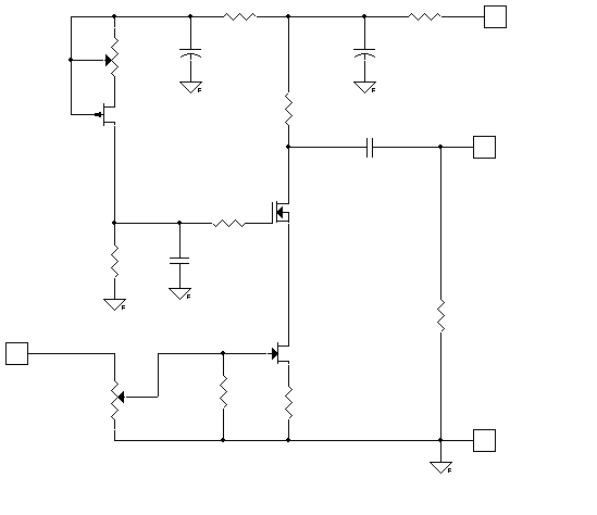

I'm thrilled with my JfetBOZ. It's currently acting as a line-stage in front of my F4.
Of course, Nelson has given us many examples of how to modify, and (hopefully) improve a circuit. I'm going to breadboard this CCS to my JfetBOZ. I thought I'd share my idea; perhaps someone out there has thoughts or suggestions they'd like to put forth.🙂

it's easier , better because of bigger dynamic resistance (maybe even better noise -wise) to implement other sort of CCS .......... say - CCS from toob boyz P10, Geek and others , or two bjt ccs which you can see in Bab and Pumpy .
besides that - if you want to use CCS there - you'll either lift source of jfet too high , or bottom CCS .......... same thing called with different names ......
point is that jfet need adequate voltage between S and G for defined current ; CCS need some voltage to breath , and that's certainly not so small voltage - which Jfet need between S and G .........
so - conclusion - Jfet gate stays at gnd potential , but tail of CCS must go lower ...............on negative voltage
look at ccswhatever bosoz , cascoded or not and than say what you saw 😉
EDIT:
well - I didn't even mention gain issue .........etc
maybe is better to relocate CCS up , and then - choosing adequate source degeneration resistor ........ set desired gain
carpenter said:
Looks like I have more homework.😉
go to last third of Pumpy developing/amusing/musing/maki'funofit thread and look for schematic of thing, with voltage values in it ;
I drew that for crazy danske Lykkkkkkk , one of many times when he was in trouble .
there you can see few important things ;
or you can try Papa's cascode pdf
or you can go to Borbely's and look for his papers regarding line stages ...... "...frontiers" stuff .
are you familiar with toobz?

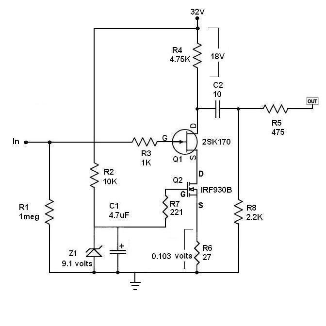

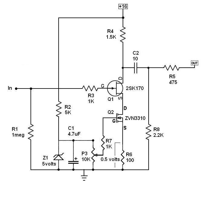

Carpenter, I'm not sure what your trying to do 😕 But, I've been building up the thing below. It's nothing new but it has the capability of enough voltage swing to drive an F4... Or, provide line level voltage swings with great headroom 😀
Sweet. It reminds me a little of the original Zen amp dressed up in Jfets.🙂 🙂 🙂 How about posting some values?
As far as what I'm trying to do--I'm exploring!😀
