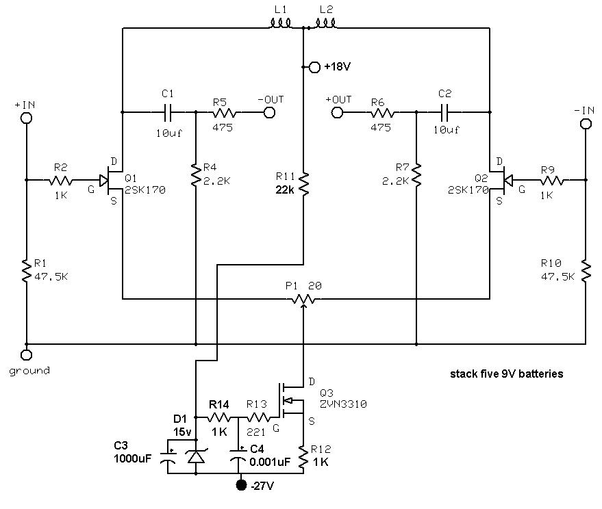

Isn't a 1000 uF for C3 too much? 100 uF should be enough. Other than that, it looks fine.
By the way, besides using transformers from the scrapped microwave ovens for L1 and L2, what would be the minimum acceptable mains transformer size that could be used as a choke? Will a 220v/12v 1 A one be sufficient?
Somehow, I get an impression that choke loaded amps and preamps sound better than resistor loaded ones? Or, is it just a delusion?
If you were to replace the 1 kohm drain resistor on the original BoZ with the choke, will it sound better?

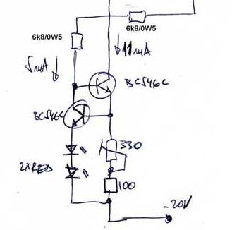

I wonder about Zen Mod prescriptions about the "tail voltage " of the CCS, and especially concerning the zener value,:
should we understand that for a given voltage of say 27volt tail(the neg psu)
the zener used has to set greater than 5v on the source resistor, Nelson set about 10V in his schematic...but if the current that has to be set by the CCS is fixed, as well as the neg voltage PSU then this means that the CCS transistor will have less VDS than it would be with a lower voltage zener and then what could be taken as a rule in that matter? I mean give 2/3 of tail voltage to the CCS transistor VDS and 1/3 to the source res?

http://www.diyaudio.com/forums/showthread.php?postid=951277#post951277
not exactly covered entire issue , but few rules of thumb ......
download these files and read , can be handy
edit :
word-game .......... :
resistance ........multiple.........xconductance.........dynamic impedance........... etc

1000uF is an interesting idea that I will try. Babowana is pretty sharp, and if he thinks something sounds good, it's worth a try.
Nelson mentions using a 1H spool of wire in his prior experiments with excellent results. He was flowing several amps and we're only using 5 to 10 uA per side, which means to me that there's little chance for saturation. I'm going to surplus sales of Nebraska for some of their light-duty chokes--very reasonably priced, I might add.
I like the sound of a choke loaded transistor--it seems more dynamic to my ears. Of course, I'm hard of hearing in the upper register--to someone with normal hearing, it may sound all wrong. 😀

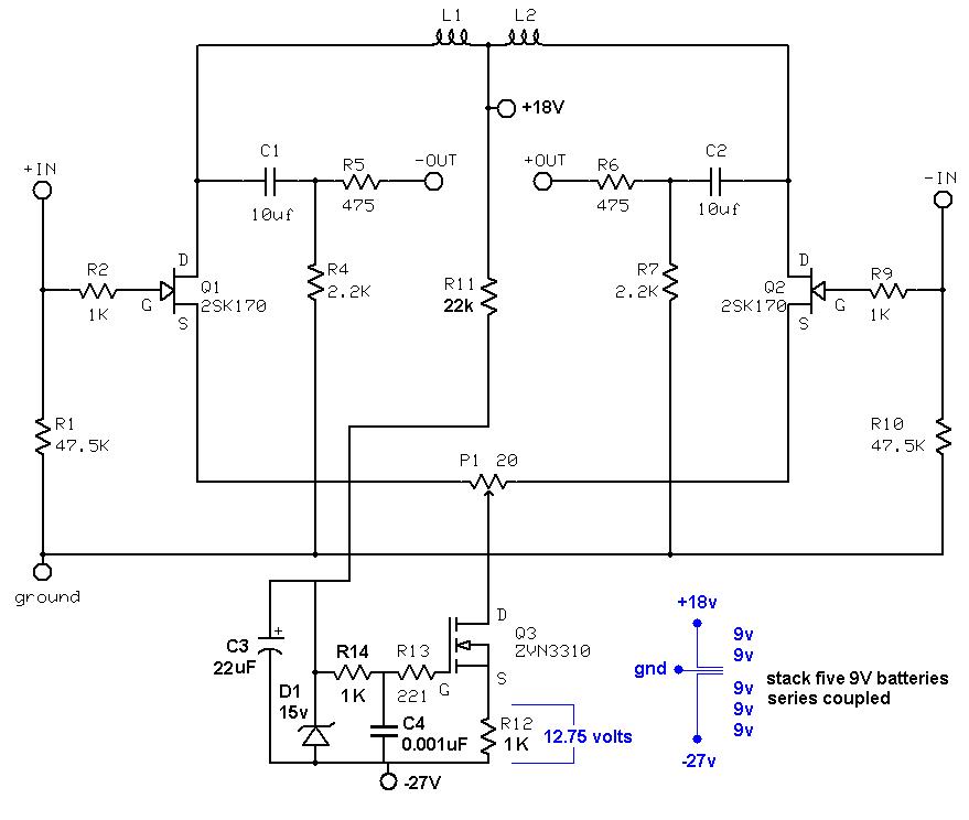

Wow. I followed the latest schematic. The sound is very very nice!🙂 😀
I left C3 alone (22uF) but proceeded with all the other changes.
Wow. I'm so sold on this design. I'm also sold on batteries. Talk about a quiet power supply!😀

Vix said:Isn't a 1000 uF for C3 too much?
1,000uF cap is a bit more expensive than smaller size.
But, it provides better RC filtering and smoother start of the amp
when we use PSU from the wall power. Of course, we could
compromise its size reflecting the partner R value . . .
