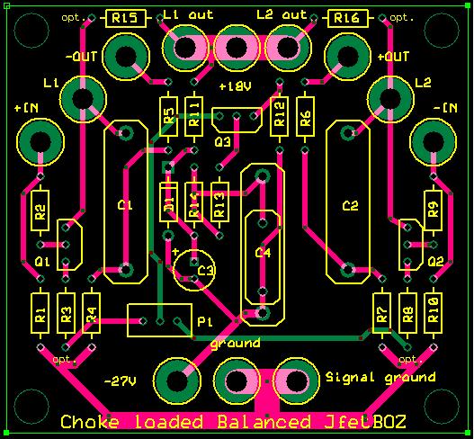

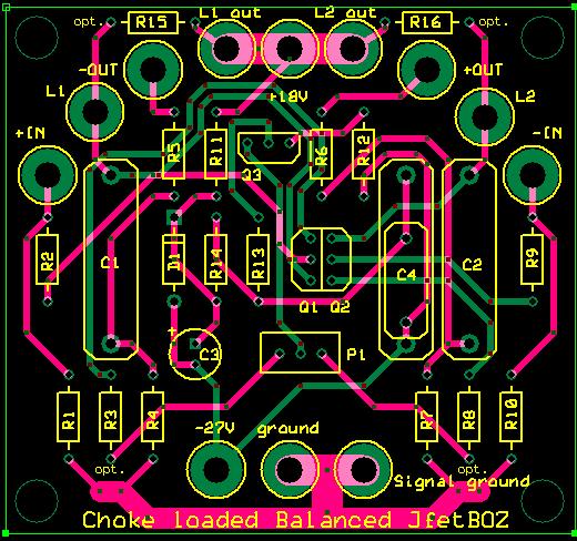

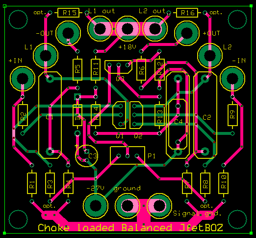

If this is the case, it sure makes it easier to keep the pcb traces looking tidy. I rerouted the pcb to allow thermal contact of the jfets and, let-me-tell-you, what a pile of snakes!😀 I made it work, but oh it ugly....

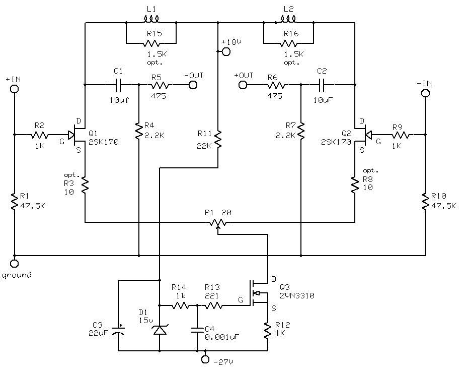

John, May ask a few questions? and give you a few ideas to think about?
Your input connections are right next to your output connections. That is generally not a good idea. Try to give them and any traces they connect to more seperation.
C1 + C2 would be huge capacitors in reality, 10uF Films??? That footprint does not look big enough.
It looks like you have included R15 + R16 as optional R loads for those who don't like the L Loaded idea??? Good...
On the schematic, R12 at the -In is R10 on the layout??? Otherwise there are 2 R12s??? Maybe it's the res of the pic???
Speaking of Rs, R3 and R8 optional??? Also, It is always a good idea to "bypass" a pot with some R in the case the pot opens up or has intermitant contact while adjusting. It will make big transients in your system, amongst other things, if this happens.
I would use + and - 18V rather than the -27??? (Hmmm, 4 - 9V batteries?)
Hey, I might just want to help you reduce your cost on these boards too. I'm good for a few... lookin good...

Thanks flg.
I'll implement the mods you suggested.
I believe that the footprints on the caps are 8/10 of an inch. This pretty much fits the Panasonic film caps. I'll double check that too.
I'm not running R3 and 8 in my breadboard experiment, but wanted to allow for them on the pcb--to opt out would simply mean using a jumper. I happen to have 20 ohm pots and didn't want to order 10 ohm. Your protection idea makes sense; I'll be ordering 10 ohm pots and 5 ohm resistors.
You hit the nail on the head with my addition of R15 and R16.

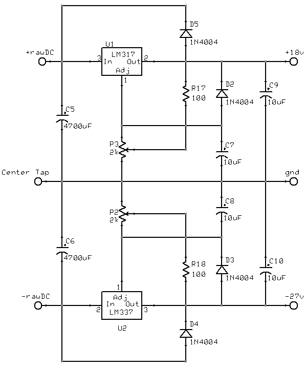

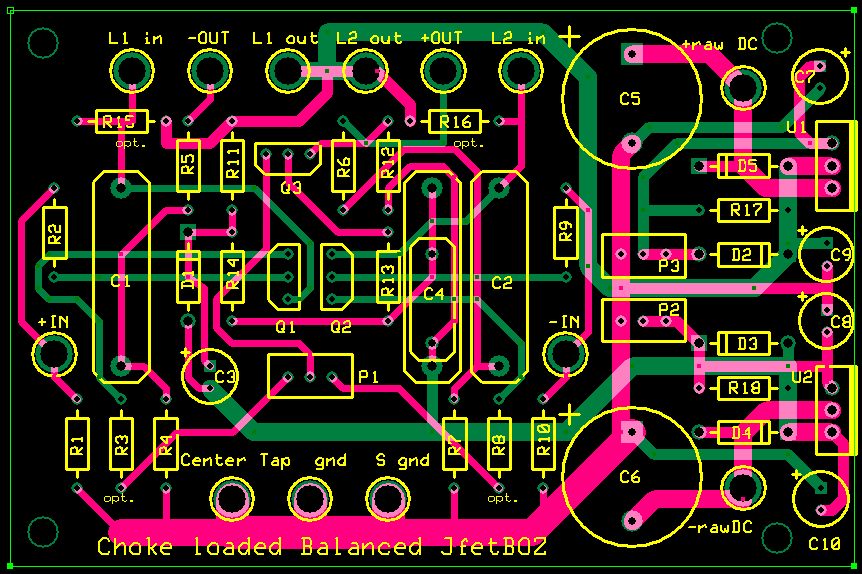

I'm including the most current set of schematics that the pcb is linked to.
Perhaps less negative voltage is OK, I just wanted to make certain that the bottom rail was sufficient. I'm using three 9volt batteries on that section. 18-0-18 volt power supplies are easier to find. I'll disconnect one of the batteries and listen.

Wow! That has become quite a busy board in a hurry. Very nice. What is the needed voltage on the input side?
DaveM said:Wow! That has become quite a busy board in a hurry. Very nice. What is the needed voltage on the input side?
Thanks for the compliment, Dave!😀
To be quite honest, I'm hoping to use the voltage source that the F4 employs. The regulator is adjustable, so I can dial in whatever voltage sounds best for the jfet combo.🙂
