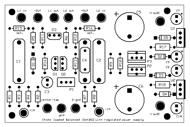

Well, I broke down and ordered three pcbs from Express PCB. $60.00 for the initial prototype--what can I say, I like plated-through holes.😀

They're supposed to arrive this Friday. With any luck, they'll work and I can button up my F4 project.
What an interesting day and age in which to live. Five years ago, I wouldn't have dreamed of using software and the Internet in the designing and ordering of pcbs--it's a very cool aspect to this generation. I wish I would have known about this stuff when the Aleph-X was on the table.
I guess the best part of this process is that with the help of this forum and the highly intelligent contributions of upper-class type brains, I can finally create something of my own.🙂
Thank-you, everyone!
