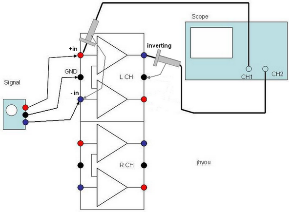

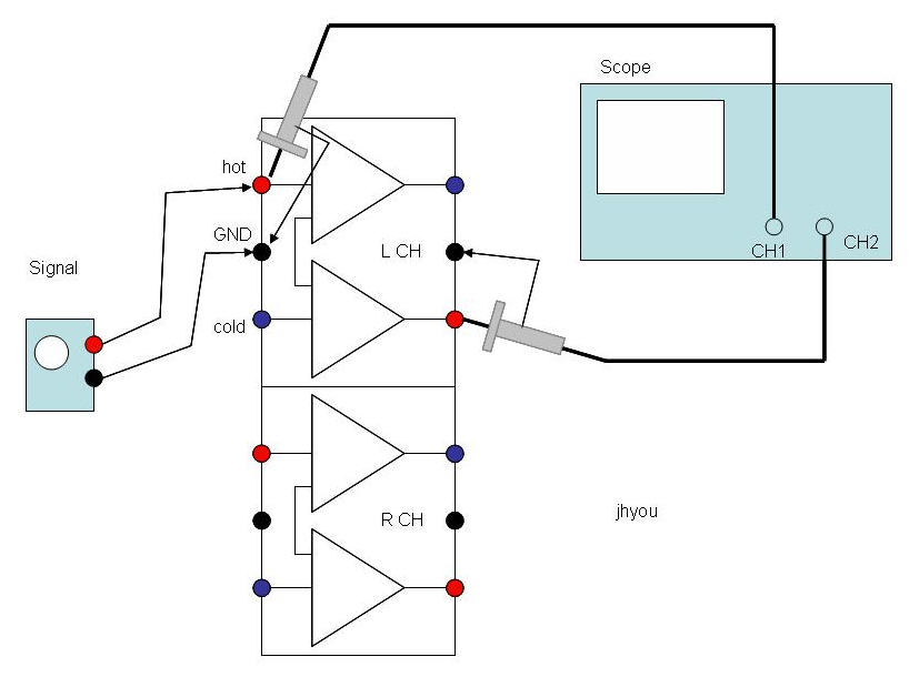

I usually measure Vi and Vo as shown for unbalanced-in and balanced-out at different frequencies:
V gain = Vo/Vi x 2
Then, I could reasonably estimate what is the V-gain at each frequency
and how the gain curve varies along the frequency axis.

Babowana said:I usually measure Vi and Vo as shown for unbalanced-in and balanced-out at different frequencies:
V gain = Vo/Vi x 2
Hmm . . . the forum refuses attachment of my sketch having size of 37kB. Why . . . ? Because there are too many OTs?

Babowana said:
It does not matter of unbalance-in or balanced-in.
It makes a huge difference, with my system, where I place the input probes. The input voltage is double when I probe the + and - inputs together verses + and ground.
I'm not happy with the fact my x-over's minus output has twice the voltage of the positive output.

carpenter said:It makes a huge difference, with my system, where I place the input probes. The input voltage is double when I probe the + and - inputs together verses + and ground.
We are going to check V-gain.
It doesn't matter whether we use balanced or unbalanced input.
The unbalanced output devided by the input (balanced or
unbalanced) gives us the v-gain.
Hope you will check also at lower frequencies . . .

carpenter said:As per my last post, does my measuring process seem correct
with the volt/ohm meter?
I guess your scope has eight divisions vertically.
Just adjust for both channels to have the same volts/div setting.
And, trust the results coming from the equipment.
For example, If the volts/div setting is 5 volts,
then each of the eight vertical divisions represents 5 volts.
Meanwhile, if you use different v/d settings between two channels,
then put out your HP calculator to practice math with
the different scaling factors.
Oh . . . I’m assuming that you set the both probes to 10X.
Otherwise, you need another practice of the math with
