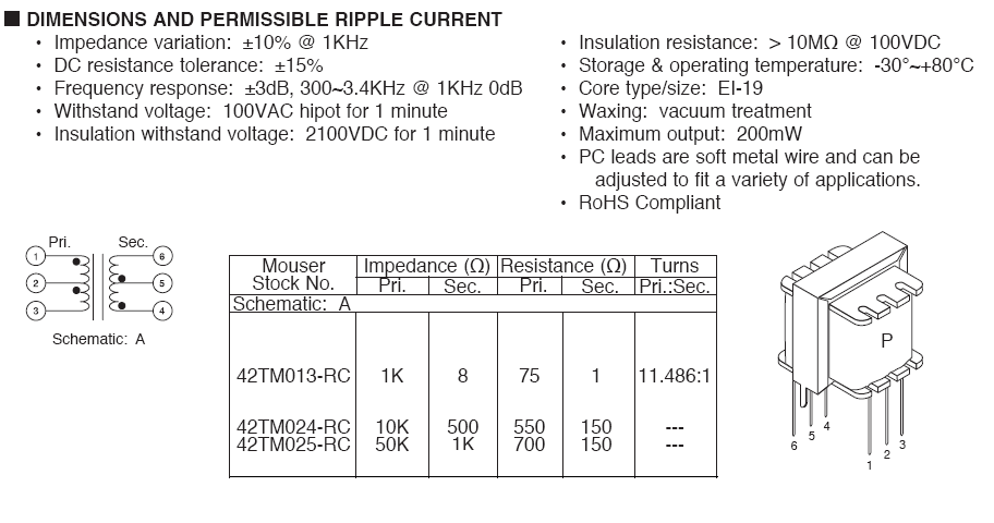

Here are the three inductors I ordered today from Mouser (there's so many ways to play with these things):
I've played with the 42TM025 so far. It has 350 ohms resistance on each primary leg; it also has 4H on each leg!
I lost nearly two volts output--down to 6 volts out. It seems to perform well; the upper sibilance hasn't diminished. My ears, I know...😀
Sine wave appears normal at 1000hz. I'll get back with more info when collected.
BTW, these are tiny critters, less than 2.5 cm in all directions.
carpenter said:
...42TM025 so far....
What else do you have in mind ?
carpenter said:
... It has 350 ohms resistance on each primary leg...
You use this number in your DC calculations
carpenter said:
I lost nearly two volts output--down to 6 volts out...
Just what is the voltage at the drain? It went up???
carpenter said:
...Sine wave appears normal at 1000hz...
The spec says 300-3.4kHz? this could be a problem???
I have 5 other combinations using the three transformers I listed.😉
How would I use the choke resistance in my DC calcs? I just assumed that what is--IS.
The drain voltage was 7.8 volts, it's down to 6+ volts. Still sounds great, but without the monster Plitron in the background. Now the Plitron can resume its duties of supporting the foundation in the SW wing of my house!😀 😉 😀
Specs only apply to transformer application, not choke.

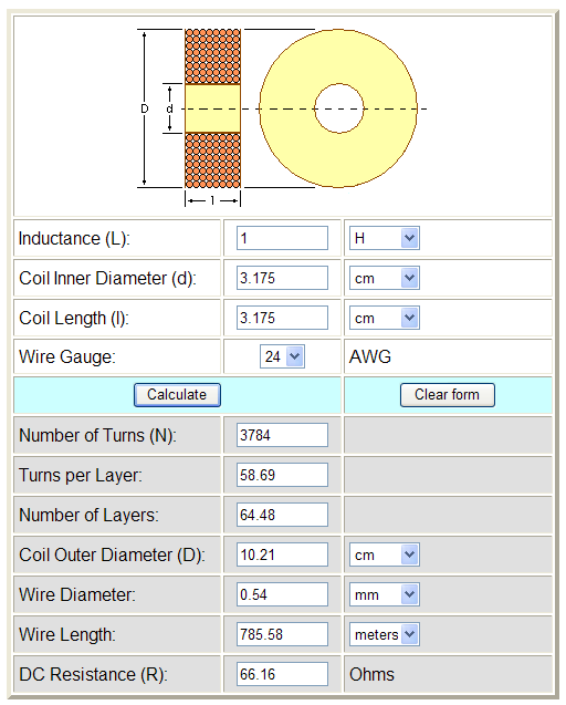

Hi Magura,
I was thinking of using 26 gauge wire (pretty small). I could wind a 1H air-core choke that has around 125 ohms resistance. What do you think?
Magura said:
I'm thinking that you have not calculated how much induction is needed to reach 20Hz 😀
Magura 🙂
Zen Mod said:
OK, smarty pants, which one of you scholars wants to go first? I haven't a clue how induction at 20k hz is calculated.
Edit: Nelson mentions using a 1H coil of wire, so I thought this might be a good place to start.
I've noticed that 125mH works and that 4H works. Which is best? I don't know.......
I havn't always been smarter than you :rofl: :rofl: :rofl: :rofl: :rofl:
http://www.diyaudio.com/forums/showthread.php?postid=306538#post306538
Magura 😀
