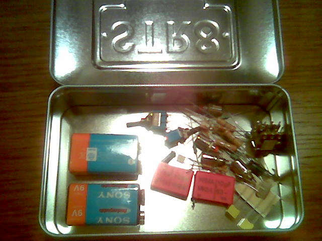

As you probably saw, it will be run out of two 9 v Ni-Mh rechargeable batteries. I measured them and they actually have around 9.5 v. So the pre will be run at about 19 v. I also expect to adjust resistor values. What about inserting a 2 k trimpot in series with, say 1 k Drain resistor, and tweak for best sound? (I don't have a distotion analyzer,my ears will by my guide)
