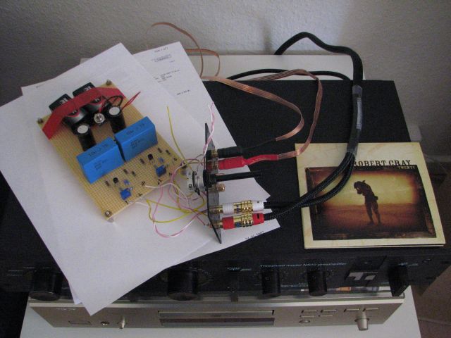

Nice layout steen.
I didn't know I had a writing style, Thx.
- I've made the test with no D ) Output pot at output.
Good news for the masters : it works bestissimo.
I can now crank up the volume to very very (up to much too) loud level without any noticiable (hearable) distortions. Seems that there is (more than) enough gain.
Aleph 5 love to be driven by such a fine and powerfull bride.
The sound is pure magic, only.
As for further tests, obviously you prepare yourself to take over, I see. HeHe.
Waiting for your first impressions.
Manu
I am pretty excited about how this thing will sound connected to the F4, with or without bunnies Especially now when Manu talks about loads of gain. I will use two such batteries in series, with a BG or similar (smallish) cap for smoothing out the DC. Manu, you are not off the hook yet I am just foolin' around from the sideline Back to work

Me again. The proto is up and running, and I beleive this is the ugliest proto I ever made Call me Lucky Luke if you wish, 3 hours (including visitors along the way , took at least an hour to get rid of ..... ) It sounds pretty good though! Actually I am quite surprised! No fine-tuning at all, I simply adjusted the input trimpots to half value and hoped for the best It really rocks the F4 to clipping....he-he I didnt count on that but nonetheless... The sound is better than expected. The supply is simply a 330uF Black Gate for feeding each channel. Since the original sch. doesnt have any decoup between the channels, I though it would be best to feed each channel from its own cap...pheeeew The batteries are working out extremely well indeed. With no signal and the volume at full throttle, I can hear no hum/noise whatsoever with the ear right next to the effecient Fostex 166's That was even less expected. Battery supply rules Pheeeew again I am off to some more listening (and finetuning along the way!!)

I have no idea, but robust it is indeed! Man this little thing rocks the place to no end. Its even more powerfull then the NS10 Me surprised to no end!!!!Blues said:Steen is the man! Is this the robust preamp Mr. Pass promised? R Cray is my man too! Battery ps is the way to go with a simple circuit like this. Parallel a couple more and it should last a lifetime
I might even consider to go dualmono, using 4 batteries I am blasted off my chair Build one and listen for yourself! There is not even the slightest noise at full throttle!! Takes an hour to solder this thing together
lykkedk, the pot is a 10k logpot at the input of the preamp! You are more than welcome to have a look (and listen) for yourself.
Ohh, the battery holder is there to keep them from bouncing around...........He-he
