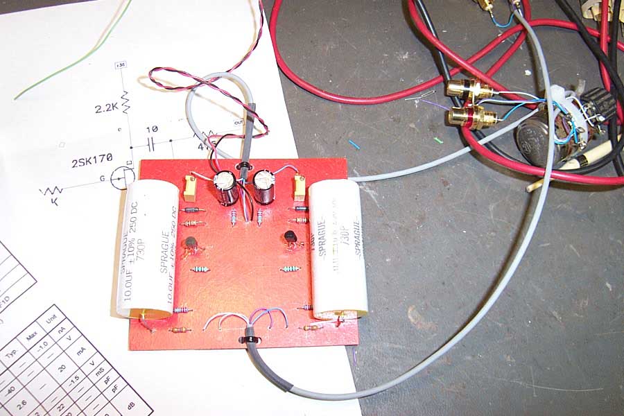

mpmarino said:Here's my little mess 🙂
I get about 5.1v across the jfets. I went thru about 7 of them to get them close. Are they normally that badly matched??
Anyway - can't try it tonight it's a bit too late![]()
Nice work Marino. Not as messy as mine though😀
At some point I had a pair of J-fets with 4,3V and 5,6V, VDS. Quite a difference.
Steen🙂
