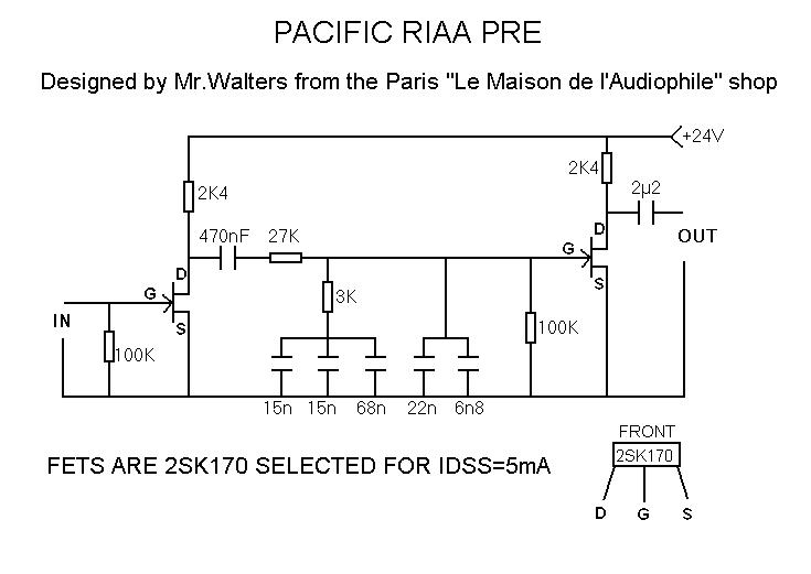

"Hi there,
>You had spoke about building this preamp. Do you have a schematic available
>for it? If so can you please send it if possible.
Here is what I have. All ASCII I'm afraid....
l'Audiophile MC Pre-Pre
Folks, with just few resistors, one JFET, one output cap you can build a
step-up device.
12 Volts regulated or accumulator buffered supply
2k2
|---------0.47uF-----out------------>
(drain) |
---in---------(gate)JFET 100k
| (source) |
100R | |
| 47R |
-ground--------------------------------------------------
The basic topology is that of the second step-up amplifier by "Maison de
L'Audiophile" of Paris/France.
The first 100R is the cartridge load, which must be adapted for the
cartridge you use. Using a paralleled 1nF cap also makes the circuit immune
against RF noise. The 47R resistor in the source is not necessary, if the
JFET has an IDSS(on) of 2mAmps or less.
As the signals are very sensitive, the voltage must be very clean, a 100 000
uF electrolytic cap for blocking power supply noise, computer grade
favourably, is advisable. Suitable JFETS are 2SK170, 2SK240 (double JFET),
2SK97 (double JFET), sorry only these japanese types are suitable, the
European BC264 and BF254 and so on do not work here (I tried !).
All resistors must be big metall resistors, e.g. Beyschlag 1Watt, or
tantalum resistors. No carbon resistors allowed here, tubes addicts.
The output cap is preferably polystyrene or polypropylene or paper-in-oil,
as you like it, as they are different in sonic balance.
Pacific RIAA Pre - 24V Version
o-----------------------------------o------------+24V
R2 R6
| D---o---C7---o
D---o---C1--R3--o--------o------o---G OUT
o---o---G | | | S---o o
IN | S---o R4 | R5 | |
o | | | | | | |
| | | o--o--o o--o--o | | |
| R1 | | | | | | | | |
| | | C2 C3 C4 C5 C6 | | |
o---o-------o--------o--o--o--o-----o---o-------o--------o--- 0V
R1 = 100k C1 = 0.47 micro
R2 = 2.4k C2 = 15 nano (ideal C2 + C+ +C4 = 99.3 nF)
R3 = 27k C3 = 15 nano well my copy says 100nF
R4 = 3k C4 = 68 nano
R5 = 100k C5 = 22 nano here its 30nF total
R6 = 2.4k C6 = 6.8 nano
C7 = 2.2 micro
We build the Pre using both the Fet Pre Pre and the Pacific. PSU is 3 X PP3
NIMH Recharables. The Pre Pre get's it's PSU via a dropper resistor and a
2,200uF Decoupling Cap (Black Gate or similar) so that 12V are supplied to
the Pre-Pre.
Later Thorsten

steenoe said:Twitchie: Draw up a schematic of how you connected things and post it🙂 I am quite sure that you will get the thing to work!! Mine works, so will yours!
Steen🙂
Thanks Steen, I think I just needed some good luck from you - I redid the layout from scratch (protoboard) and also found I forgot to add the ground drain on the pot - now it is working much better from DAC output to F4, but there's still some distortion (I swapped out 2.2K V+ rail resistor to 1K so I now measure approx 7.8-7.9V across jfet D-S pins (18.5V rail voltage).
It's 'working' now - should I adjust Rs? Any other measurements I should be taking?
V+ across 1K resistor (2.2K originally) - measures 6.58V
across JFET D-S - measures 8.01V
across Rs - measures approximately 67mV

For me 5,6 mA through Rs works just fine. I suggest to choose Rs to get about this 5 mA through it and then change the value of Rd to get about 6-7 V accross Jfet as meister Strauss suggested.
It is a good position to start for your further tuning.
Manu
Manu
Twitchie, try to revert back to Mr. Pass's schematic!! Thats what I did and everything worked out fine!! You can't just swap out a 2,2K resistor with a 1K!!! As far as I remember , the Drain to Source voltage was around 5V's.... I havent got time for more measurements today😉
