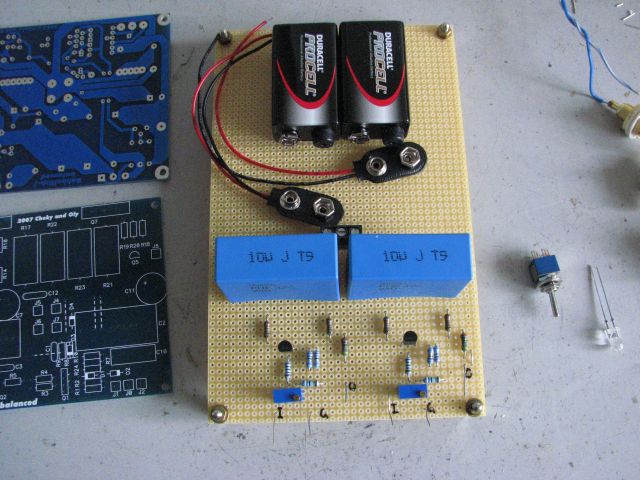

steenoe said:You are right about the supply. Just made a quick drawing of the shunt reg and it ended up with more parts than the gainstageSo battery power is the simple solution.
2 normal 9V batteries should do the trick for starters.

The J-fet BoZ is a nice little toy. I will try and play around with it for fun🙂 Might turn out to be a handy little gadget without the powercord. Looking for a lunchbox right now😀

What is the best way to optimize the loadline without a Distortion Analyzer? I was thinking of installing trimpots like Vix suggested and tweak the values to get the nicest sinus-curves at 1V , 1KHz while watching the screen. Repeating at 10kHz and 20kHz.
Any other suggestions to get the best values Vds/Ids for lowest distortion?
Steen🙂

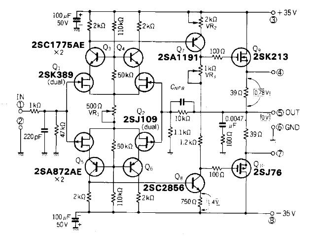

Edit. Thanks a lot JH. Thats a nice schematic, with lots of
J-fets 😱

Here is Kubota Takashi preamp which I used time ago for my 0dB
power amp (Hitach MOSFETs). You could make PCB if you like ^^.

btw- nice one ,even if teuer (but- there is really no point in making any circ non-susy ,if it have more than one transistor
Steen🙂
Or drop by sometime and borrow my distortion analyzer 😎

there is no other way
study Papa's schematic where he use 2SK170,especially one with cascodes ; see what d-s voltages he use- this is probably (!?? hehe) nice voltage range for them;
try to keep that voltage range ,then adjust current to achieve sym clipping
it's iterative process with varying Ub,Rd and Rs ,presuming constant load;
at least on our level of knowledge

Lookie lookie 🙂 Progress.
