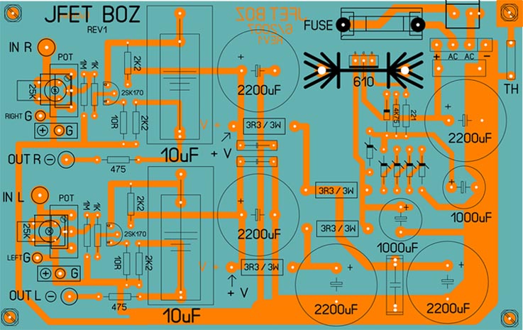

Manu said:
I will check that, but without pot at the output I get some very dangerous noises.
After changing all connectors, the things improves somewhat, but still much to much distorsions.
I will try with some better pots at the input.
Again , I'am too incompetent for the job, and I don't wan't to give the impression that there is something wrong with the JFET BOZ.
Manu
Manu dont despair, you are doing great.
Do you have a picture of the board with the resistor values you used on it? The layout seems correct, but it would be nice to see the values.
Another thing, did you try and measure the actual bias current to see if it is as its supposed to be? If not; then measure the voltage drop across the source resistor and divide the value you get with the source resistor value to get the bias current. I=V/R
Steen🙂

Thx for your kind words. I don't despair realy but I don't want to be unjust to the JFET BOZ.
THe values are the same as in Nelsons posts. I only tried some different PSU volage values 20V 17V and 14V
With 20V and 10R Rs I had about 7mA through Rs. Voltage drop across 2K2 was 15V
With 17V ,15R Source res. -> 13,7 Volt. drop accr. drain Res. and about 6,3 mA through Rs
JFet are BL with about 9mA Idss
Manu

in that case try to shoot 5mA as target current
leave at least 5-7 volts across jfet
The board seems okay. What are the +/- desigantions at the output? Looks like you have them exchanged.
Steen🙂
Steen🙂
steenoe said:The board seems okay. What are the +/- desigantions at the output? Looks like you have them exchanged.
Steen🙂
Is the circuit not inverting?
manu

nope ;
but hot end is always hot end ;
you can unhotttttt him only with xformer ;
mebbe hot isn't so important ,as gnd is
With 5mA (22R Source Res), The distortions are almost gone (bnot entirely though).But Yipiii.
I will reduce 2K2 to get 5-7V accross Jfet (now its about 4V) as you said captain.
The sound approve a lot...
The live character of this pre is amazing. Even with studiorecording.
Enjoying (My beautiful bosnian girl enjoy too)
Manu

Zen Mod said:
nope ;
mebbe hot isn't so important ,as gnd is![]()
And nobody trust me when I say I am stupid.
Reconnected hot to hot and : Oh Lord!!! This sound. Plenty, full, seductive, and cristal clear.
Danke Meister
Danke Steenoe.
It is realy great.
