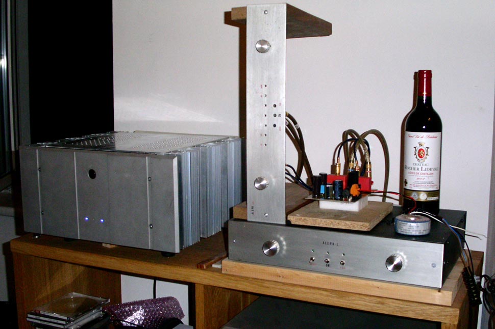

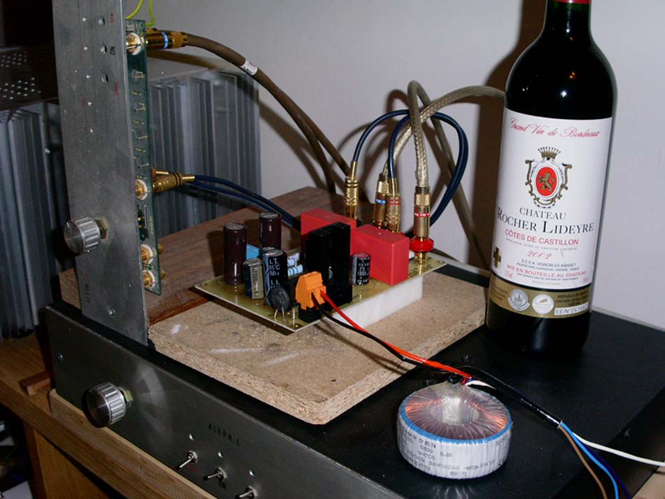

My setup follows nelsons Schematic, only differing in the rail voltage which is 20V.
As far as I can judge right now the overall sound characteristic is a very detailed and very fine one. It has a somewhat "live" and a very transparent character. 🙂
So far.
But I think there is something wrong in my setup. I have to turn the input pots nearly all the way down, otherwise the sound is too much distorted. Unfortunately the bad pots I used don't give enough margin to realy find a good configuration. And of course I have to turn the volume at the output all the way up.
So there are some adjustment to do..😀
But from what I have heard till now I'am shure, it is very very promising 🙂
Manu

slightly increase source resistors
decrease PSU voltage
after some tweaking,you'll bang on topology limits ;
if you can find your source characteristics and output amp sensitivity in with topology layed boundaries .......fine ;
if not...... nice xperiment ,useful as stage somewhere.

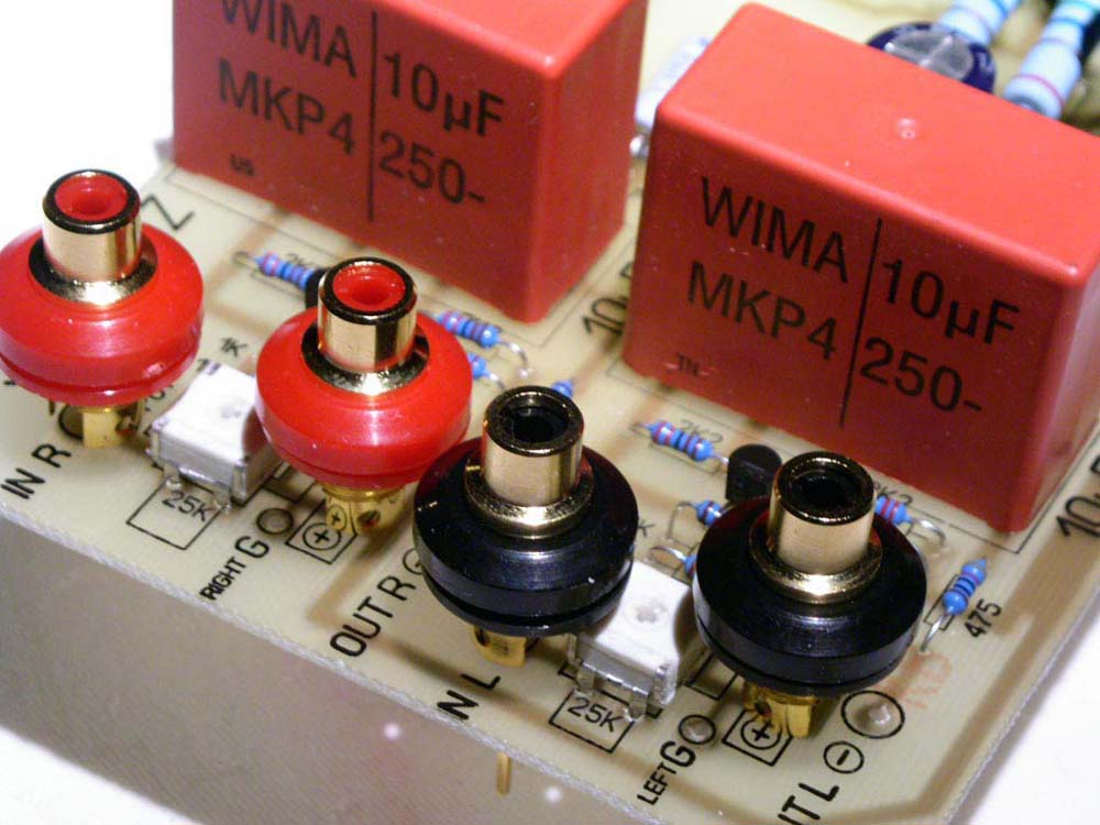

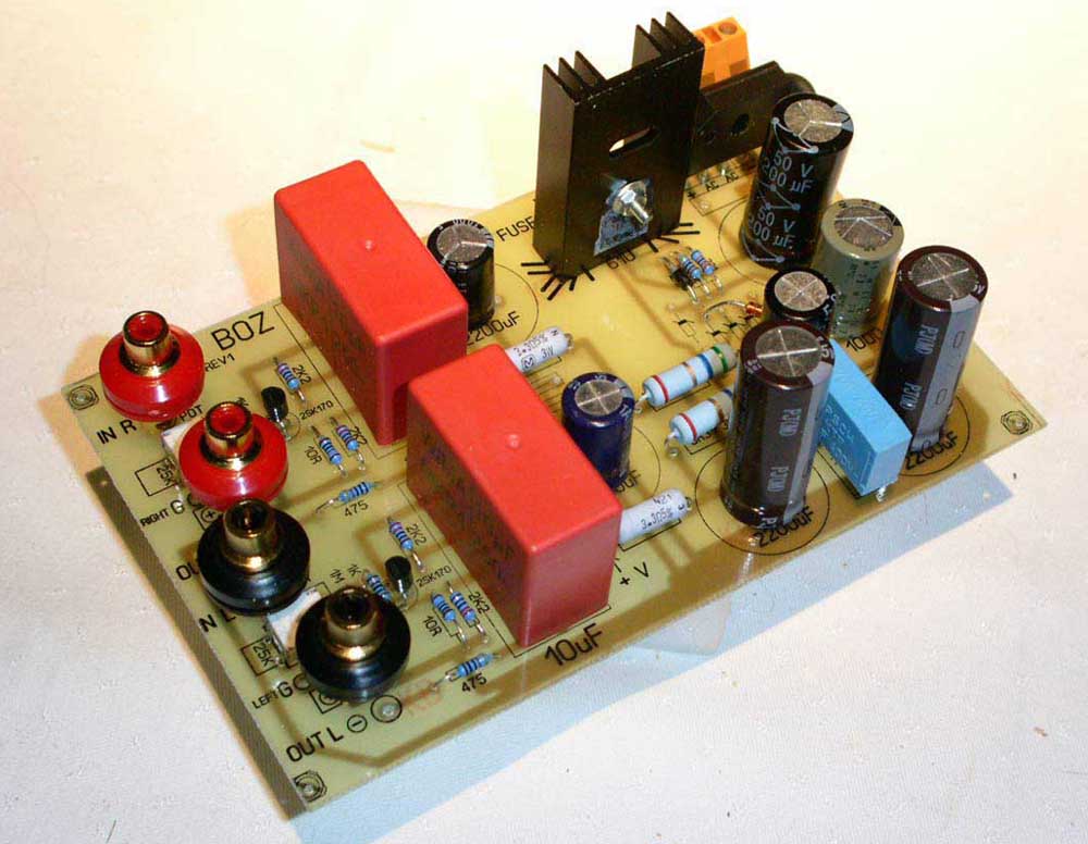

Manu said:Firts some pics of the baby. Tests results follow soon.
Manu
Good job, Manu. Nice little board🙂
Multiturn trimmers will assist in an easier adjustment. You can pretty easily go past the sweet spot with a singleturn pot.

Zen Mod said:slightly increase source resistors
🙂Originally posted by Steenoe
Multiturn trimmers will assist in an easier adjustment. You can pretty easily go past the sweet spot with a singleturn pot. [/B]
Thank You for the hints. I will try them all and report.
But for now I have to go to work...
Manu

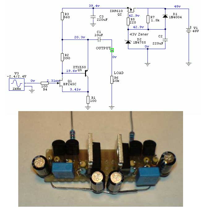

this thread gave me an idea to make a simple preamp for OPA549 (sounds very good in inverting topology with a gain of 6 dB - 2x). One JFET alone couldn't do it so I used a BJT to help. Output from my DAC (AK4393) is 2.4 AC V peak and this preamp gives on output 12.5 AC V peak which is enough to drive the OPA549.
First, I simulated the circuit in Circuit Maker 2000 with parts that I had in drawer, and fortunately, the real circuit measured roughly the same.
BF245C is a bit different from 2SK170, but that's what I have at hand.
I tried BC560C and BC639 for Q5, but ZTX550 is the best in this place (needs a heatsink). In the next couple of days I'll try to find a BD139 or something similar to try it.
Sound is great, still neutral but gives more space and instruments' localisation compared to AD823 and AD797 which I used before.
I used IRF610 as power supply voltage regulator as I have them in drawer, otherwise LM317 or something similar can be used.
Here is the schematic and picture of v.1 perfboard prototype:

Manu, what amplifier did you connect Jfet BOZ to? Maybe the reason for distortion is the high sensitivity of the amplifeir,and it simply gets too much...

Hi Vix,
Its an Aleph5. I used a 10K volume pot at output of the pre.
manu
The tech specs of my SA7001 SACD says the output level is 2,3V RMS, and for the Amp, its an Aleph 5 (40V 2,1 bias - pretty hot this days, so if you have some saussages (or cevapi) left.... c🙂 )
Thx for your hints. Should I let the drain res at 2K2 if I reduce the Source res to may be 6R?
Manu
hehe
seems that hot weather is cause of confusion..........
anyway.......better than me- I'm confused all the time...... 😉
again........increase them,to increase local degeneration - feedback- so stage clipp later
- Jfet BOZ
