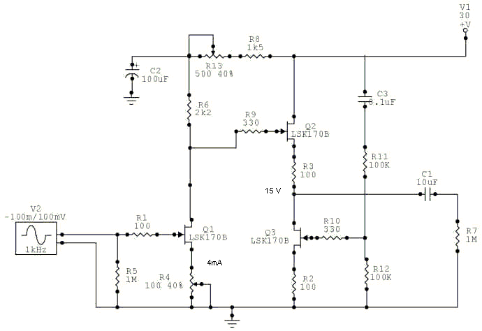

Nelson Pass said:
Yes, the minute you are willing to bias the input at other than
ground you can make for great improvement.
As to the question about cascoding, yes you can, but you no
longer have the load-line cancellation discussed earlier, and
you will have to alter other parts of the circuit.

Actually I've been playing with this jfet for few weeks when I got time before this thread started.
Still scratching my head how to improve it's sound. Cascoding with 2SK246 make the high freq. a little bit harsh and I have to bypass the drain resistor with 100pF.
The circuit was taken from www.tubecad.com, a variation of Aikido circuit. I have built the tube version and i'm very very pleased with it's sound.
The jfet version sounds better than few preamp already made but the tube version still better. I wonder if this circuit still have room for improvement.
This is the actual circuit.
rgds,
G33/33
