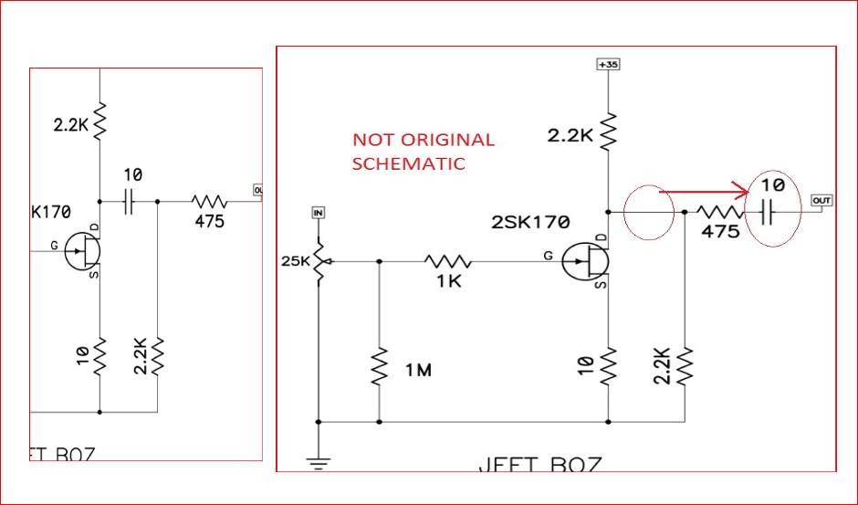

Sheesh, I've been away too long. Thanks to this thread I was reminded I made one of these almost 10 years ago :headbash:
Quick question for those kind enough to read this. I see a lot of capacitor coupled circuits out there, and there isn't absolute consistency on where the cap is placed. I'm using this circuit as an example for my question - because of it's complexity 😀
Is there any harm or change in the operation if the coupling cap were moved to the final output? I'm thinking NO, but i'm probably missing the point as usual.

IMHO The circuit will not operate the same. The capacitor, when positioned as in the original circuit in combination with the 2k2 resistor to ground , will eliminate pops when connecting or disconnecting the preamp. Also the 2k2 resistor to ground will affect the drain voltage if you reposition the cap as drawn.
