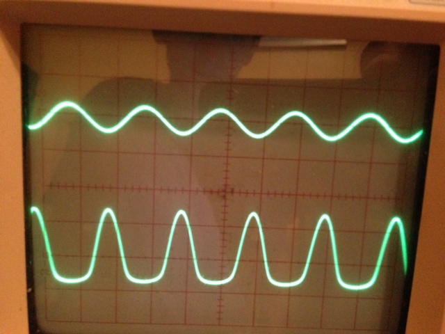

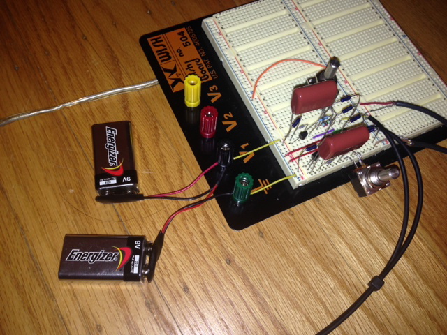

I decided to put together a JBOZ, just for kicks. I breadboarded it using parts I had or that I could find at the surplus store. Followed NP's schem from page 1 w/o any modifications. Powered by two 9V batteries. JFETS are 2SK170s approx. 12mA Idss. For testing, input was iPhone and laptop. Output through an F5.
When playing music, more complex passages with a lot of instrumentation, drums, etc. sounded mushy and garbled. Less complex passages sounded fine.
My son and I hooked the amp up to a scope, put some sine waves through it, and got the results shown in the attached photos. I'm new to using an oscilloscope, so correct me if I'm mis-interpreting the readings.
The first photo shows a 1kHz wave. Input (top trace) is ~0.1V (0.1v/div) and output (bottom trace) is ~4V (2v/div).

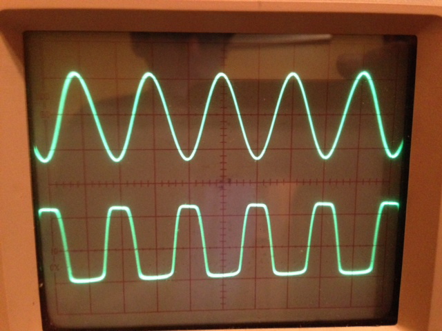

The second photo shows a 1kHz wave at clipping. Input (top trace) is ~0.25V (0.1v/div) and output (bottom trace) is ~12V (5v/div).
Obviously some weird distortion... What could be the cause?

Single Ended amplifiers start generating substantial second harmonic as the output voltage rises.Thanks. Is it normal for it to be clipping asymmetrically (bottom swing only) as seen in the first photo, at only 4V?
It's obvious it'll clip at 12V; I just added that picture in case it revealed some useable information for someone who knows this better than I do.
It becomes gross at about half the maximum output voltage.
+-9Vdc gives a 18V supply and a SE can give ~6Vac into a very high load resistance.
Above 3Vac the 2nd will be gross.
Aim for a maximum signal into a very high load resistance of around 2Vac (on +-9Vdc) and depending on bias current quite a bit less when loaded with typical load impedances.
2Vac is 6Vpp. That should "look" like a reasonable sinewave.
2Vac is also the output of many digital sources.
A Buffer (1 times gain) is at it's sensible limit trying to pass a digital derived 2Vac using two 9V batteries.
This is exactly why a Jfet BOZ will perform substantially better with a buffer stage after.
They also work better with a negative rail so that you can push reasonable output voltage and bias current through the first stage without hitting the rail prematurely.
Remember that the BOZ was always an exercise in minimalism rather than fidelity, it can be easily improved upon.
