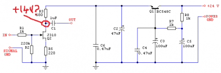

Hey all,
I just put together a version of the attached circuit (thanks for the schematic and values juma!). I deliberately picked j310's with a 35mA Idss (to match juma's original build) and I've found that the node between the drain resistor and the jfet is sitting at about 20V when run off a 24V supply.
Now correct me if I'm wrong, but wouldn't we be wanting about 14V or so there? My understanding was that the aim is to have that node sitting at about 1/2 the supply voltage plus a little bit? Node indicated on the schematic...

Hi Juma; thanks for repling!
R5 shows 1.75V approximately. R7 showing 5.35V (approx 8mA, so a bit lower than the projected 10mA)
I'm checking the j310 just now and as best I can see she's connected the right way around...
I guess I must of measured the Idss incorrectly originally (or I wrote it down incorrectly)... I think I have the other two i popped in that bag floating around on my desk here somewhere to test and check.
Anywho, I suppose the way forward is to decrease the value of the source resistor to get the target 2V drop, and then tweak the drain resistor to get the target voltage?
Edit: or even start reading properly about load line optimization
... I suppose the way forward is to decrease the value of the source resistor to get the target 2V drop, and then tweak the drain resistor to get the target voltage?...
You got it
The idea is to pick the value of R5 that will give you about 10-15mA through JFET and then choose the R3 that will put the JFET's drain at about half of voltage present at Q1's emitter.

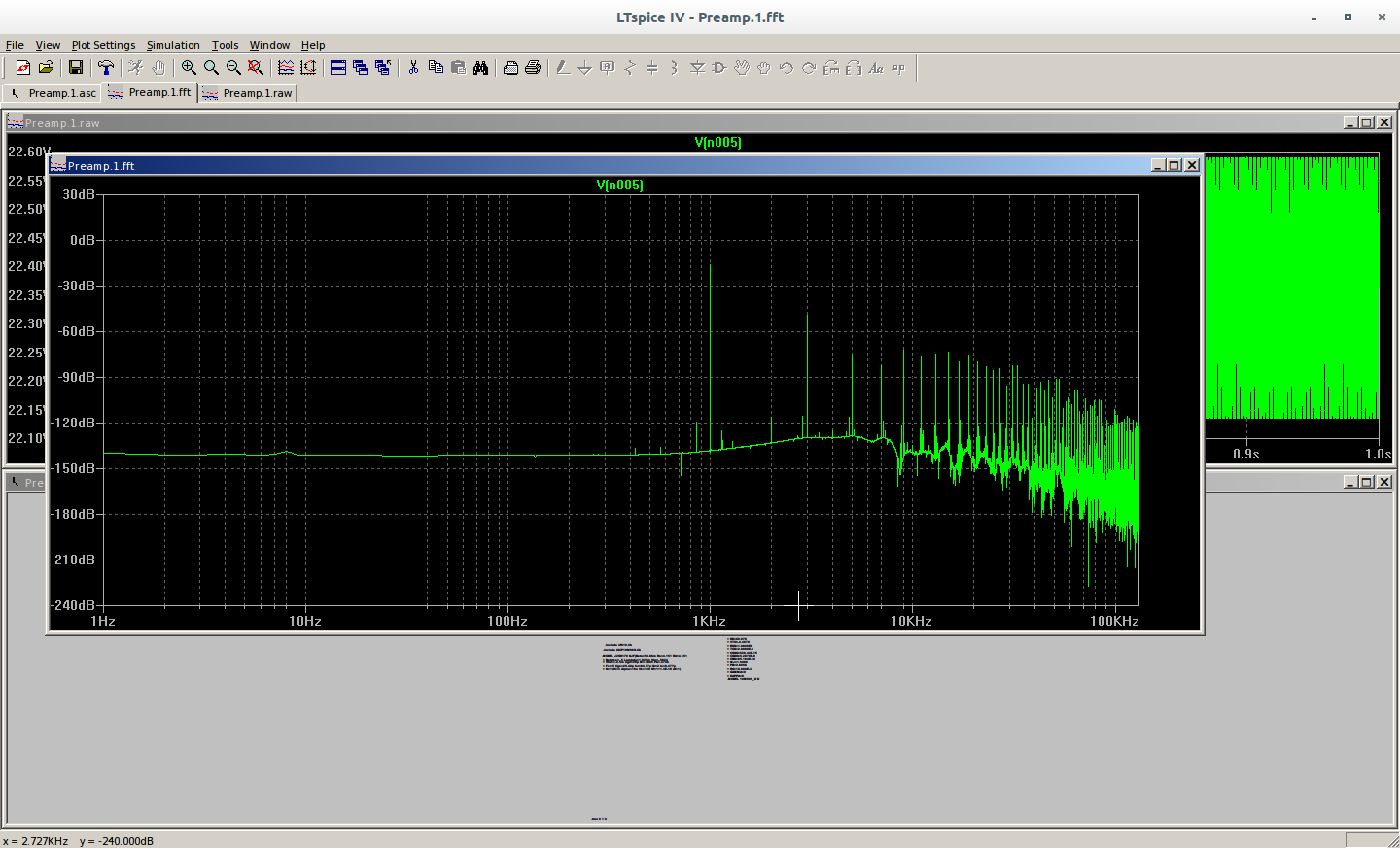

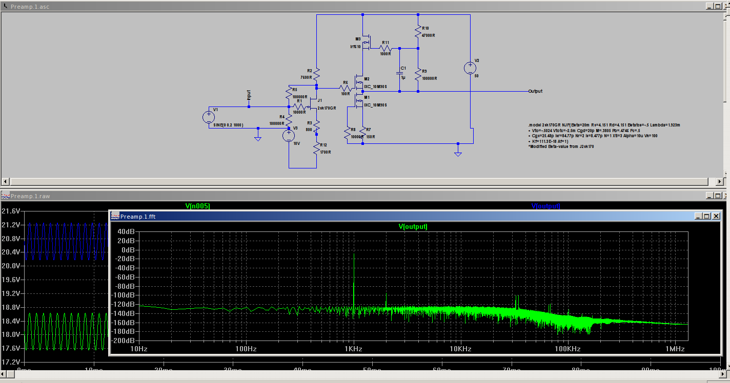

Sorry to resurrect this old thread, but I am attempting to design a SS version of the Super Linear Cathode Follower. Basically this has a JFetBOZ at the front end. In my simulations using LTspice I am getting horrendous third harmonic figure. The degenerative feedback on the 2SK170 source is knocking back the 2nds harmonic but having almost no effect on the higher order harmonics.
Is what I am measuring the reality with simple JFET amplifiers such as the JBOZ ?

The cathode follow works perfectly adding almost no distortion, but the front end generates the distortion profile I posted as tested at the drain of the JFET.
Nothing I try reduces the higher order harmonics below what I showed and I tried about three different models at this stage.
Shoog
Shoog
Can I ask, the circuit looks fundamentally the same regarding the components surrounding the 2SK170 so is its just the simulation run parameters you have changed to get the better result and accuracy ?
The FFT plot now looks much more acceptable and now looks worth building.
As you can probably tell - I am still new to ltspice and have considerable amounts to learn to get really useful results.
Shoog
Shoog
