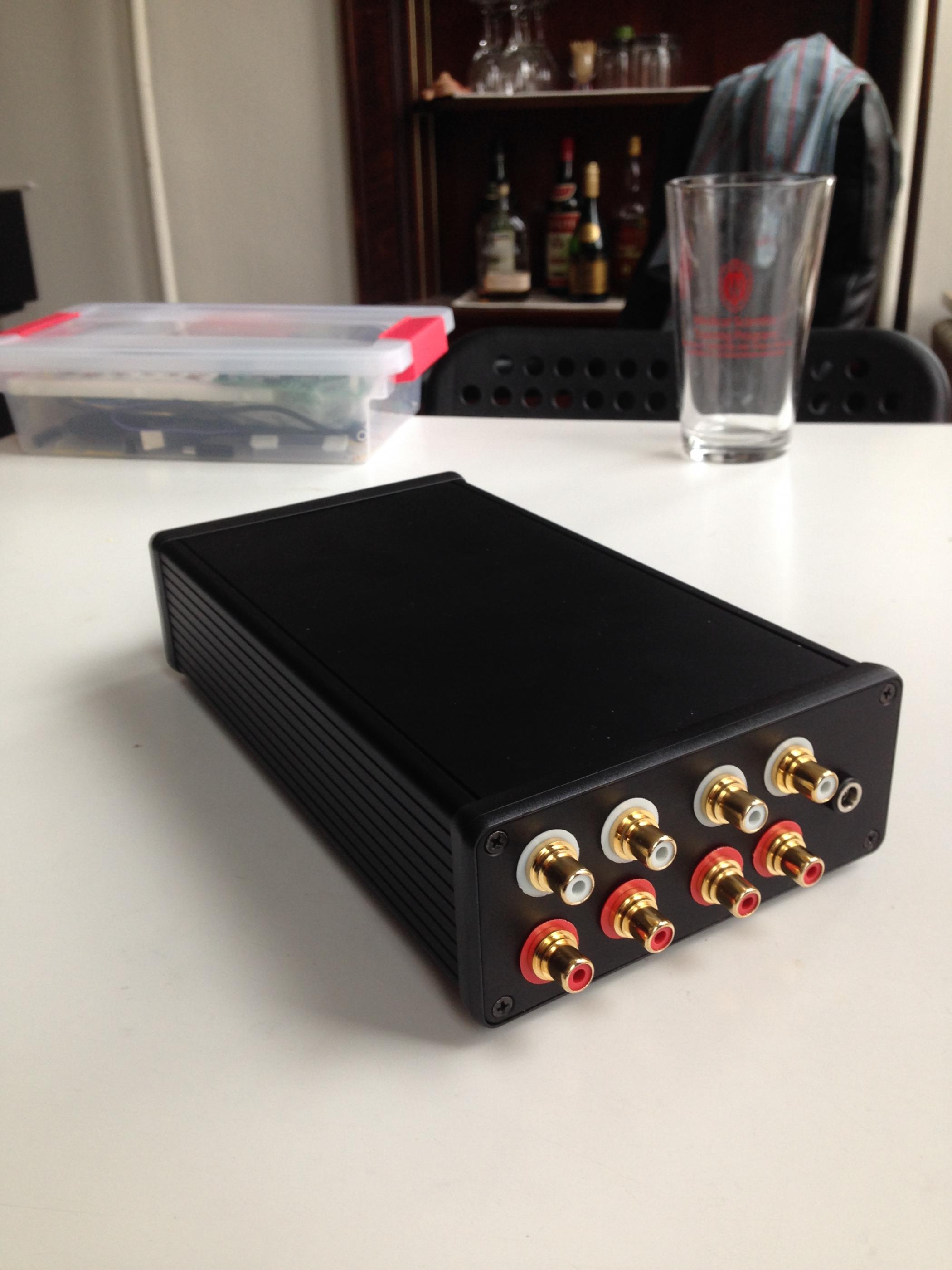

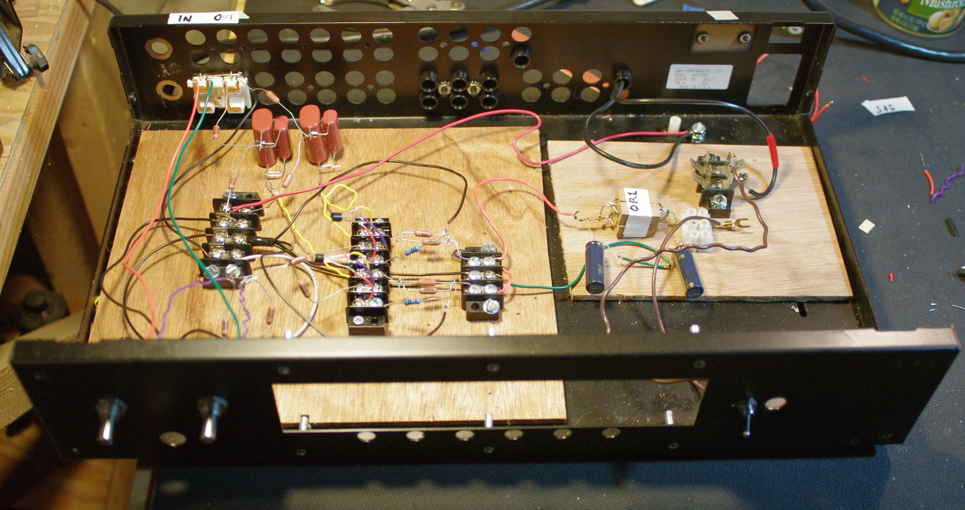

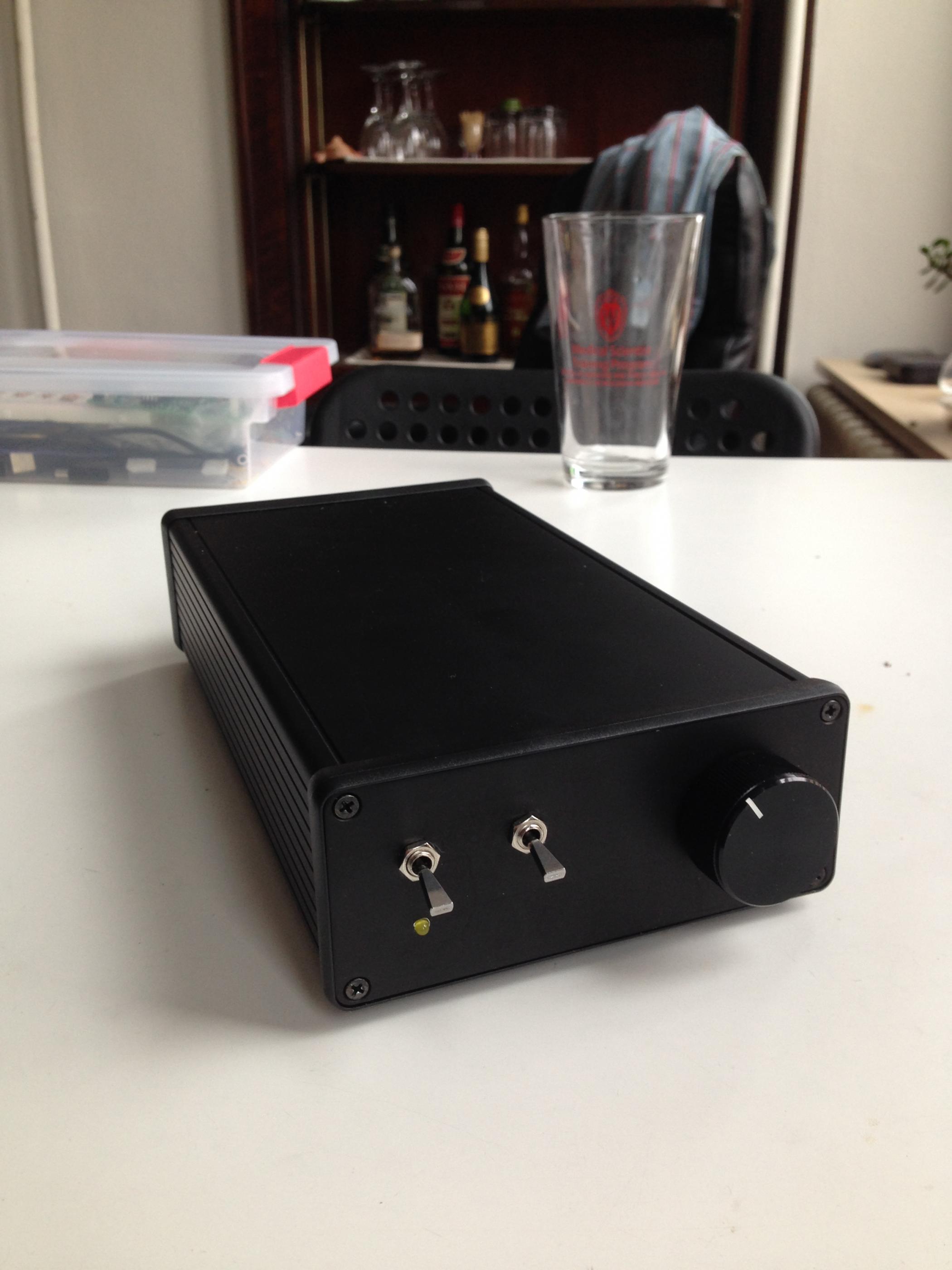

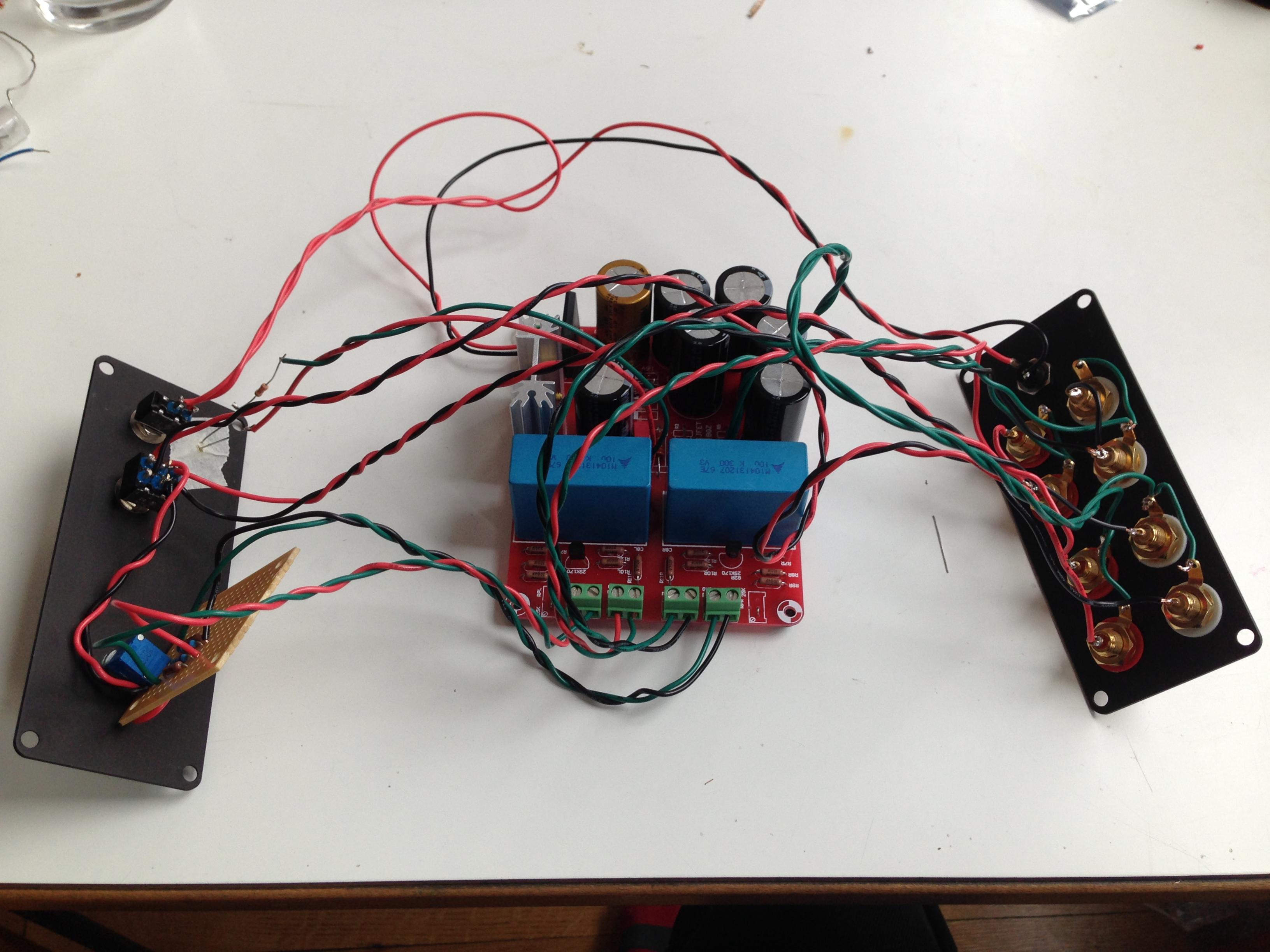

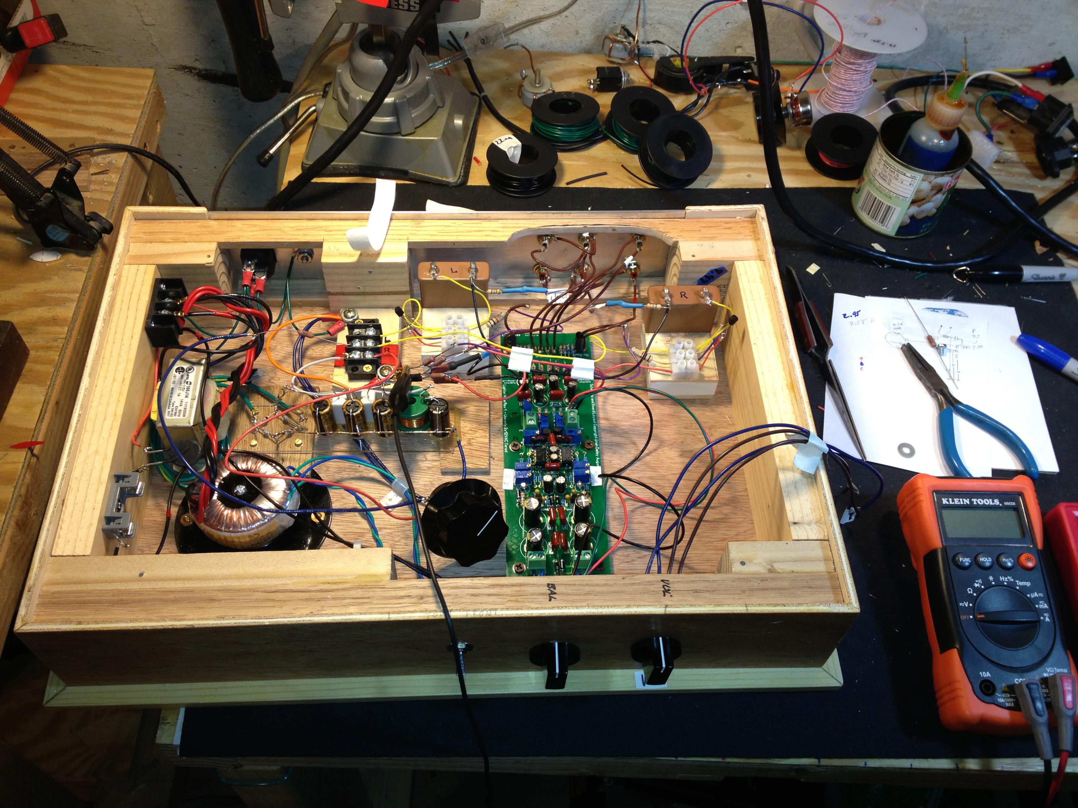

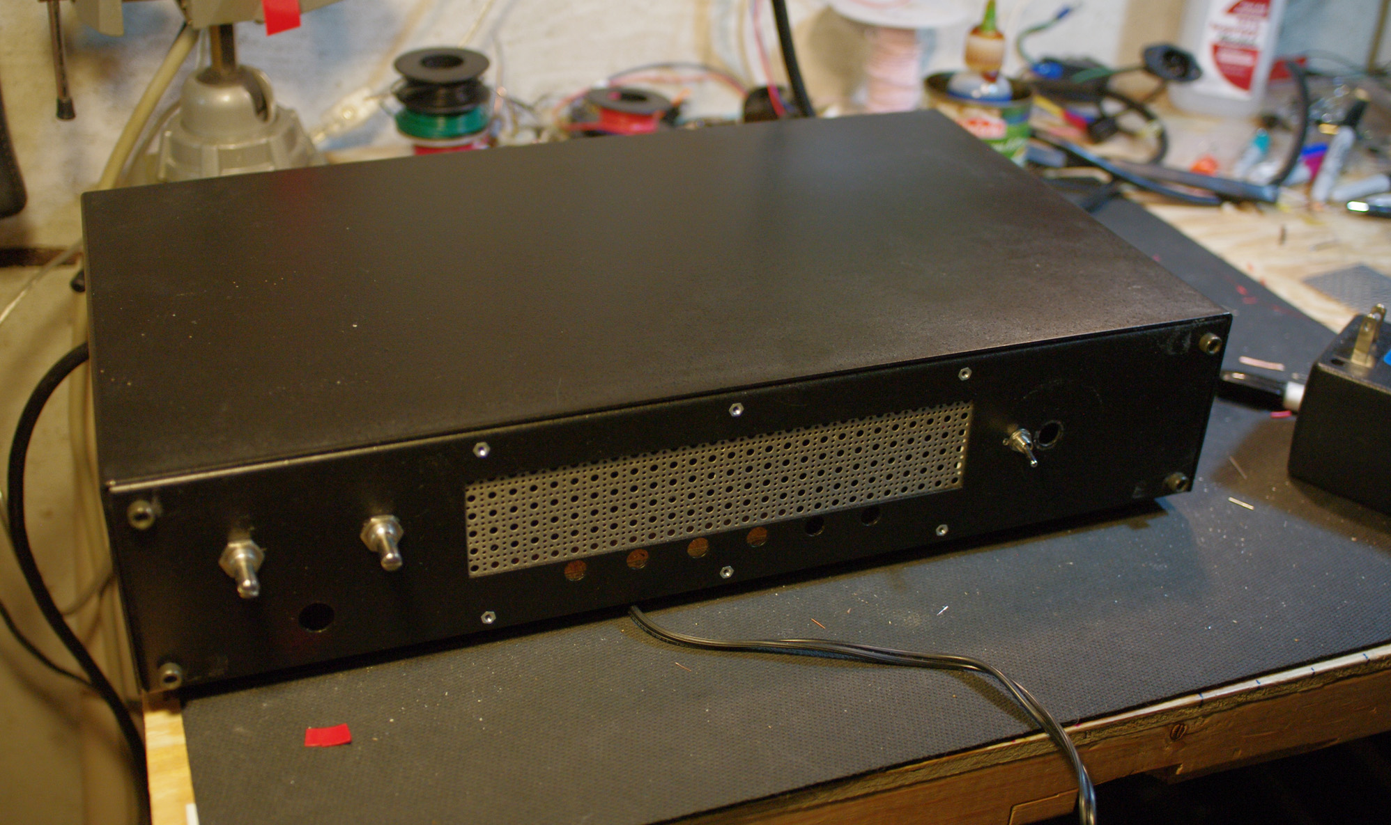

So for the newbies out there here is photographic evidence that cobbling Can work and persistence (with some kind help) will get you there.
The one in the wooden enclosure is the second build using a Lighter Note LDR instead of the 25K pot and some nice Russian PIOs instead of polyester - highly recommended.

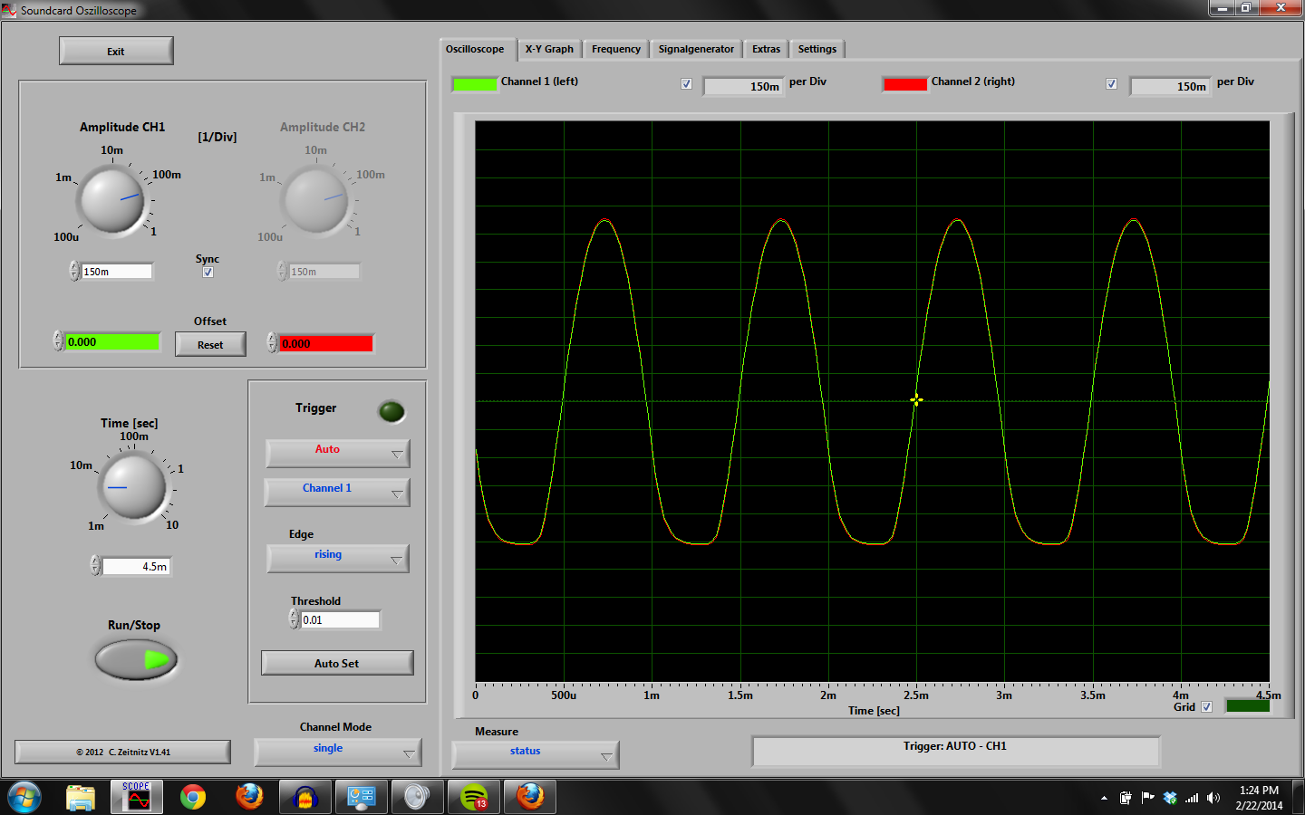

Andrew, thanks for the advice---I went ahead and tried this this morning. I've attached a screenshot of waveform produced from a 1khz sine wave with the volume knob at 10 o'clock. As you can see, there is some (not-so) nice asymmetrical clipping going on. I've read a bit about this occuring in the mosfet BOZ --- does this suggest I should change the drain/source resistors that are biasing the JFET?
My impression was that there is only so much linear territory on the Ids vs. Vgs curve for the transistor, and that the large voltage swings from a high-output source like this DAC (1.5V max, I'm assuming that means P2P) would thus need to be attenuated before they hit the 2SK170.
Test setup:
Audacity (Windows 7) --> Schiit Modi --> boz --> diy CMoy headphone amp --> line-in (built-in on Macbook Pro) --> Soundcard Scope software
I've measured THD from both the line-in and the headphone amp, and both measure 0.01% in the FFT function of the scope software, which is the bottom of the software's measurement range. The clipping waveform shown above remains when I attenuate the boz's output with the pot on the headphone amp's input, so it is not being caused by the headphone amp or the soundcard being overloaded.

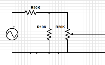

I was thinking about trying something like this earlier today to see what happens. To clarify, would it look like the schematic I've attached here?
Re:my previous post (cannot edit): that should be a voltage divider with 90k in series on the positive rail followed by a 10k resistor to ground, which is rather like a reverse of my original arrangement. I suppose this is better because it presents the source with a constant input impedance?

I use the same Hammond enclosures.
Indeed---I read your Jboz build pages more than a few times before starting my own, so I had that same thought often! I settled on this enclosure after a lot of shopping around. It's convenient, the plates are easy to drill, and it's < $30 from Mouser. At any rate, thanks for everything you've made available about your builds. It's been very helpful and encouraging.

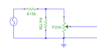

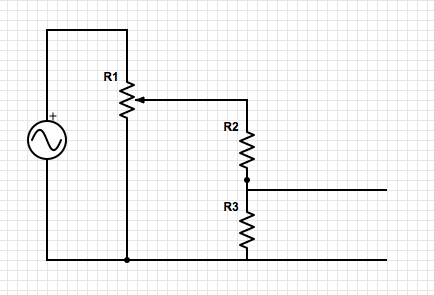

I've done some reading on an excellent page I found tonight (Volume control), and from what I can tell, I should be to put a 100k resistor in series before the volume control (see first attached schematic) in order to attenuate the input signal by 15-16 dB. I'm inclined to like this more than the 90k/10k voltage divider (see second attached schematic) simply because it uses one less resistor. Yet more questions: is there any clear reason why one should be better than the other? Or why either should sound better than the first arrangement?
I've continued my listening of my Jboz with the 20k pot and very low DAC output, with really great results. The soundstage and richness I was accustomed to are back, and the sound is really well-balanced---perhaps a bit less bright, and more pleasant, than the straight output from the DAC. Ideally there is a way to preserve this while attenuating the input at the Jboz, so I (1) can have decent volume control for my tuner, which does not have an output level control, and (2) don't have to take special measures to keep DAC output low.

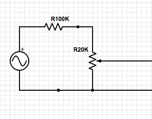

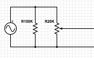

Tried a couple of attenuator arrangements today. The single 100K resistor in series (first schematic above) was effective and sounded better than the original, but not as good as the 20K pot alone. Next I tried the arrangement in the attached schematic---brilliant! It might all be psychoacoustics, but to my ear this was a clear winner. It also keeps the input impedance near the ~20K of the original circuit. Thanks all for the helpful input!
I've noticed that the sound has gotten progressively better with lower input impedances. Is there a reason I should have expected this?
JDG, I'd highly recommend trying this arrangement if you're looking for a less sensitive volume control.
