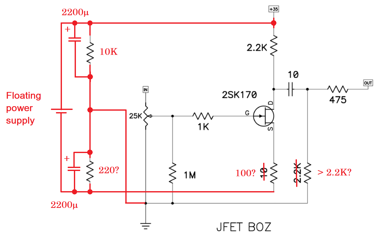

I have fresh batteries...12 AA's, about 19 volts.
I changed the the source side resistors to 5 ohms, and the V+ input drain resistor from 2.2K to 1K. Thats giving me about 10V across the Jfets. No more crazy distortion.
It's making music now. It sounds well...good I think.
Also, The voltage across D-S of the Jfet is 10.1V on one channel and 9.5V on the other. Does this indicae a bad match on the jfets?
It's got lots of noise If I crank up the volume without a signal. Maybe I need to sort out the wiring a bit. But it's working.
What voltage should I be aiming for across the Jfets? They are BL grade. I am starting to understand the relationship between the drain and source resistor to the distortion and voltage across the Jfets.
Also, I have a Pass f5 that I jacked up the gain by using 200ohm gain resistors instead of the stock 100 ohm. So, I have more feedback and 6db more gain than stock in the amp. maybe I should go back to the 100ohm.

In my opinion the only drawback by the JFET BOZ is the relative high distortion for higher output voltage (Post 58). So I just wondered if any of you have tried the modification as shown in the attachment. By tying the lower end of the source resistor to a negative voltage, the distortion should be lower. This solution is very similar to raising the gate to a positive voltage and using a coupling capacitor.

I have just received my HP339A last week, and this gave me a perfect oppertunity to play with it....I measured the original schematic as postec by Nelson on post#2 with a few JFETS.. 1Vrms out, 1KHz, here goes:
Idss=4mA, optimum Vsupply = 7.7Volt, THD = 2.5% mostly H3, some H2
Idss=8mA, optimum Vsupply = 16.3volt, THD=0.43% , pure H3, gain=26dB
Idss=14mA, optimum Vsupply = 24.5volt, THD=0.17% pure H3, gain =28dB
Idss = 16mA, optimum Vsupply= 28.9Volt, THD=0.115% pure H3, gain =28dB
JFETs with simmilar Idss measured the same THD, gain and optimum Vsupply...
I loaded the data into excel and set it to a 3rd order polynomial for a good estimator. I also made another graph that is fairly easy to read.
You can also punch the equation into a wolframalpha and get an estimate for your specific idss.
y = 0.0152x3 - 0.4738x2 + 6.1317x - 10.22
Below is my estimate for idss = 9.3 (just replace the "9.3" with your idss)
y = 0.0152(9.3)^3 - 0.4738(9.3)^2 + 6.1317(9.3) - 10.22 - Wolfram|Alpha
