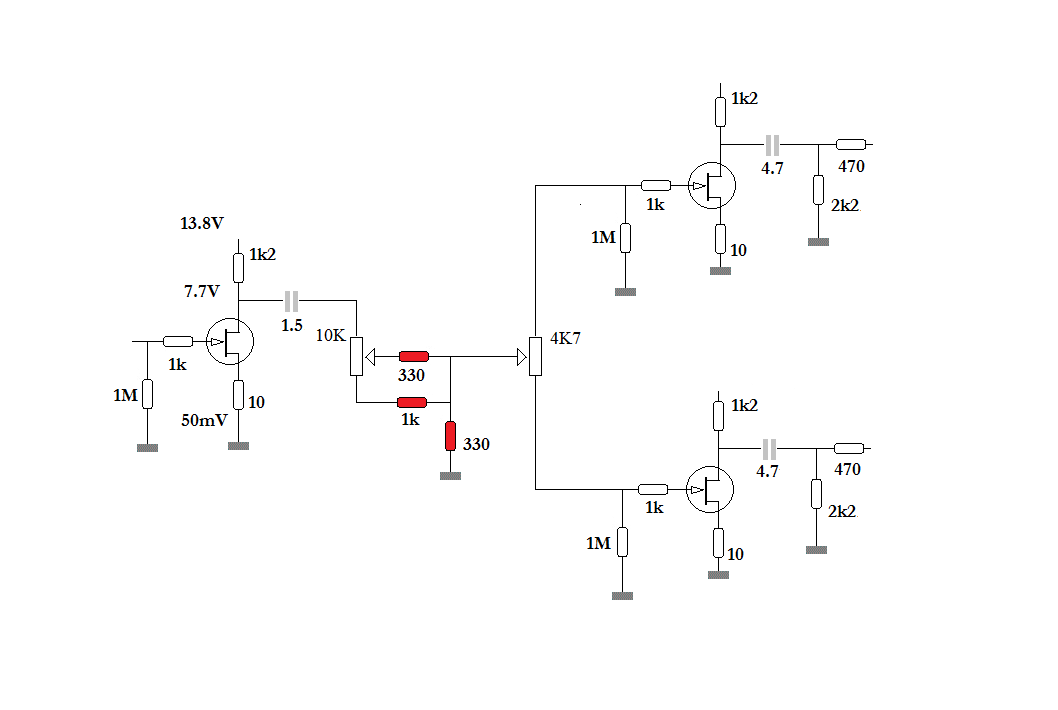

mine works very well tooalthough a different 2-stage mono version with 2-channel split, for my bass guitar
Sorry, might be a fault thought from my side, but if you turn the 10k pot up for full volume, the JBOZ in the first stage will only see 660 R to ground. This is a little low, I think it will give you "real Distortion".

... first stage will only see 660 R to ground.
maybe close, but maybe you forgot the 330ohm in series to ground ?
yes, there is a little distortion at full volume
but the gain so excessive I have to use a buffer with further attenuation
anyway, I have tried other resistor combination on the pot
all sound differnt
this one is so far the best
also because this special resistor 'curcuit' seems to interact better with the following balance pot, making it work more
but no, its far from ideal, and just a proto to see how it works
most are random components I found
but it works, and I havent been able to kill it yet 😉
tough little amp 😎
No, from the wiper to ground there are two 330R in series, 660R in total. Just wanted to avoid a bad surprise on your side... (I already had surprises like that)
If the gain is too high for your needs, I would have added a resistor of some kR before the 10k pot.

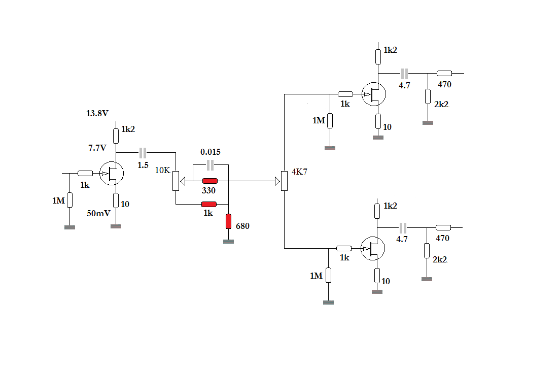

looks like this now
replaced the 330ohm to ground with a 680ohm
tried other resistor combinations
also the 'ordinary', and with bigger resistors
all resulted in more distortion
also looked at where I could place a cap
works exstremely well like this
not exactly sure what it does, other than lowering impedance with rising frequency
but the result is that the balancing pot is much more effective now, and adjustments very audible, and easy
turning balance pot change the sound from dry to airy, and thats about it
well, guess I should say, one output is driving the bottom end, and other channel the top section

O.k. then you are going in the direction of 1k for full volume. Not much for the JBOZ but in every case better than 660R.
Did not realite that your schematic was built for your bass guitar preamp. For stuff like this, anything goes. As long as it does not damage the gear. For music playback, I think we should avoid distortion to a decent degree.
I used to play the bass guitar too, so I know, that you sometimes need a lot of "good" distortion 😀
