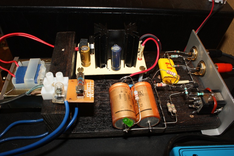

some time ago I bought the "JFET Boz" of JimsAudio that I would like to build. i have a transformer with double secondary (0-15V and 0-24v).
the 0-15v does go already the diamond buffer headamp of Sijosae.
now the question: the JFET Boz of JimsAudio can work with a voltage of 24V AC , if I am not mistaken, after the rectification bridge and filter capacitors will be 32-33v DC ?

It depends of the bridge rectifier loss and your resistance value in your CRC PSU filter, but yes about 32V

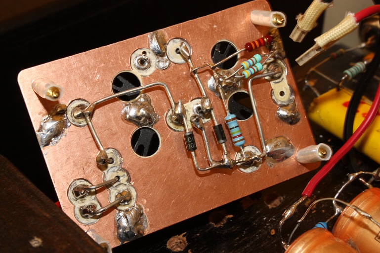

In this photos I have replaced the diodes by a TL431 circuit (For fine tuning the V supply)

Depends of the IDSS of the K170, with high V types you can use 30V of supply

Nice idea with the little TL431 PCB! Does it work as you planned?

Yes, work as planned 🙂 , with a distortion analyzer (Or a pc with a fft program) I can tune for the lowest distortion (0,5V can be the difference between 0,7% or 0,05%)

After reading the post from Tschrama with the table of Idss and voltage I have seen that my 2SK170 that I've got from a group buy have 4.9 mA so I can expect a THD of about 2% at around 8V.
I think it would be better to get new ones that have an Idss of about >8 mA! Anyone who can sell 4 or 8 pieces of them?
