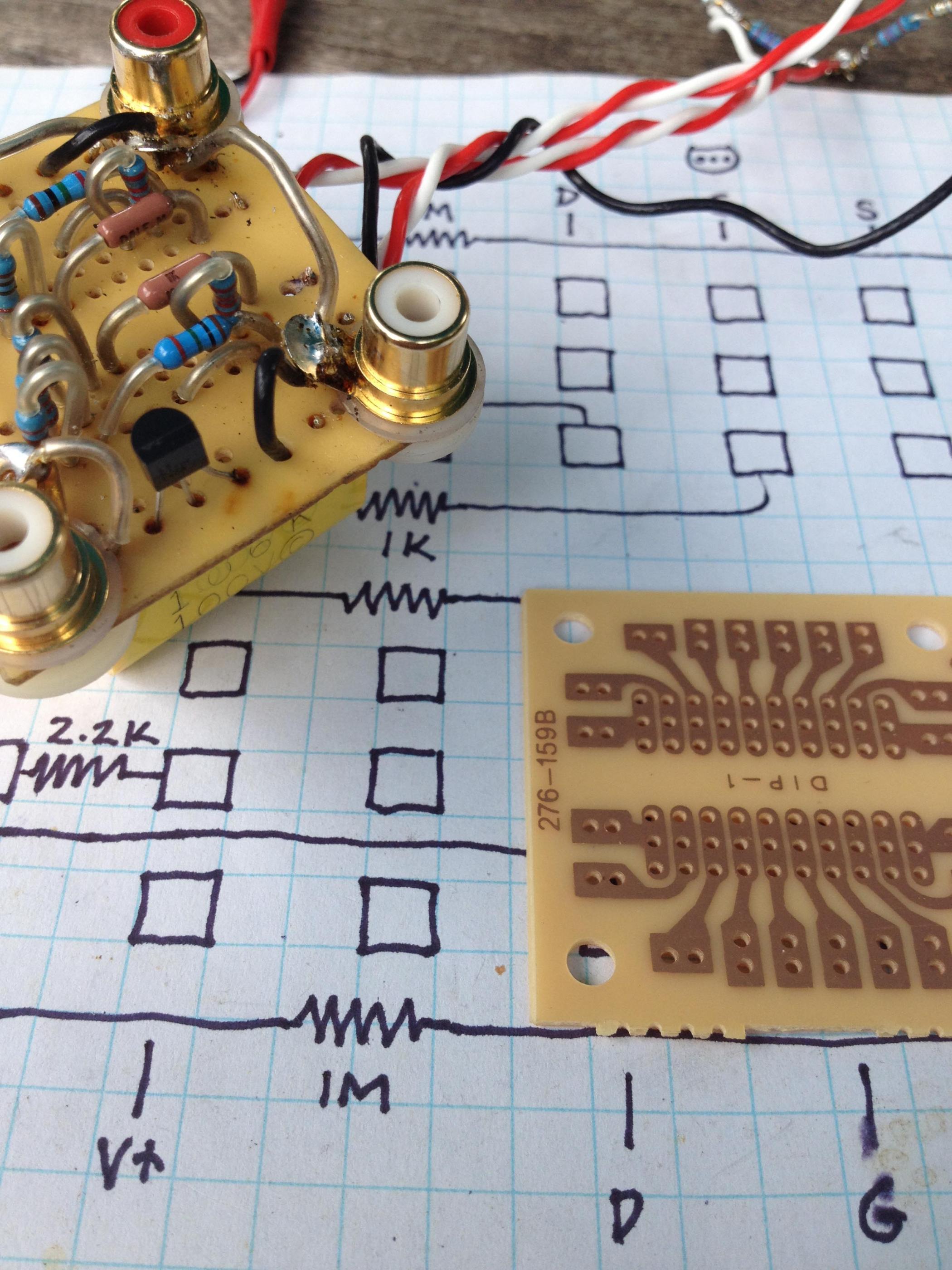

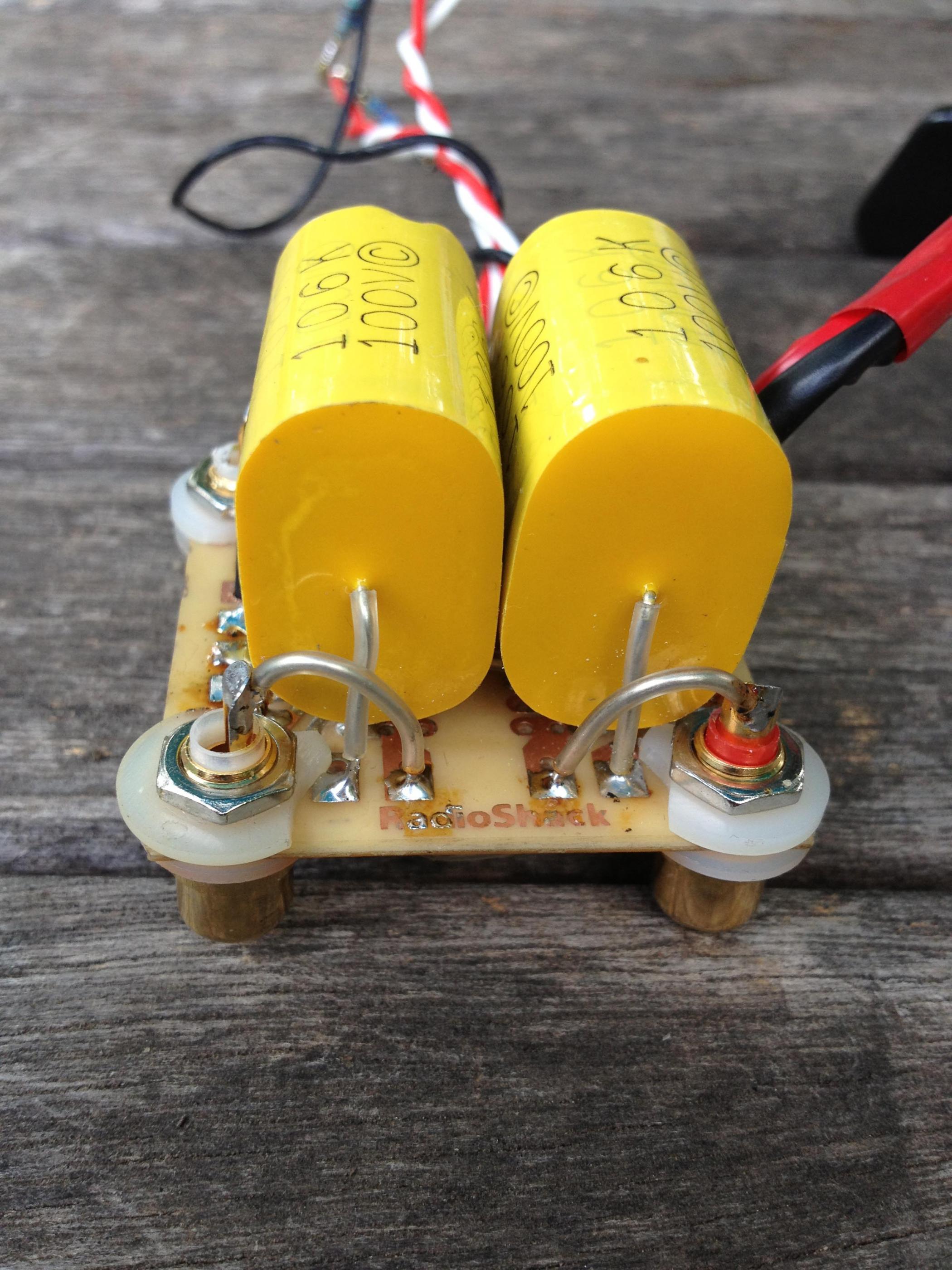

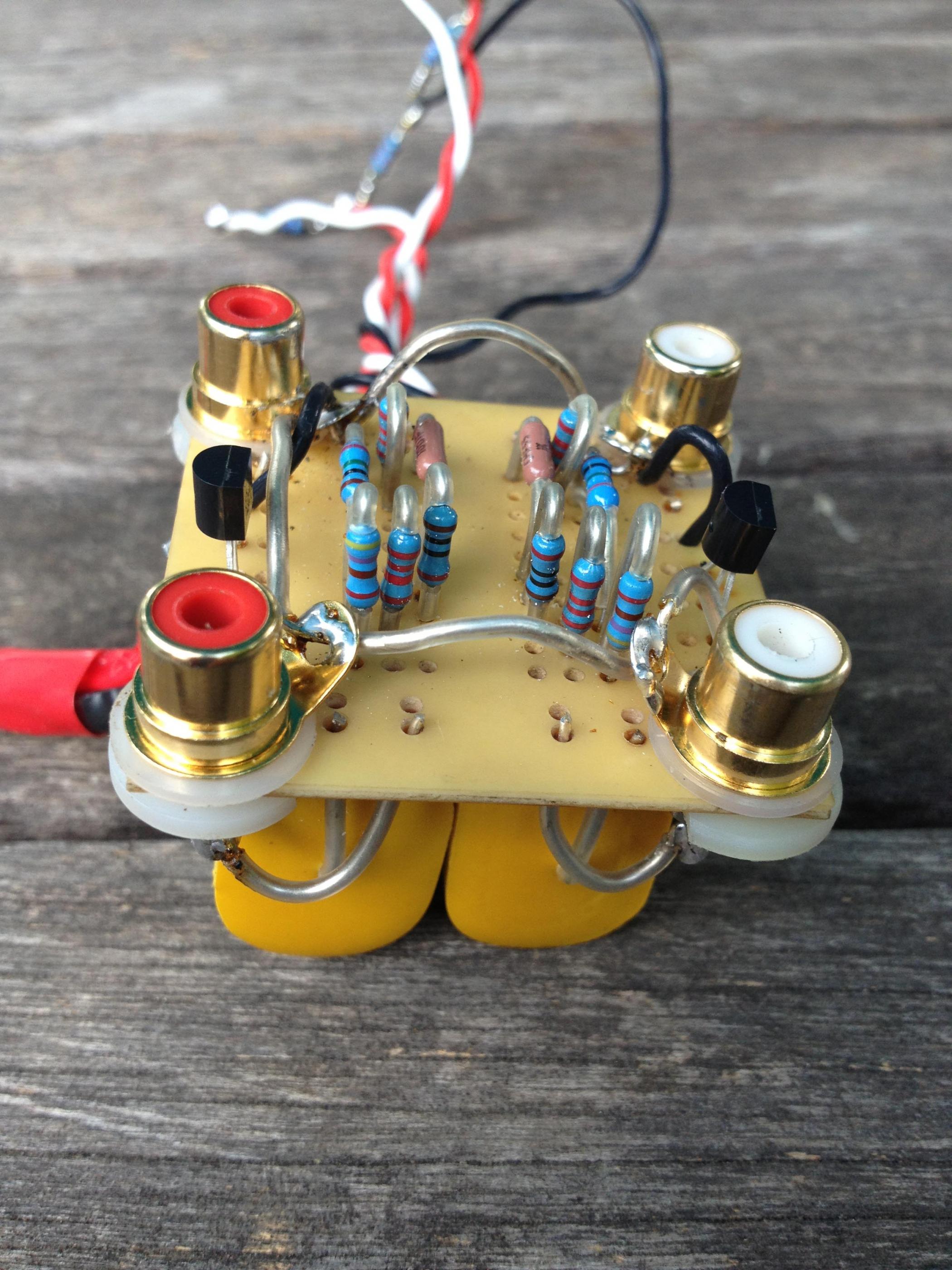

Howdy, Here's my Jfet Boz
I posted these pics on "Pictures of your Pass Amp", but they belong here. What fun building this has been. Just listened to it with a nice regulated supply (18v) into F5. Sounds great. Built per schematic on page 1, with 1.8K between V+ and drain to achieve 9V between drain and ground.
