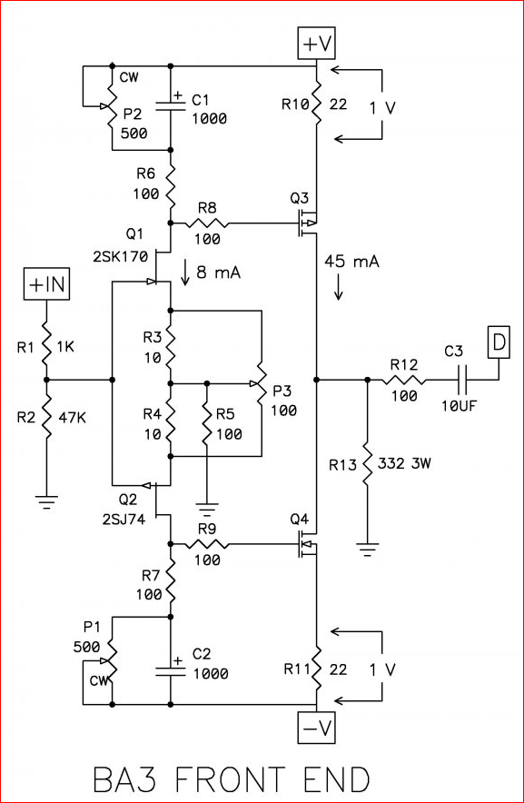

Thanks for the reply Mike,
I see what you mean on the pops, but I don't think we should be connecting cables with the amp or pre powered?
Yeah I see what you mean about the voltage on the drain - could change.
Now i can see why you would want it positioned as such in the BA3.

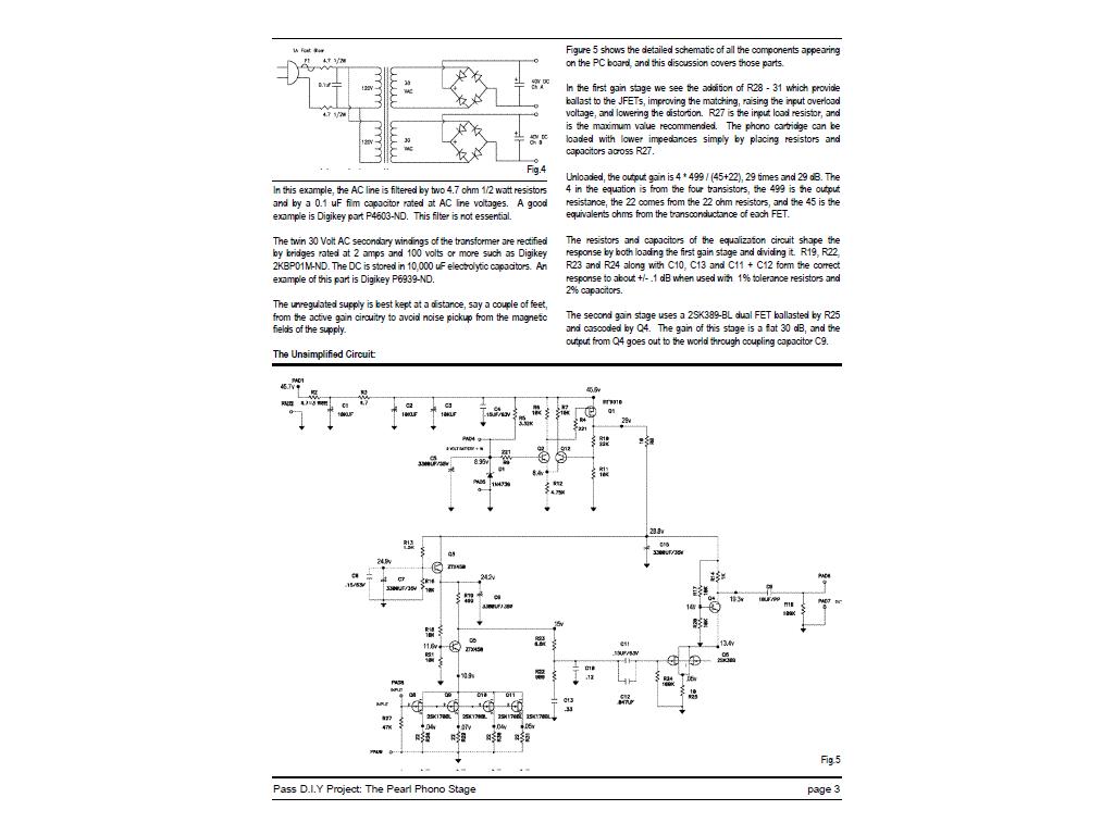

......have a look at " the pearl phono stage ",
paralleled input fet seem to be unmatched.
Actually the Pearl input stage Jfet are matched, although the source resistors help balance things somewhat.
No if you read the construction notes on the Pearl it says to make it easier on you we have boards and matched jfets available at the store here at Pass Diy then the store spells out the boards come with 6 matched jfets for each board.

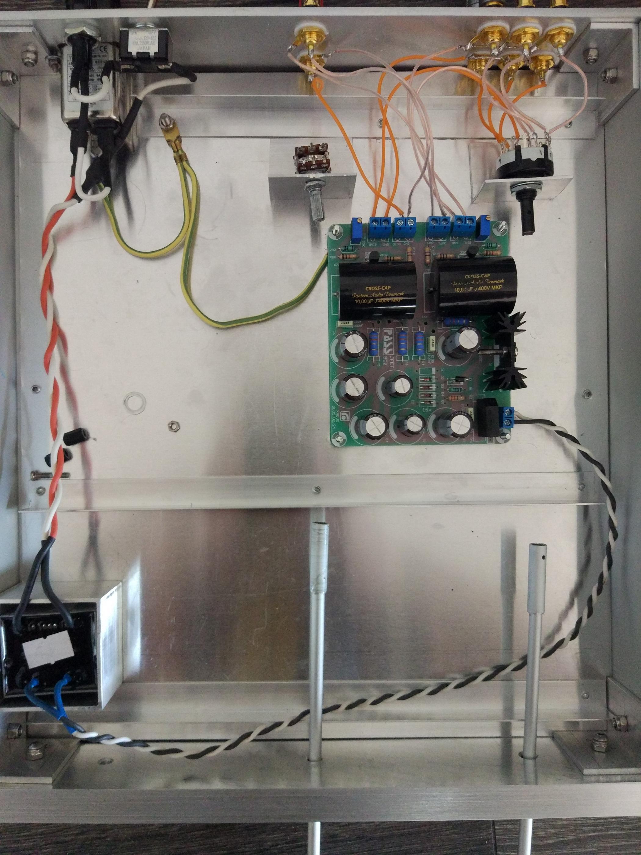

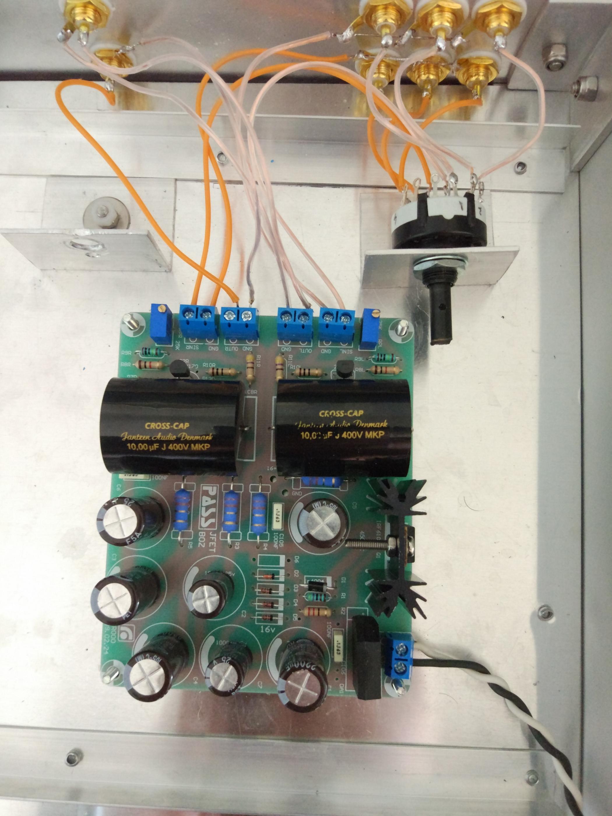

Hi, one newbie question, I'm trying to troubleshoot BOZ preamp that I've built for my ACA amp.
The board is from Jim's audio, I'm using 18V-0,39A transformer and getting about 26V at the BOZ input, using 4 4V zeners. The source is Hifiberry. There is 5k stereo pot at the output.
The case is that I'm getting really terrible distorsion at any volume level.
Where to start, what to check?

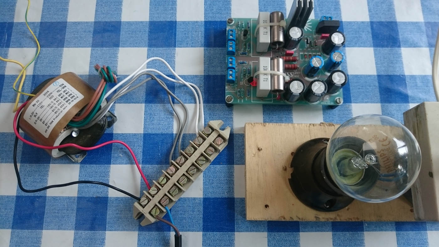

Photos attached below:
@c7m,
the boz paper suggests a 60VA trafo.
i guess thats not the case with your build (as far as i can see)

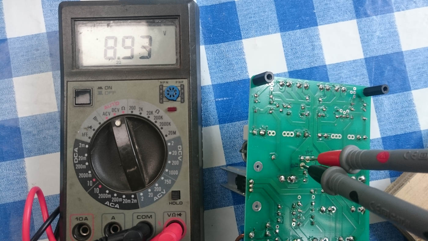

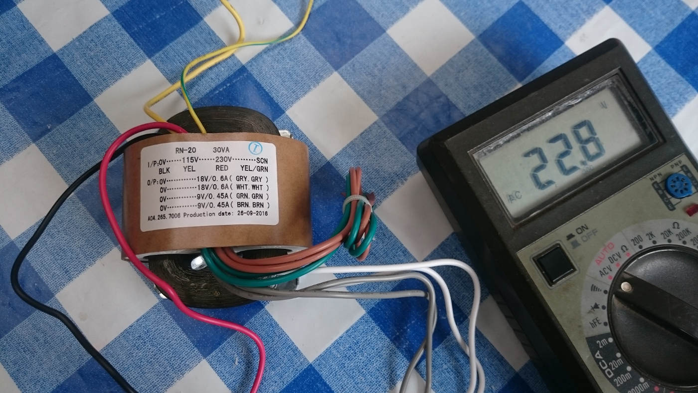

I have ensembled a Jfet boz. My trafo measures a bit higher than 18v but I guess it is ok unloaded. On the board it has measurement points which say 16+ and gnd. It measured 8,92v. Is this a problem and how can I correct it to get it to 16v?
Not tested running audio yet.
- Jfet BOZ
